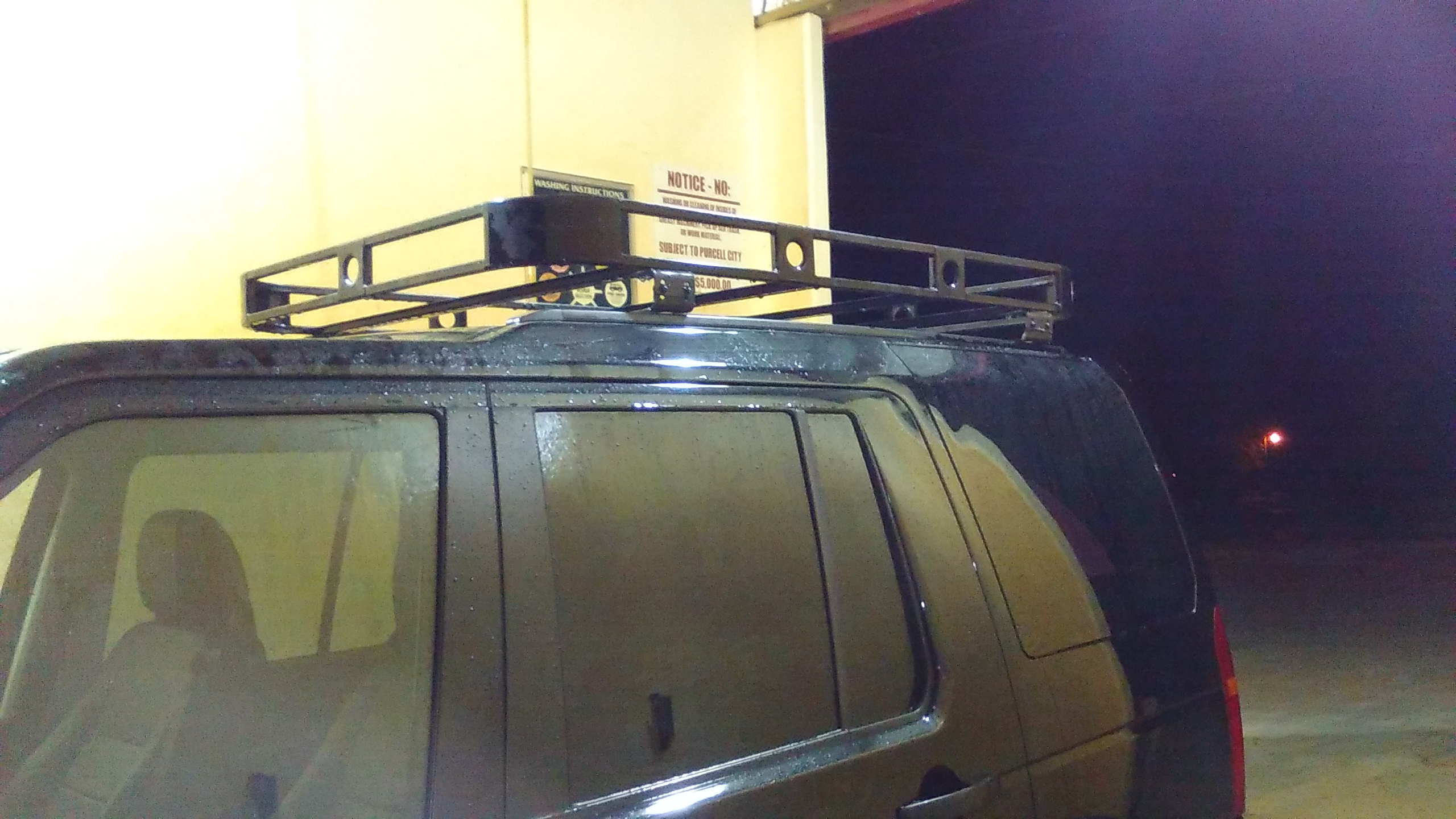

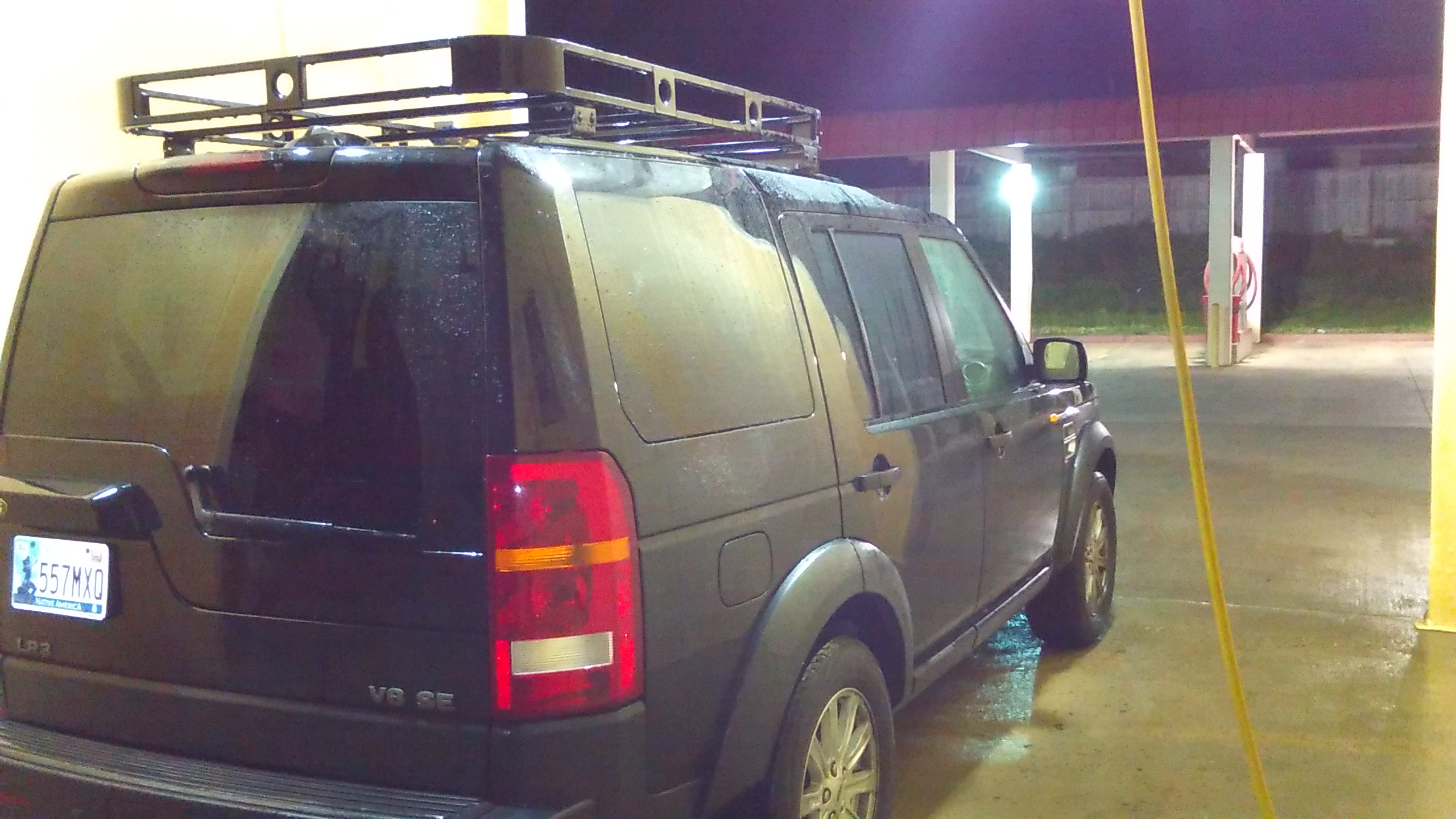

Finally got the rack on! Had to modify, make and weld up some brackets but got er done. Feels good.
Attached Thumbnails What did you do to your LR3 today?-kimg0343.jpg   What did you do to your LR3 today?-kimg0342.jpg
