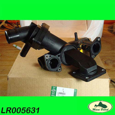

Default count the pulley grooves
I think I would be counting the number of grooves on the new alternator pulley. It is probably right now, but ......
The number will be either five, six or seven, but whatever it is, it best be the same number of grooves as the belt and the other pulleys.
I say that as, much as you, my second alternator lasted maybe a week and then the internal regulator quit.
The third lasted about five minutes as it started to shred the belt. The good news was a new belt, (again), (that took a few hours), and the installation of the pulley, (a few minutes), off the second alternator, plus the time to remove and reinstall.
Fortunately, I have not had any cooling system problems .... yet!
Last oil change, I told the guys they were going to have to actually put some orange stuff in, and not be fooled by the orange staining of the reservoir that makes it look like it is full. One has to look at the side and rock the truck, not just glance at the stained top of the reservoir.
... and I thought Dex Cool was universal - Land Rovers are not easy to own. You are wise to carry Dex Cool as a spare as somehow anything Land Rover speced seems hard to obtain when you need it - (hard to believe all GM uses it).
Given the "universal green", maybe it is time for a cooling system flush and perhaps a new thermostat housing assembly, part number LR005631.
