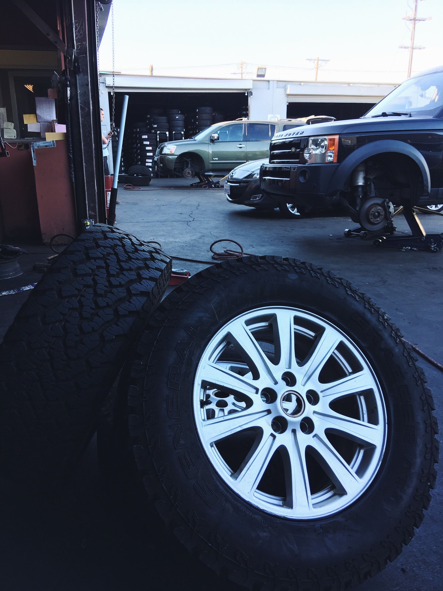

This thread needs more photos IMO...
Finally taking off the stock 19" with crap tires
Bye bye evil ones...
18"s with 285/60/18 General Grabbers
Yes yes yes
YES!

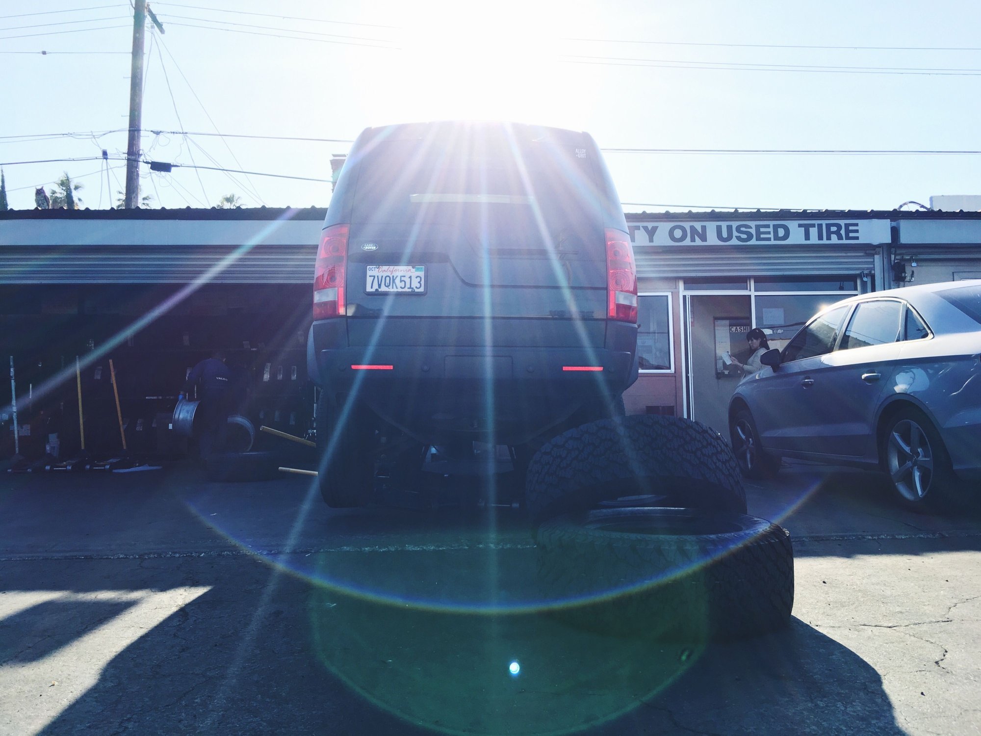

Wow! That's on my list! Already have the 18" 10 spoke. The picture in the garage, is the truck in standard height? Last question. Do you happen to know the diameter of the tires? Are they just under 31.5"
thanks!
thanks!
That last shot was with it in the extended mode.
I believe they are just around 31.5", which shouldn't rub a lot. If you do some search, you can easily find articles and threads about it but they are supposed to rub very very slightly in some cases. One thing to check, though, is a sensor line in the wheel house (just on the drivers side). This page will give you a better idea:
https://lr3tips.wordpress.com/2010/1...ove-this-wire/
I had to do this but regardless, I'm personally looking forward to reflash the EAS to raise it a bit 3/4". Everyone seems to recommend the Johnson rods (and/or other rods) to raise up 2.5" but I'm afraid that might be too tall for the garages I usually park in.
Hope that helps!
