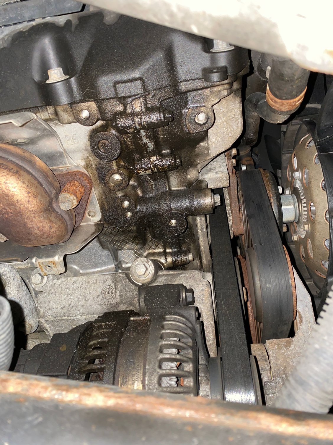

We've just been looking over the most recent LR3 we got and while diagnosing a front suspension leak, found this leak. What are we dealing with?
Taken from the passenger side wheel well. Engine is the 4.4

Looks like a valve cover leak or the cam sensor on top (out of frame) is leaking. The sensor has an east to replace seal around it that hardens and leaks. If its not leaking you may get away with just snugging up the valve cover bolts a little more.

Judging by the quantity of oil that is around the camshaft seal and down the side of the head, I'm inclined to agree that it's the camshaft cover seal that's leaking rather than the sensor seal on top of the cover. It's not a difficult fix, but needs the coils removed.
Be careful with tightening up the bolts, either when trying to 'snug' them up or when refitting the cover with new gaskets, max torque is 9 lb ft (12Nm) or you risk stripping the threads (don't ask me how I know). If you want to try snugging them up you should first slacken them off and then retorque to 9 lb ft (12Nm).
