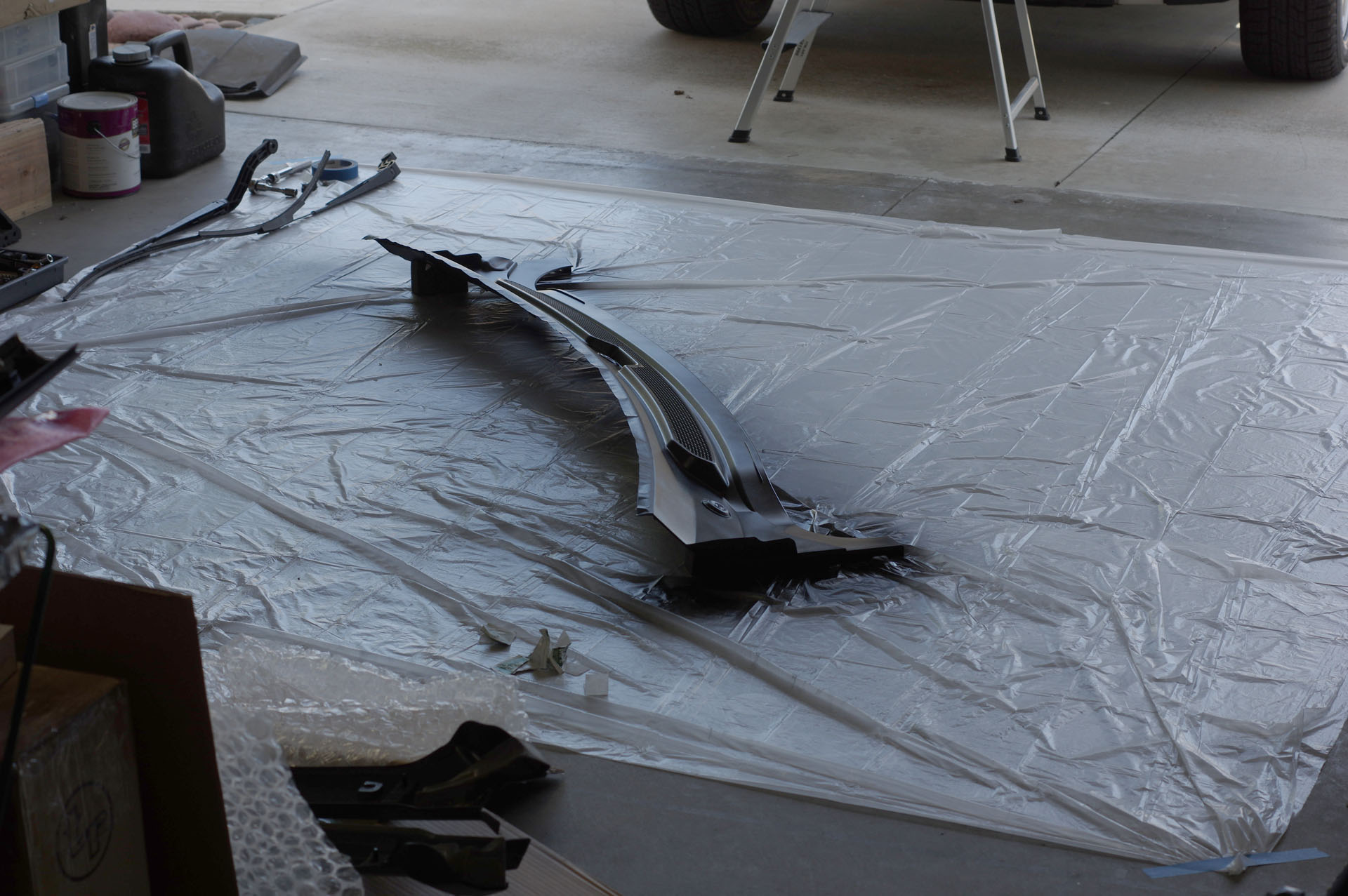

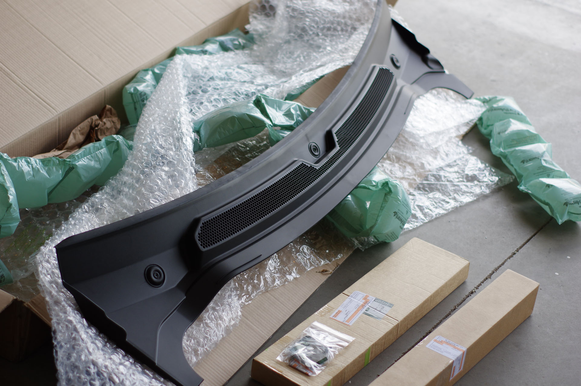

Old Apr 4, 2015 | 04:02 PM
  #39
drew888's Avatar
Joined: Jan 2015
Posts: 26
From: SoCal
I have promised some pics so here ya go. Last pic is the cowl painted and with the rubber strip at the top taped off.
Attached Thumbnails Windshield cowl change-imgp2534-1.jpg   Windshield cowl change-imgp2528.jpg   Windshield cowl change-imgp2530.jpg   Windshield cowl change-imgp2708.jpg   Windshield cowl change-imgp2717.jpg

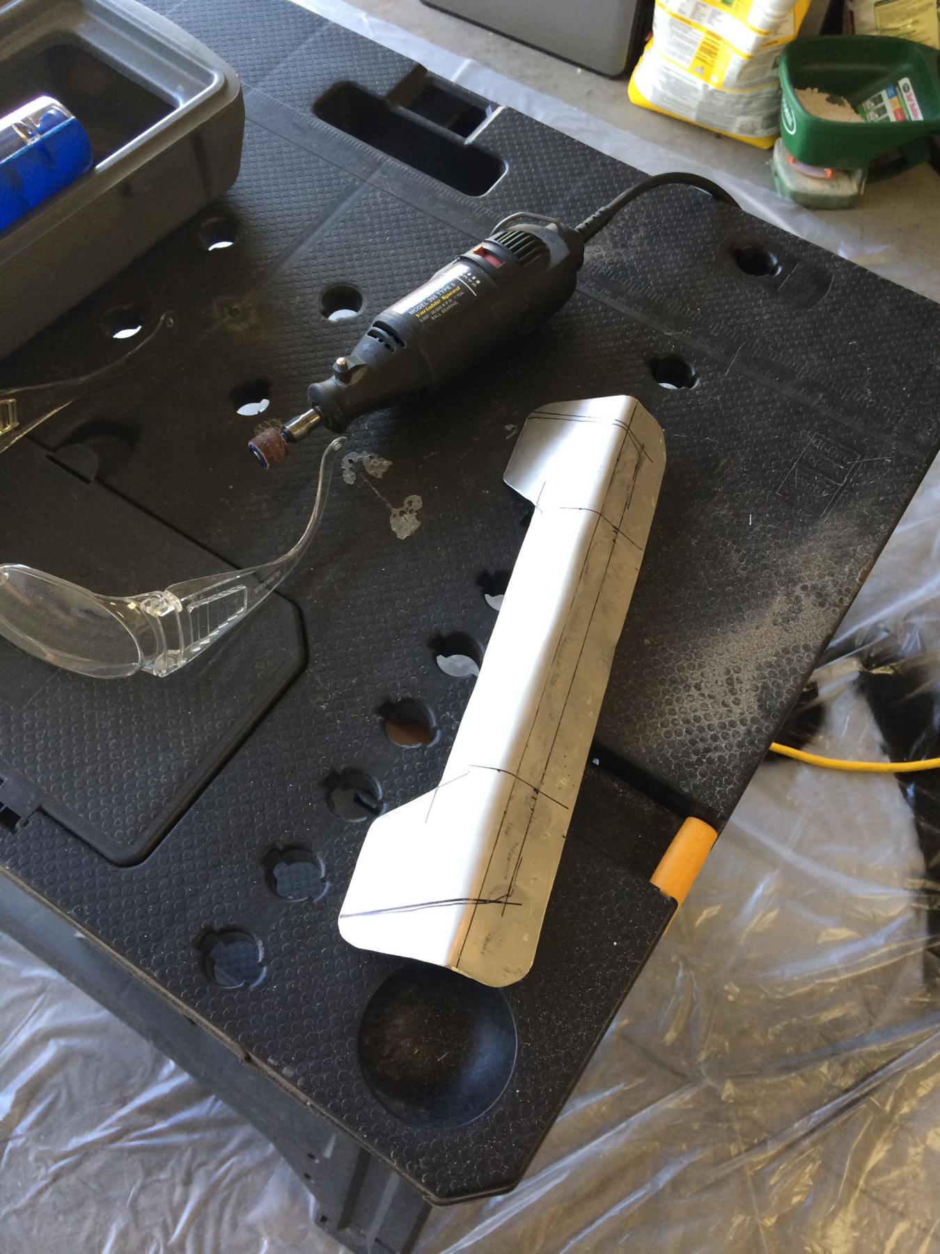

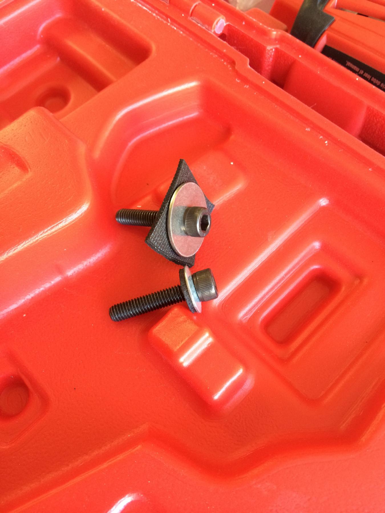

Old Apr 4, 2015 | 04:03 PM
  #40
drew888's Avatar
Joined: Jan 2015
Posts: 26
From: SoCal
My custom deflector using a piece of aluminum I had. The washers I used had a bonded rubber gasket. I chose to use allen head bolts thinking a curved allen wrench would be easier to squeeze through a small opening. It worked out just fine. What you don't see here is a string I tied to the opposite end of the allen wrench just in case I dropped it on top of the air filter. This way I could just easily pull it back up. The pic of the bolts shows a piece of rubber sheet and a larger washer. I decided to go this route because the outer most hole is elongated. I also put locktight on the threads and double nutted it with a lock washer in between. All of that plus the rubber gaskets means it should never come loose on it's own.
Attached Thumbnails Windshield cowl change-imgp2711.jpg   Windshield cowl change-007.jpg   Windshield cowl change-010.jpg   Windshield cowl change-011.jpg   Windshield cowl change-012.jpg
