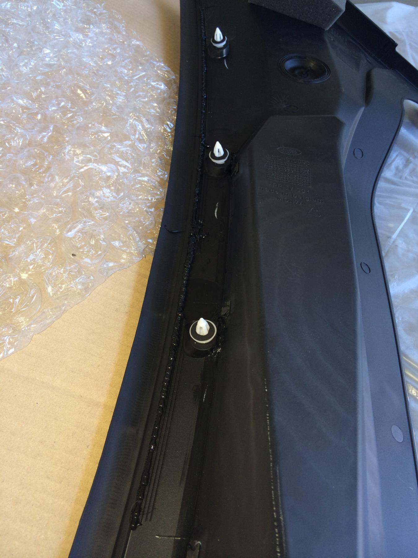

The middle pics shows it lifted by design. I wanted to not slow the flow of air too much and still deflect any water. The last picture is showing that I changed my mind on the 3M adhesive tape and chose to just use the silicone. I put it on then lifted it off to see just where the silicone touched the glass and it was right on the very edge. I would suggest taking a good look at this pic then move the bead of silicone closer to the edge by maybe 1/8" and it should then seal perfectly on the glass.
