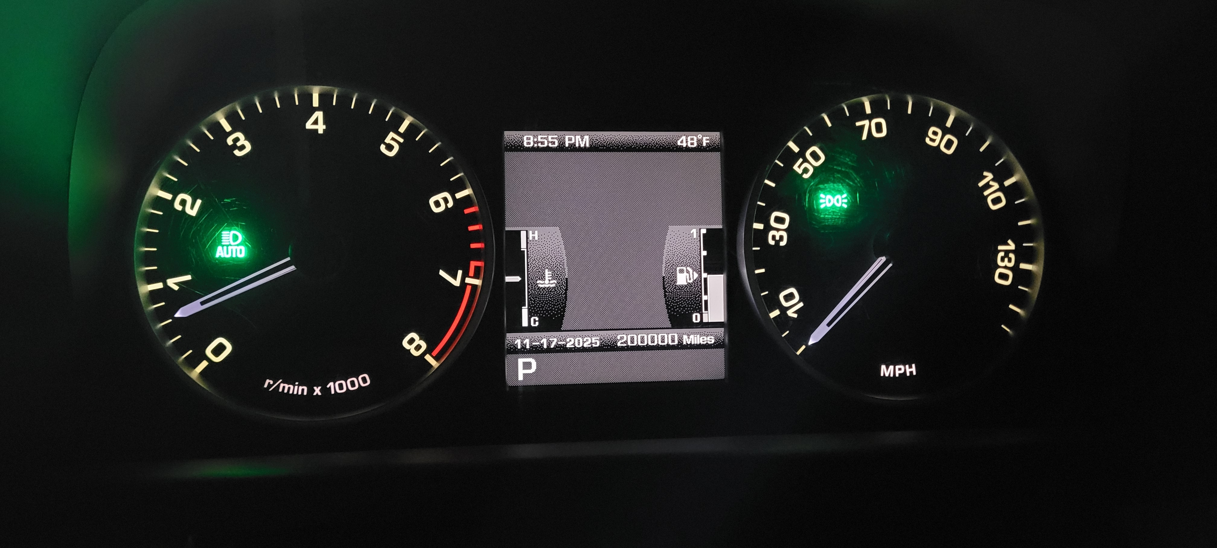

OP here, with a 200,000 mile check-in.
Attached Thumbnails 2011 LR4 5.0 Head Gasket replacement documentation-20251117_205656.jpg
