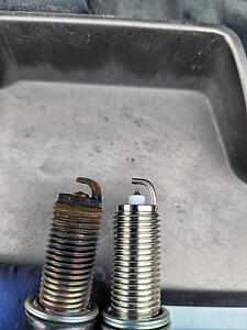

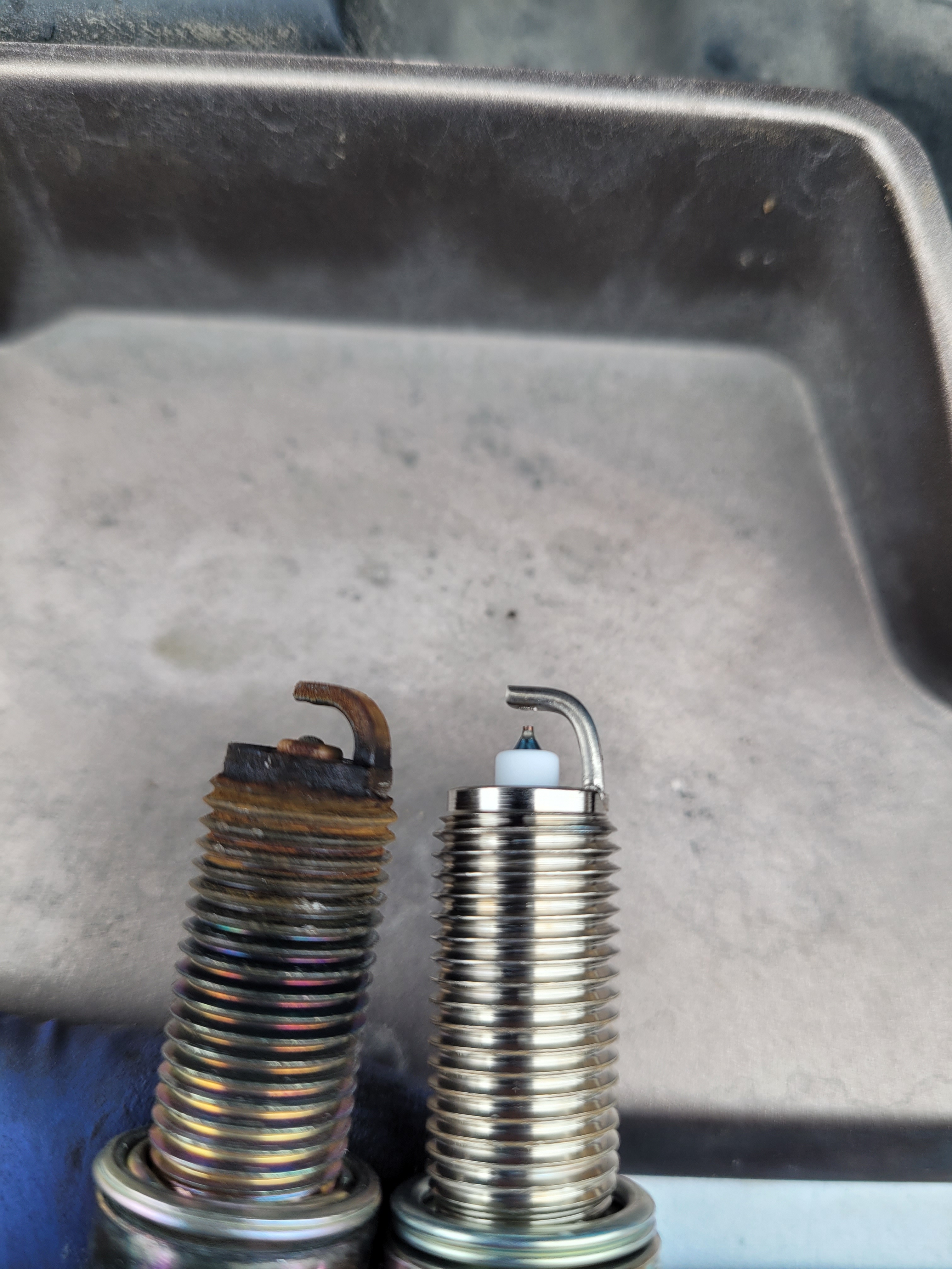

Longevity Update: We have put another 20k+ miles on the LR4 this past year. We are now over 60k out from the headgasket and top end rebuild. It will be rolling over to 183,000 miles this week.
A slight misfire at idle developed in cylinders 3 and 8 a few months ago. It didn't affect drivability, but I could feel that it was not running as smoothly as it should. I swapped coils and plugs from different cylinders, but the misfire stayed on 3 and 8. I should have looked at the plugs more closely, but I didn't notice their wear. When the miss didn't move with the plugs or coils, I thought injectors might be the source. During cylinder 3 injector replacement, i took a closer look at the spark plug and saw a huge gap and electrode wear. It was clearly the worn plugs causing the issue. 8 new plugs and now no misfire.
The NGK iridium plugs installed 60k miles ago were done. See photo. I went with denso this time.
Attached Thumbnails 2011 LR4 5.0 Head Gasket replacement documentation-20241102_112349.jpg
