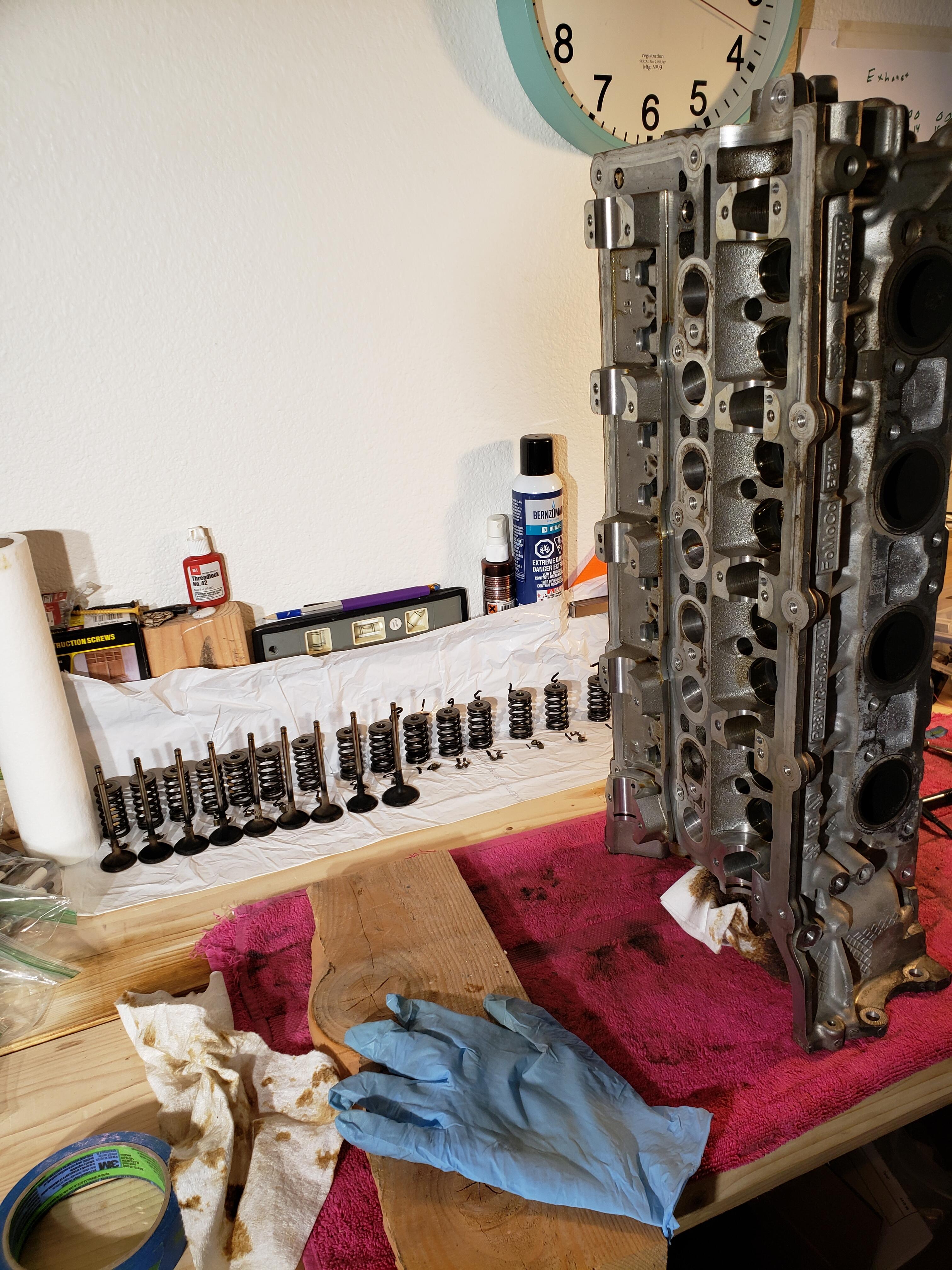

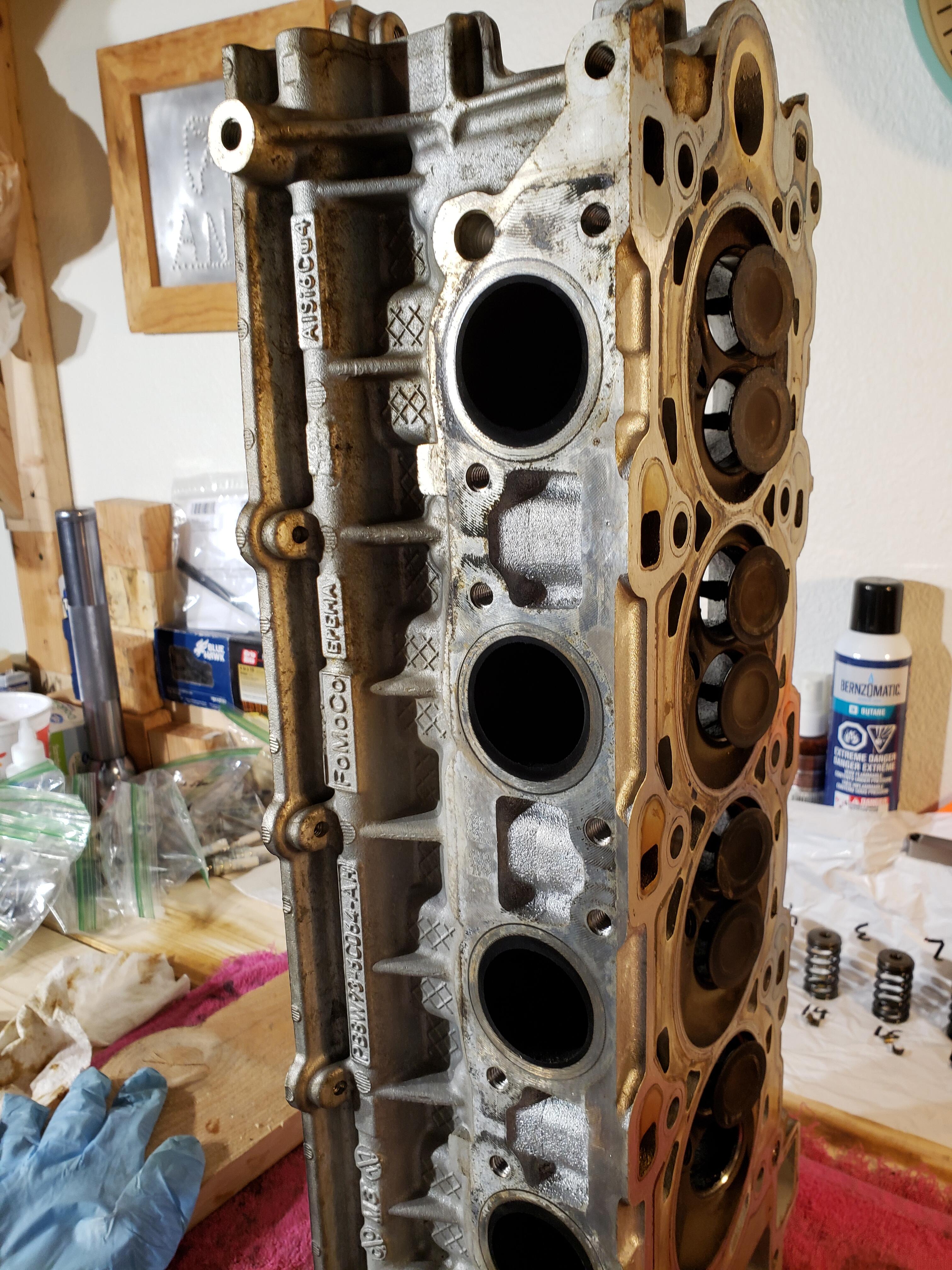

Second head stripped of valvetrain last night. Will go to engine shop for resurface this week, then reassembly begins.

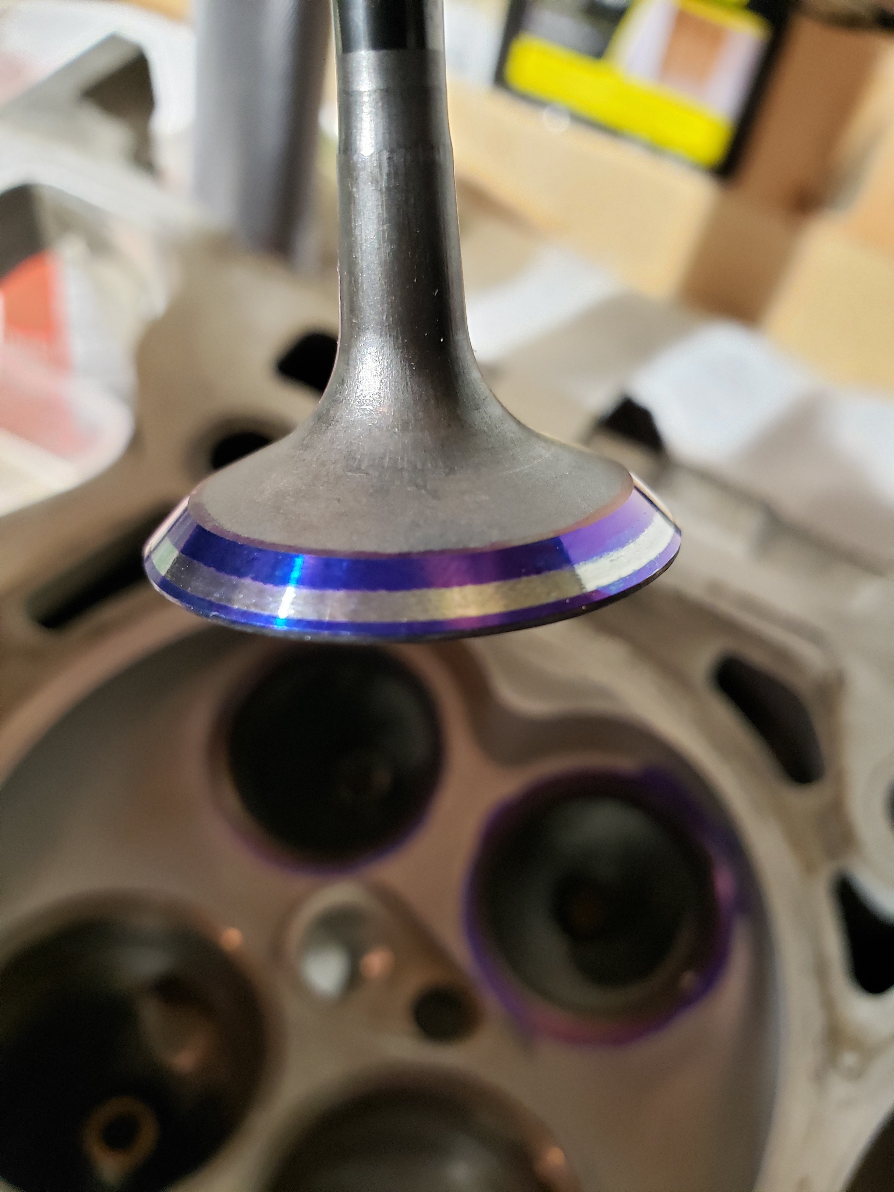

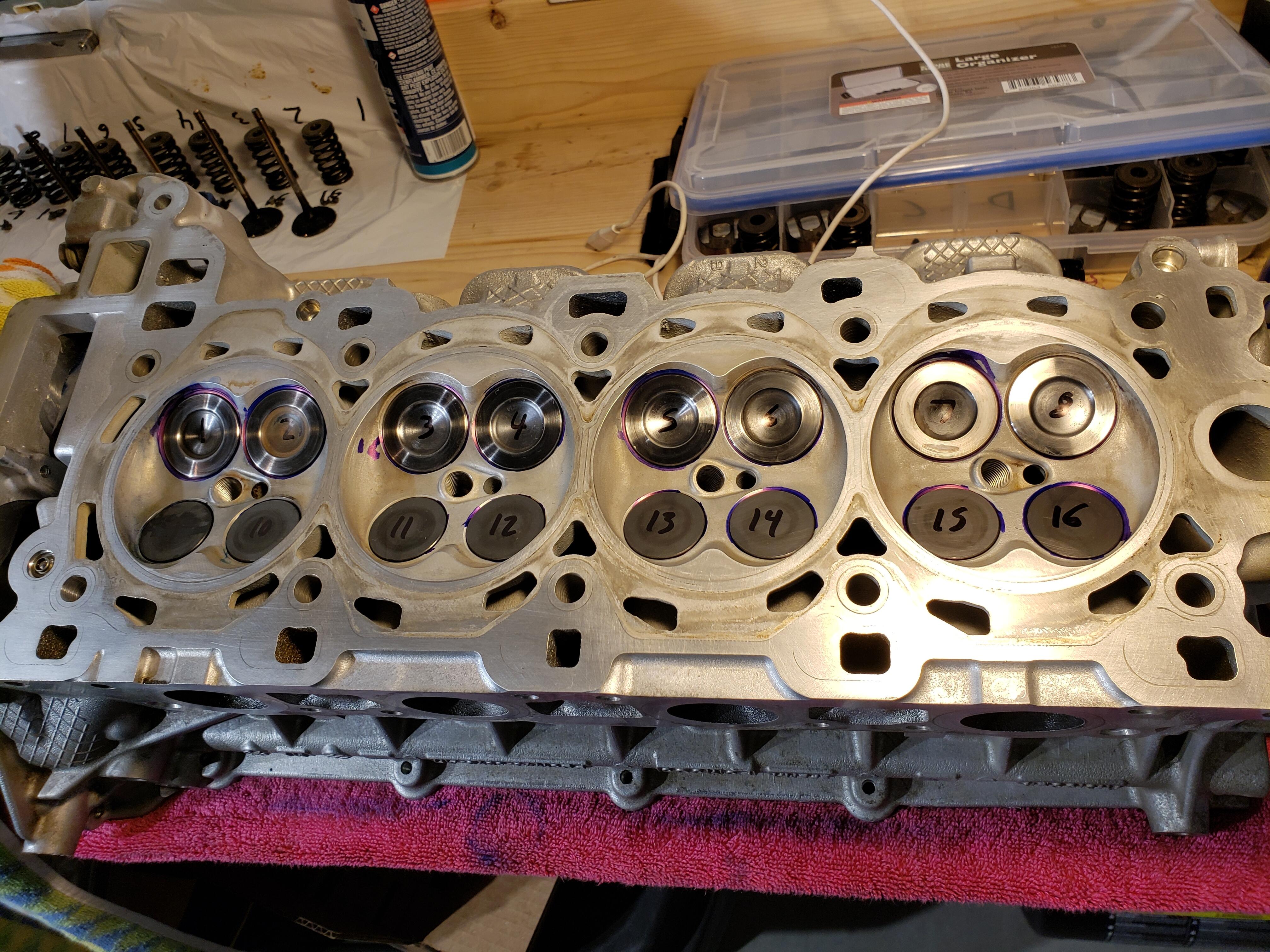

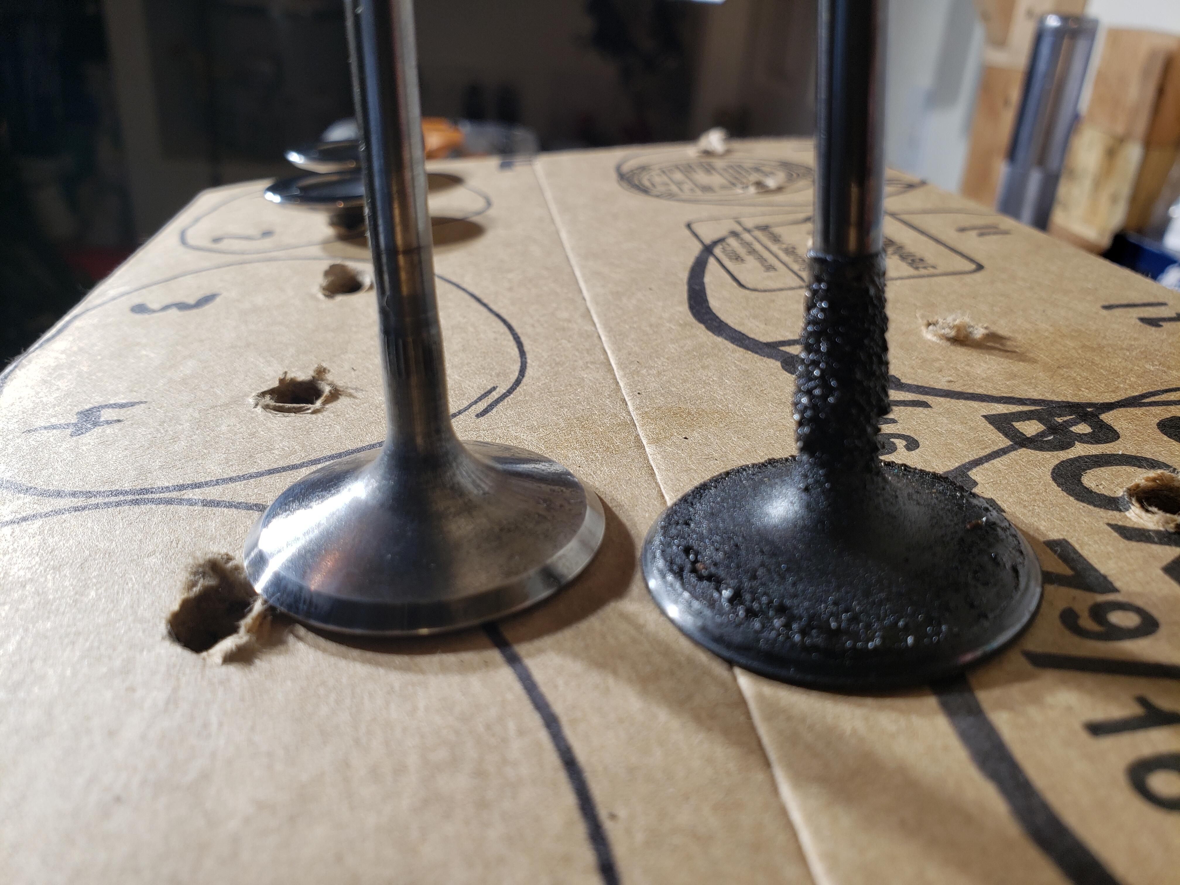

2nd head valve train removed, head washed and new exhaust valves checked for fitment. Lightly "lapped" with sharpie. Seats look fine. Old exhaust valves were just too pitted to put back in.
First thing next week heads will go out for fresh surface.
Final parts shipment coming in monday.
Finally seeing the light at the end. Things are now going back together.
