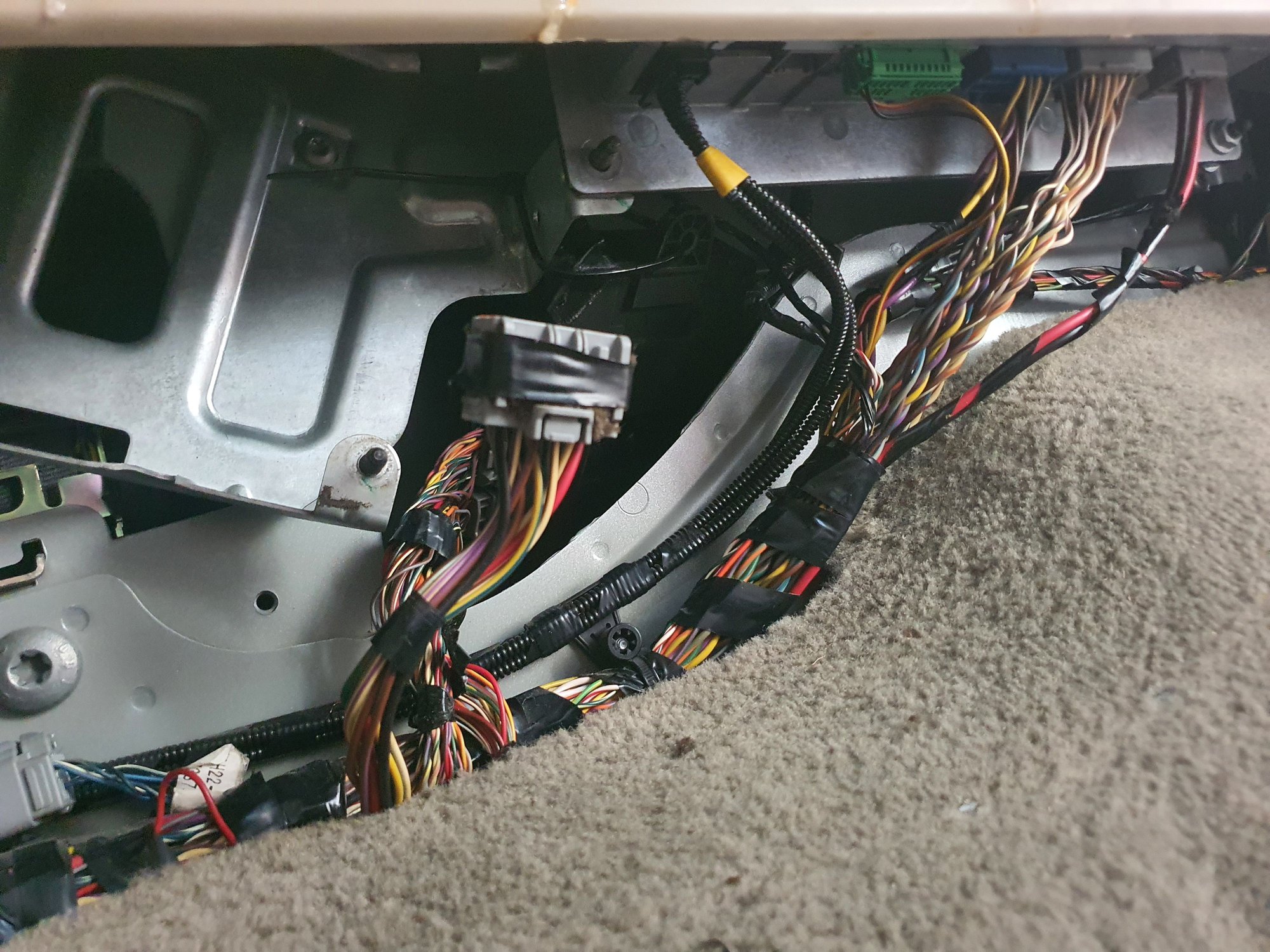

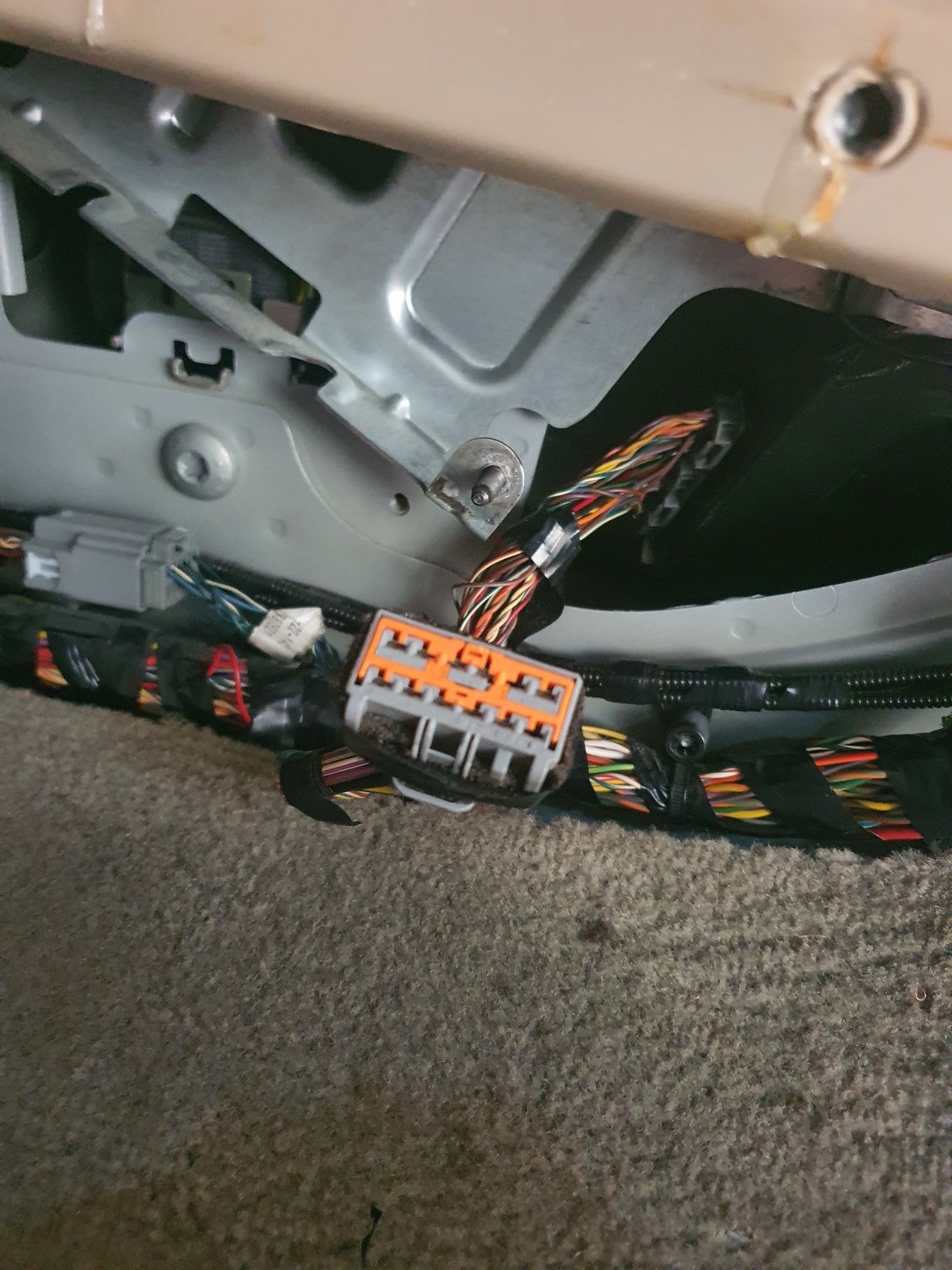

I have just purchased a 2012 LR4, gulf spec. I knew there was a issue with the audio when buying it but wondered if you guys could help me try and fix it.
I believe it's the harmon kardon system.
The audio is really bad and sounds like a lot of music is missing if that makes sense?

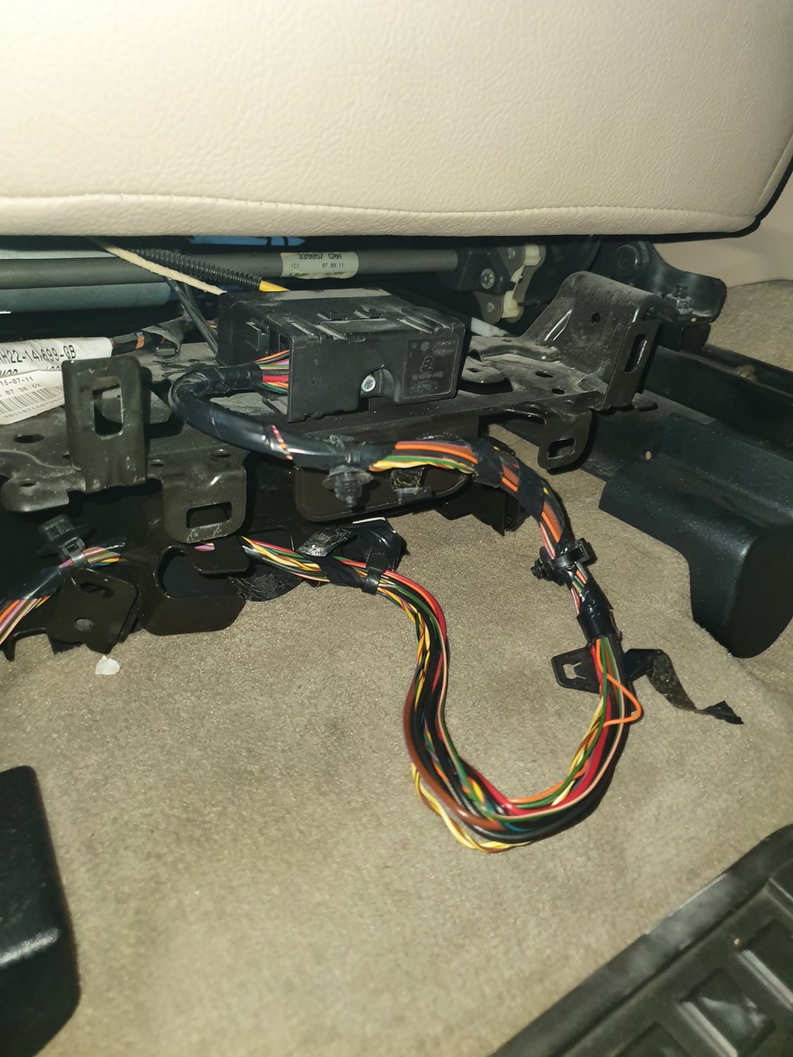

I'm trying to find the amplifier. I looked under the passenger seat but can't find anything.
Pics are from under the seat
Thanks for the help!

I don't know if the LR4 is the same, but the LR3 audio amplifier for the low end audio system is built into the radio (head unit) itself, only the high end audio system (2 types) had the amplifier under the passenger seat. This youtube video shows the removal process.

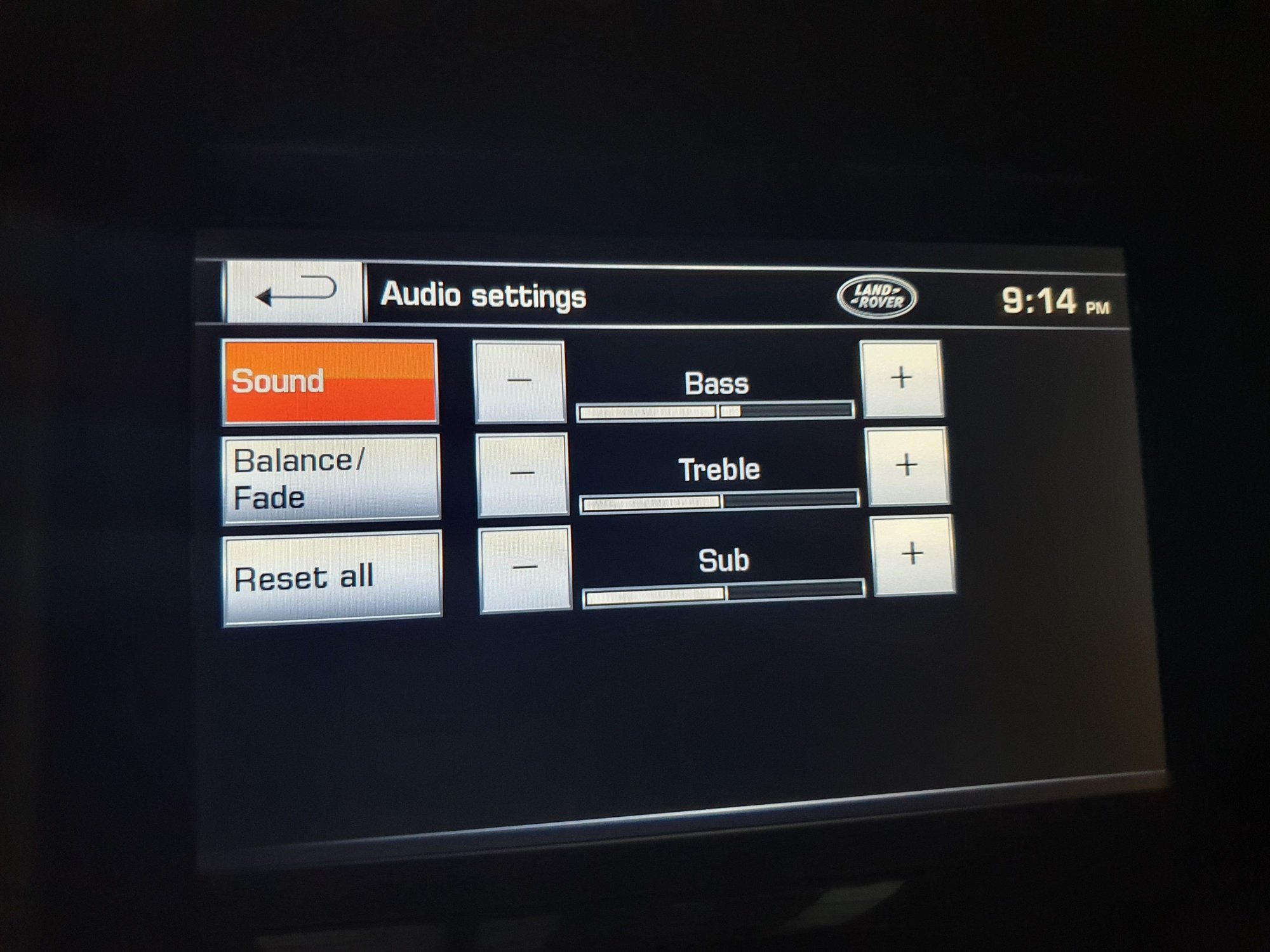

So I found the amp it's in the passenger rear quater panel. I tested another amp and the sound was the same. I have taken some pics and it looks like something else may be missing here

It sort of sounds like there is something wrong with the head unit if you changed the amp and there was no difference. A shop would try to feed in a very low strength test signal into the amp and note what came out, but you likely don't have that type of test equipment available. Good luck, hope you have some success...
