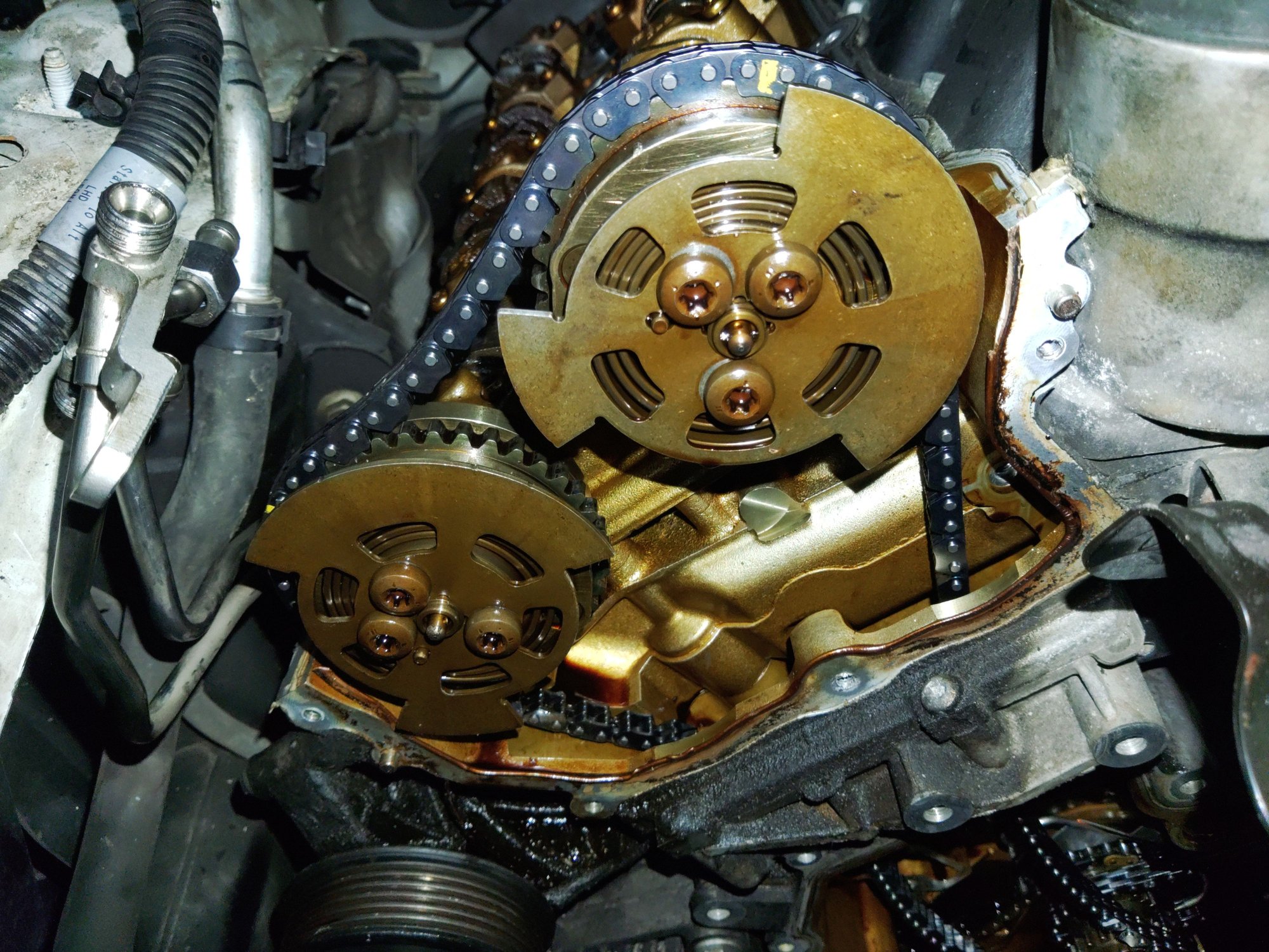

Can anyone tell me what I'm missing here? Installing new timing chains, but the timing mark on the passenger side intake variator doesn't come close to lining up. Engine is locked into safe position, cam locks are in place. If I compare the camshaft bolt position to any other photo/video, the chain and sprocket look correct, but it's almost as if the timing mark on the sprocket is in the wrong place.

Hi Joelo,
Watch this youtube video it shows your issue and a fix for it.
