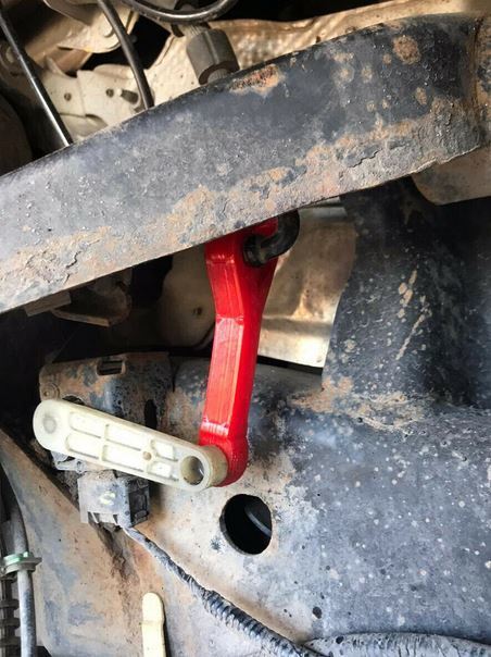

I recommend the lucky 8 SYA kit. It uses spacers and rods to achieve optimal lift and air strut volume
