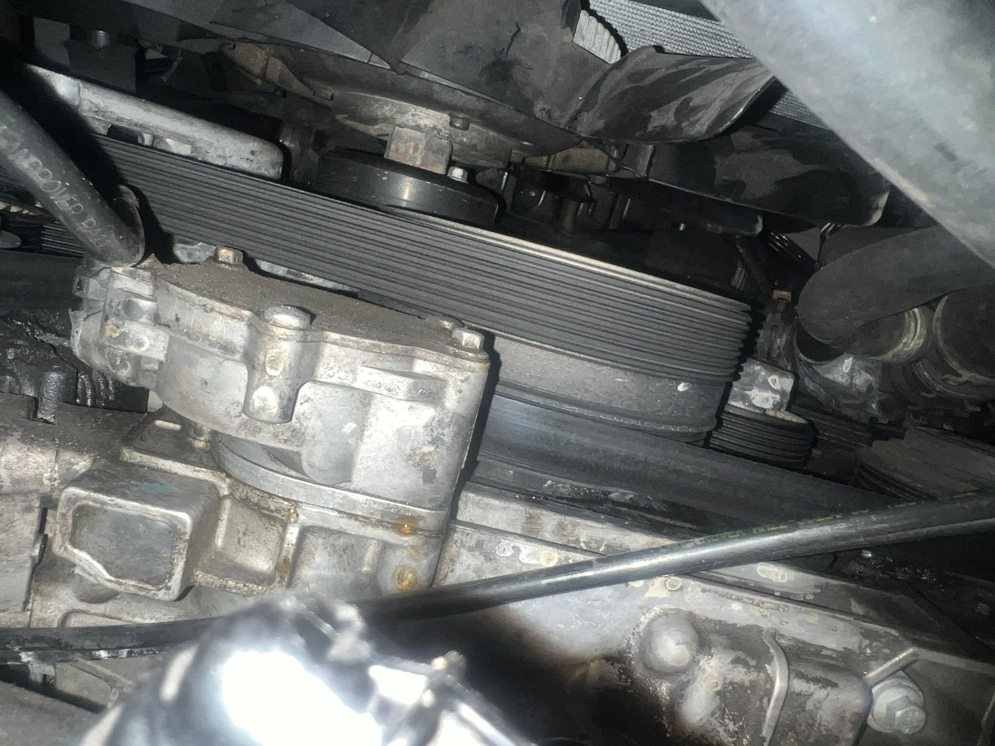

Hi, all
it has been a while since I posted. This morning I noticed leakage underneath my 2016 LR4. I looked underneath and took a couple of photos. The leakage seems minimal, but it is leaking nonetheless. I am attaching a photo of the part that seems to be leaking coolant. I would greatly appreciate anyone’s assistance identifying the part, AND if it is something I can repair myself. As always, thanks in advance for any assistance.

Looks like you are showing the brake vacuum pump. No coolant in there.
Mist likely your water pump/front pipe making its way down.

You are absolutely correct! The vacuum pump in fact is not leaking. I discovered a leak in my upper radiator hose set and there was a small residue of coolant accumulated in an area that “made its way” down the vacuum pump.
Thank you
