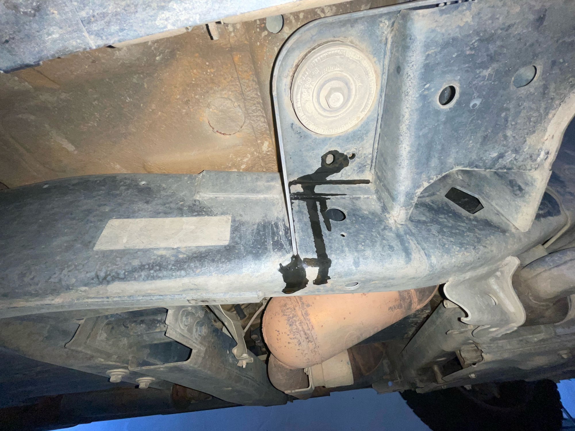

Hi all,
This is my first post
I was changing my brake pads today (front) on my 2010 V8, when complete, I started up the car to pump the brakes, all went fine until I had a new leak under the drivers (RIGHT) hand footwell. It is 100% engine oil, and I'm wondering what could leak in this area or close to it, I cannot identify the source from above or below:

You say drivers, the master cylinder is there. When depressing the piston calipers it probably pushed brake fluid through the cap.
my guess, brake fluid not engine oil.
