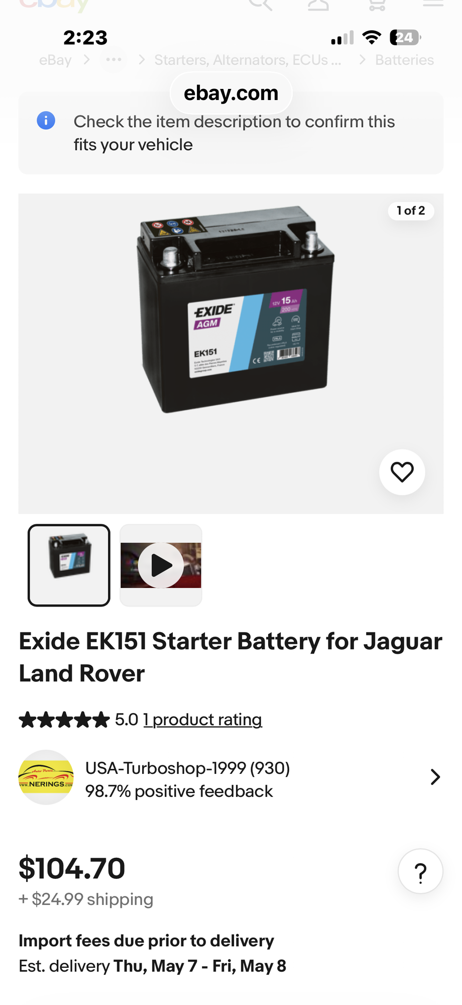

Hello - I am trying to buy a new auxiliary (stop/start) battery for My 2016 LR4/Discovery 4 SCV6 but cannot find one for delivery to a US address. Ideally the battery I want, which seems to be the best fit in terms of quality and price is the Exide EK151. Can anyone tell me how I can get this or a similar battery in the US without paying the very high price asked by dealerships etc?

Looks like you can nab one on eBay.

Ebay/Amazon both have it, but not at that exact price. There are also others on Amazon at differing prices. I purchased a similar one last year. It is doing great. S/S working quite well with it.

Thanks for the replies. While the prices of the auxiliary batteries vary a lot, does anyone know the customs/duty charge where a battery is sent to the US from overseas? If you bought a battery from overseas, at what point were you asked to pay the duty fee? Was it when the battery was delivered?
