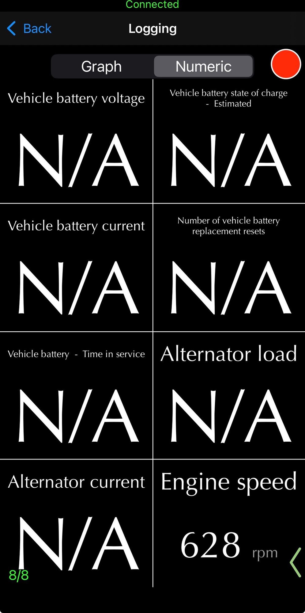

I've plugged in my IIDTool and can see the battery voltage on the dash. I've seen it hit 12.0 while driving, so I wanted to try and log values to see what is causing what. I can see the voltage in the iPhone app as well. However, when I try to see the live values for the battery, it just reports N/A. Other values are present like engine speed and fuel pressure values. I'm wondering if the low voltage may be causing the fuel pressures to get low. I ended up doing a screen record of the home page of the app to see when it happens. It reliably gets to 12.0 as I am slowing down and subsequently backing in to my driveway. I also noted it one time while I was driving home cruising at about 45-50ish and 1800 rpm.
Has anyone had any issues getting the battery voltage in live values?

Exactly! so that’s why I’m trying to get some data about the battery. However, nothing regarding the battery is available. My live values screen should have “Batman” at the bottom because it just shows a bunch of NAs for the values, lol. Alternator current, battery voltage, % charge, etc are all NA engine running or not. It’s like something is not communicating but I don’t have any errors other than a TPMS initiator shorted to ground.

I can now get the voltage, but it’s in the top corner of the app. I can also see it under the BCM called analog 11 or something like that. I’m guessing that’s just raw voltage on the bus, not something the battery management system is reporting.

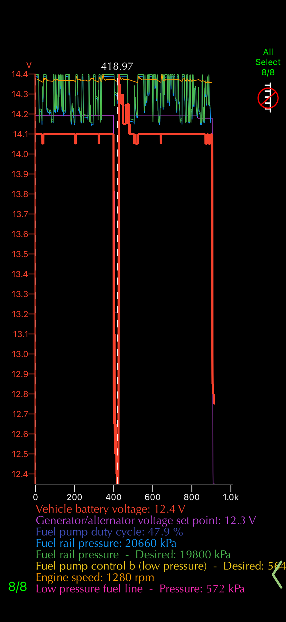

it looks like your supposition was correct. I ended up finding out after doing the old school battery and charging tests that I probably don’t have a bad battery. I had it tested at the autozone and tested it with my load tester at work. I also found that LR moved the battery voltage from the BCM to the Gateway Module. I am now able to log battery and alternator functions. When the voltage drops to 12.4, the target is also 12.3, so it is being told to do that.

Thank you for this suggestion. I was able to confirm that everything looks ok. I am curious if the little Aux battery can be removed without any issue. It tested well also and was a higher voltage than the main battery.
