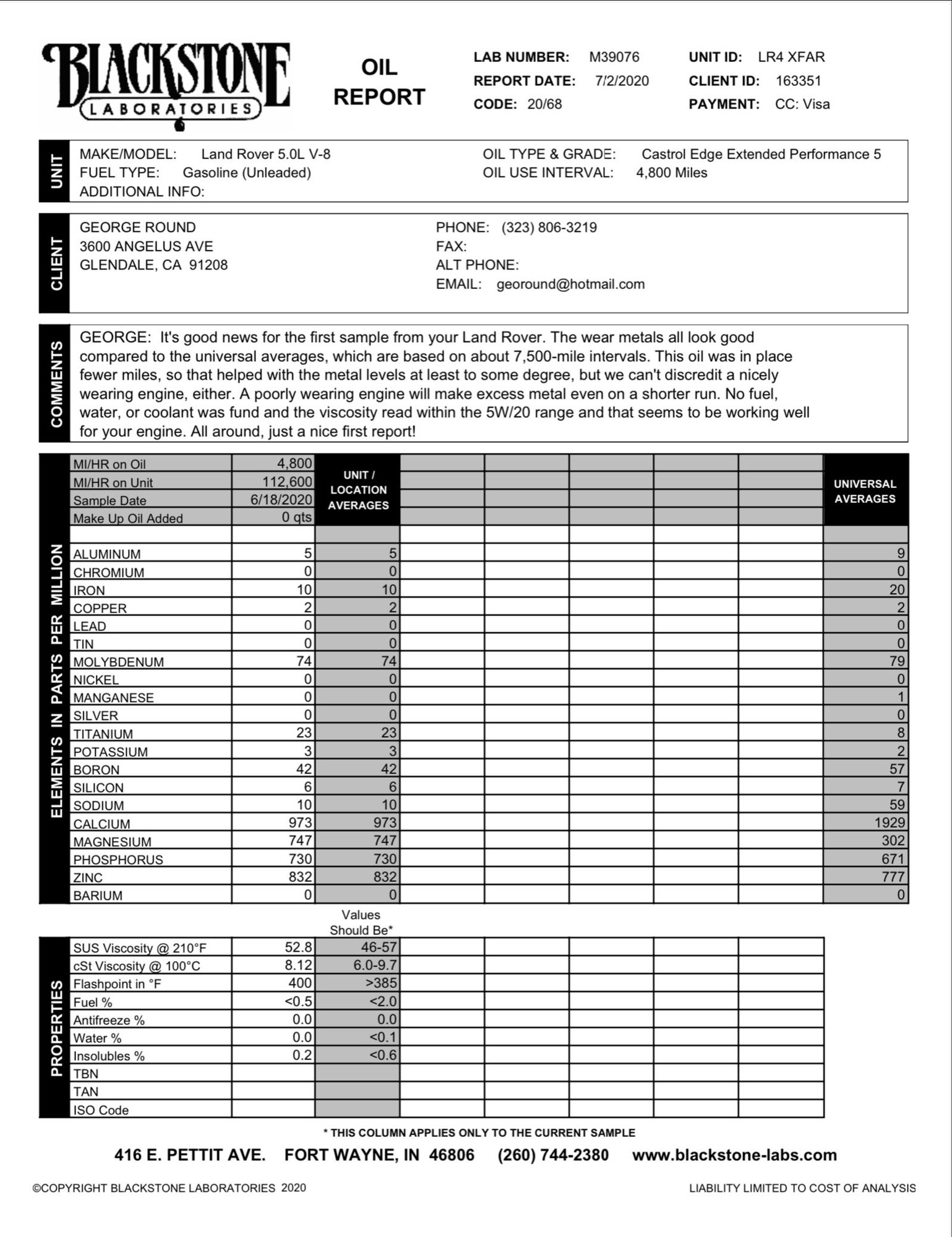

I like to see the science! Has anyone with 2010-2012 had an oil analysis that they could share? Either before or just before failure.
I had a Blackstone Laboratories analysis ($30) done as a baseline at my last oil change at 112k miles (2013 LR4).
I will extend the interval as they test the viscosity and my numbers were very good. Seems like there was lots of life left in the oil with low metal numbers (Castol Edge Extended Performance 0w20).
I was especially curious about the Aluminum numbers. I would expect my 2013 has the updated chain guides, but wonder if anyone with worn guides would see a high Al number.
My engine is a bit noisy but seems to be fuel pump tappet and injector sounds.
When the oil is about 10k miles old, I plan to send a sample in. I will hold off changing the oil until I see a result.

If you wouldn’t mind, post up the results. Would be interesting to see how they compare to mine. I’m going to send mine in for a second one at 10k miles (on the oil). Should be next month or so.
