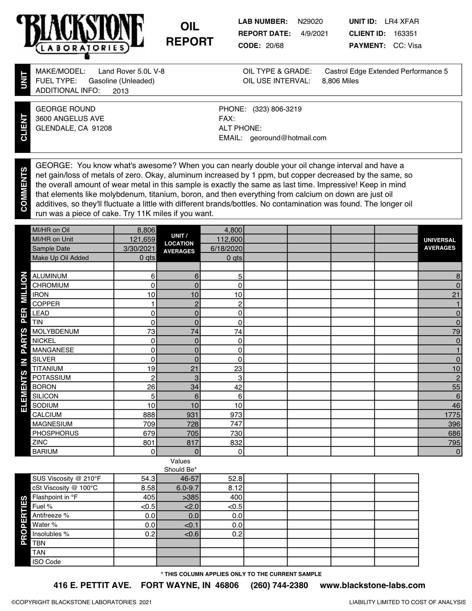

Just thought I’d share the analysis from my last oil change. Most recent numbers on the left. About 8,800 miles on the oil.
2013 5.0L LR4 at 121,000 miles.
Metals seem to be steady, no sign of unburnt fuel or coolant and oil seems to be in good shape. Plan to change my oil at 12k and retest. I appreciated the bit of good humor in the comments from the tech.
