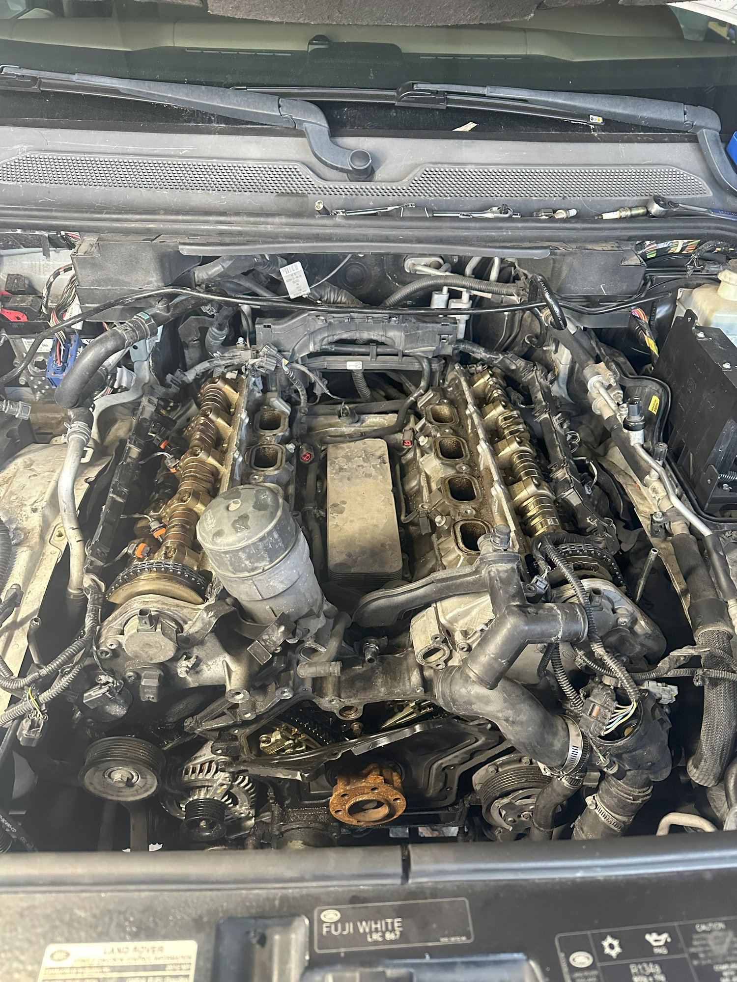

I recently purchased a project 2012 LR4 HSE LUX. I picked it up for $1200 and trailered it home. The previous owner said he was driving it home and it died. He was able to get it started again and limp home. He took it to a local mechanic and was told it just needs a new engine. After he attempted some repairs/diagnosis he gave up and that's where my adventure has begun.
When I picked it up the valve cover was in the back of the LR4 and the cams had a little bit of rust on them. I tore the motor down to the block and built it back up, New head gaskets and new bolts, new cross over pipes front and rear, new injectors, new plugs. I did the timing chains and guides. After a few months she came back to life and started! It fires right up every time and sounds great when running. I checked compression across all cylinders and all within 8 psi. After going through all this I am still getting some codes for misfires.

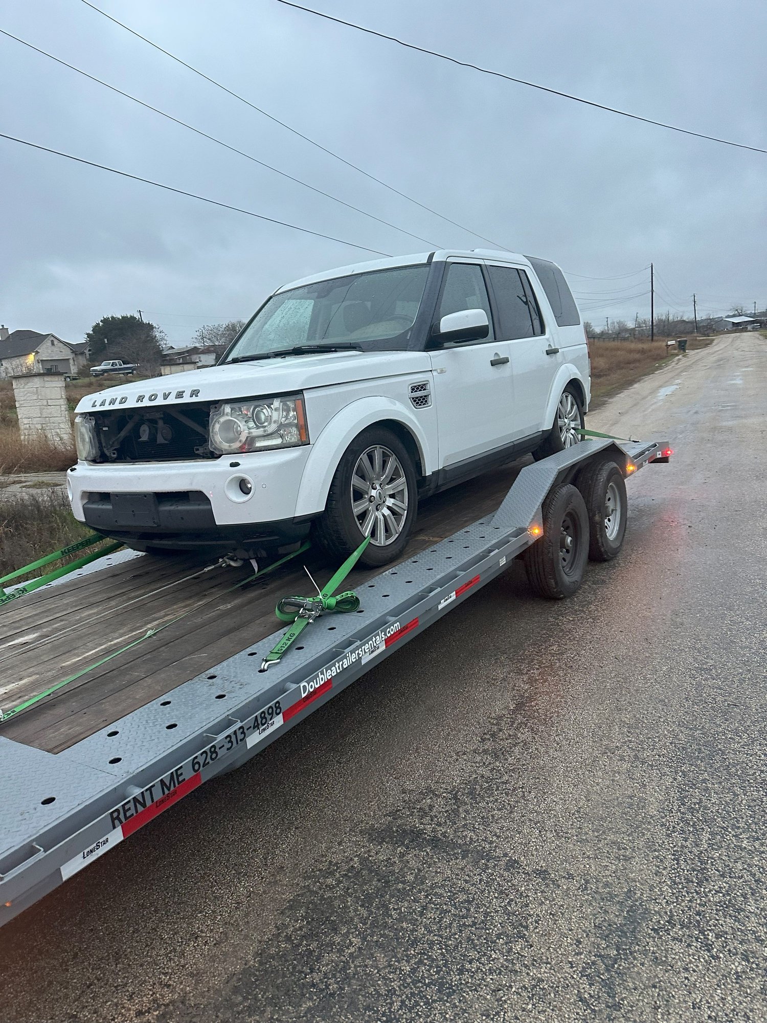

The day I picked her up

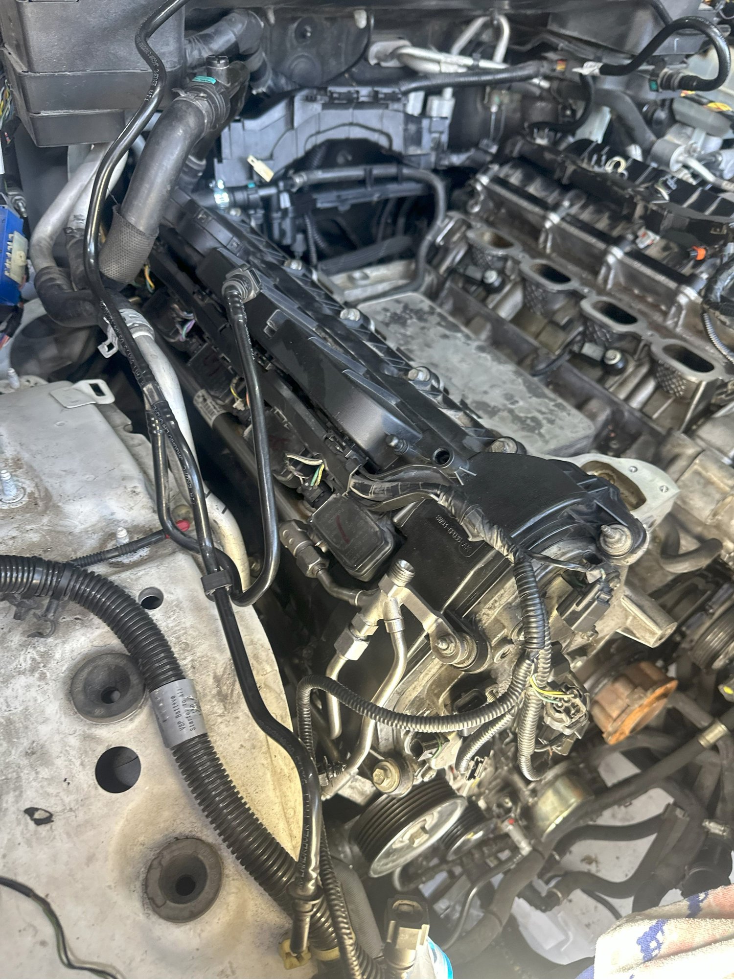

The beginning of the tear down. The previous owner bent the timing cover to look inside vs taking the crank pulley off

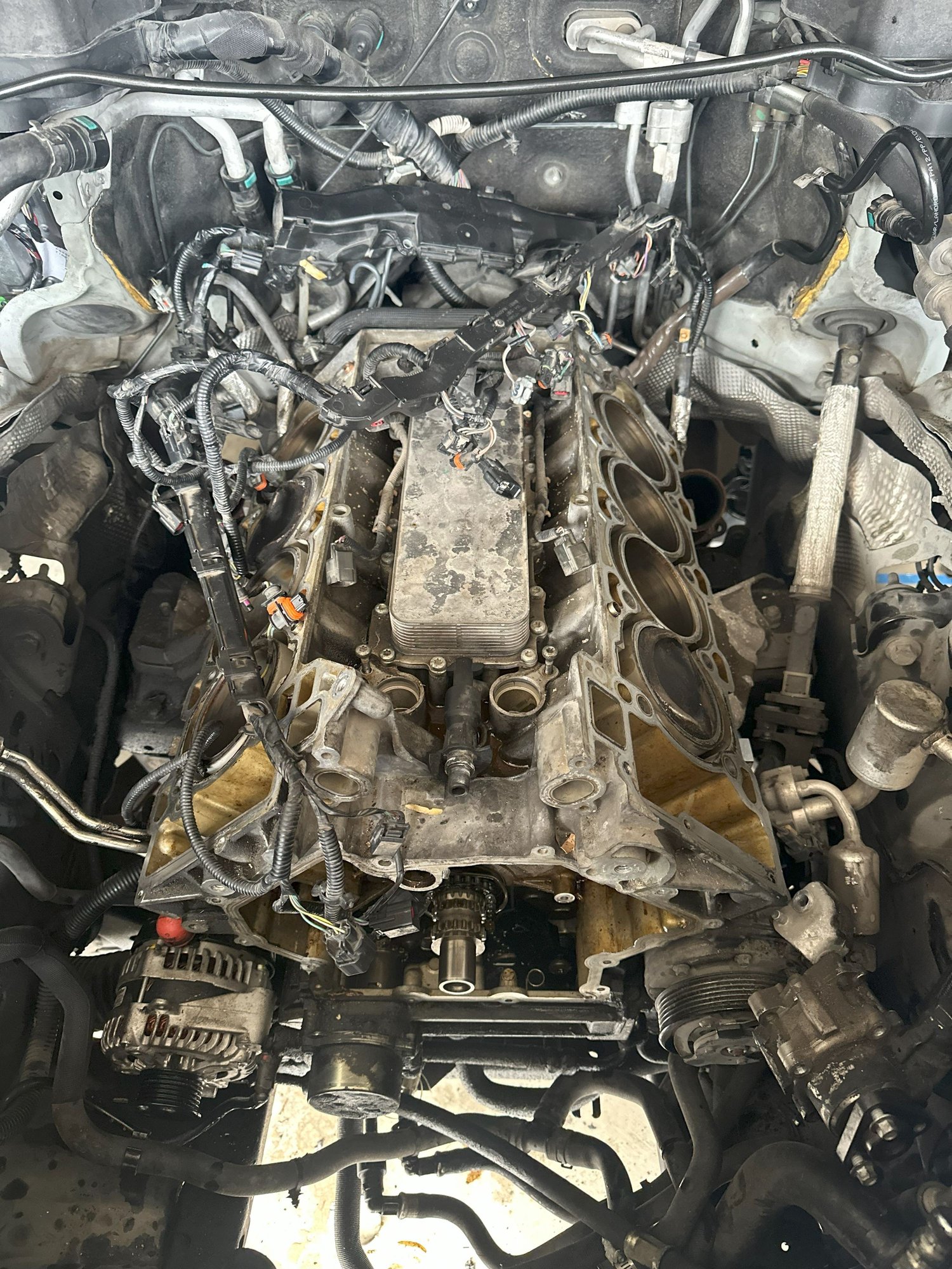

New Head gaskets are about to go on

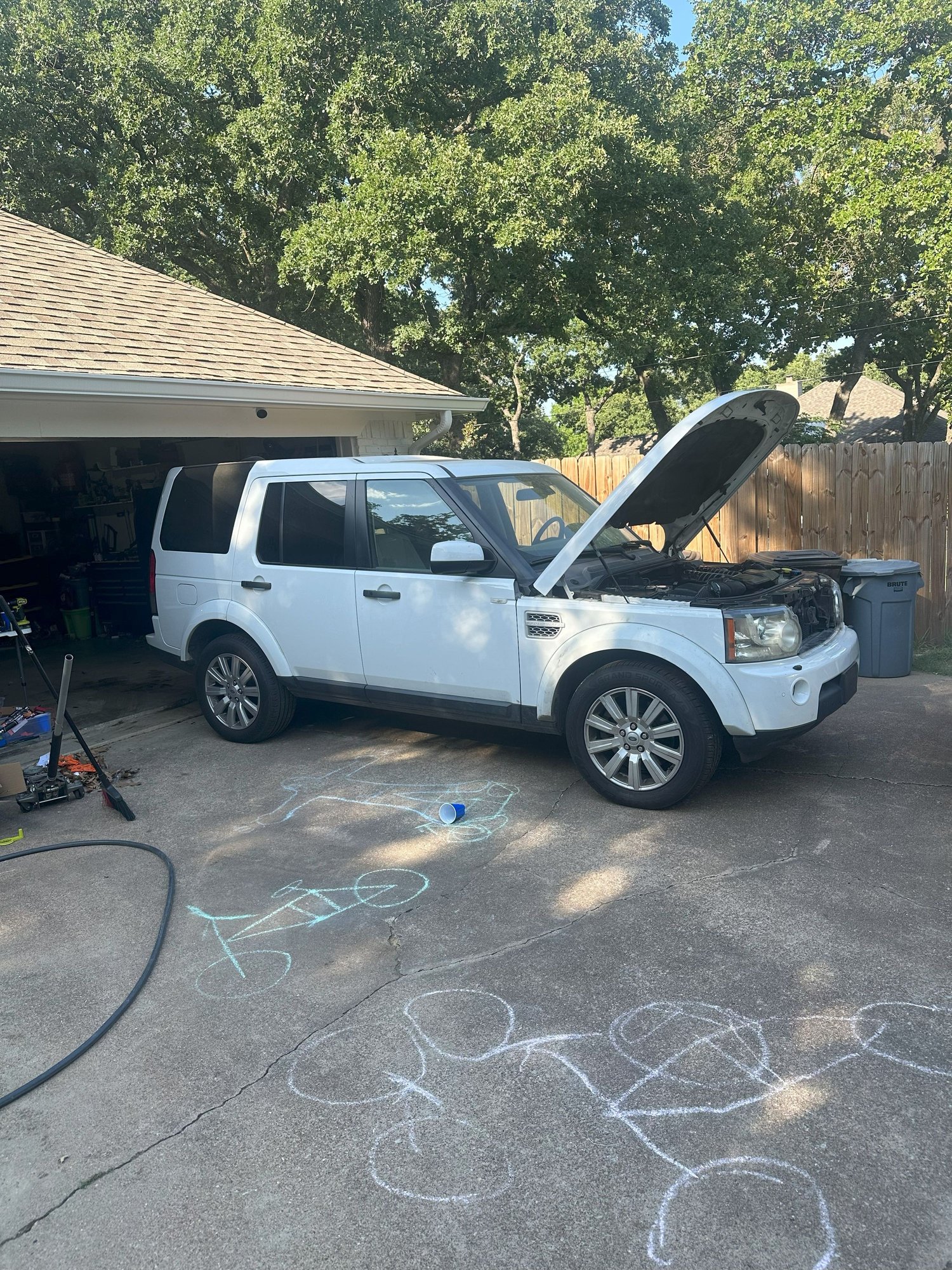

First drive out of the garage
