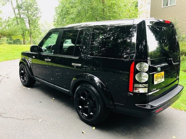

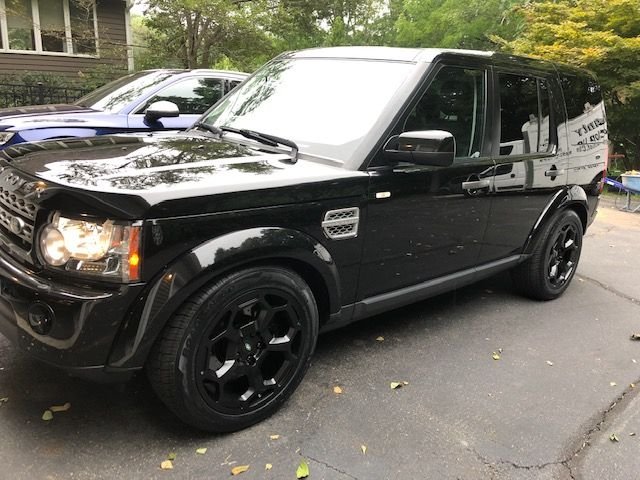

Here is the LR4 back to full strength with new wheels...
