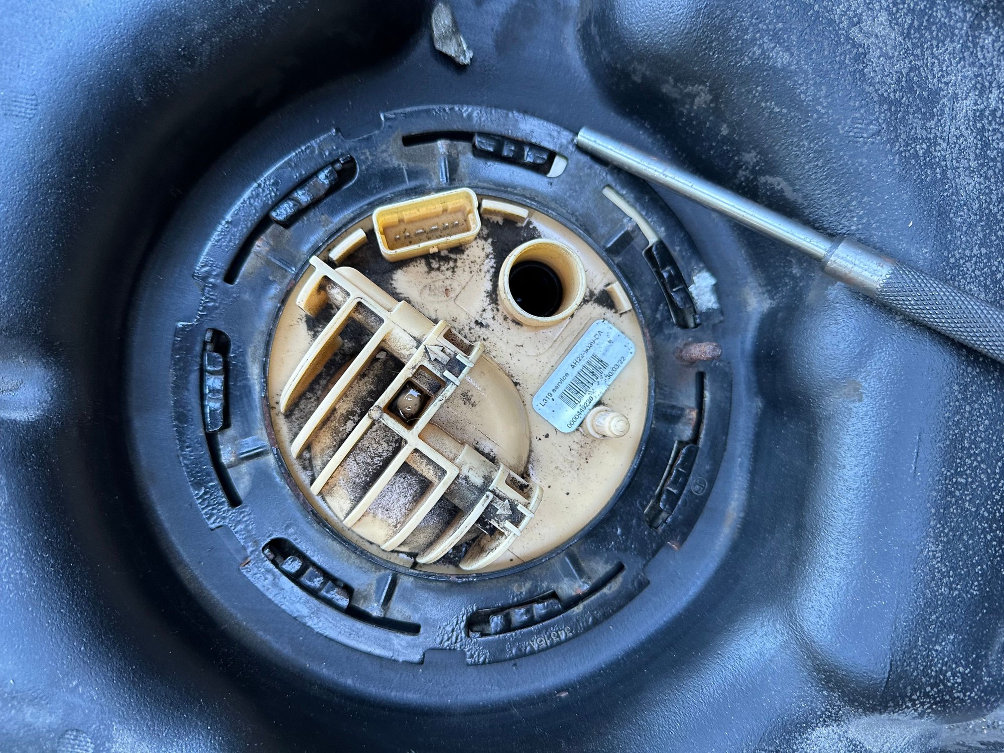

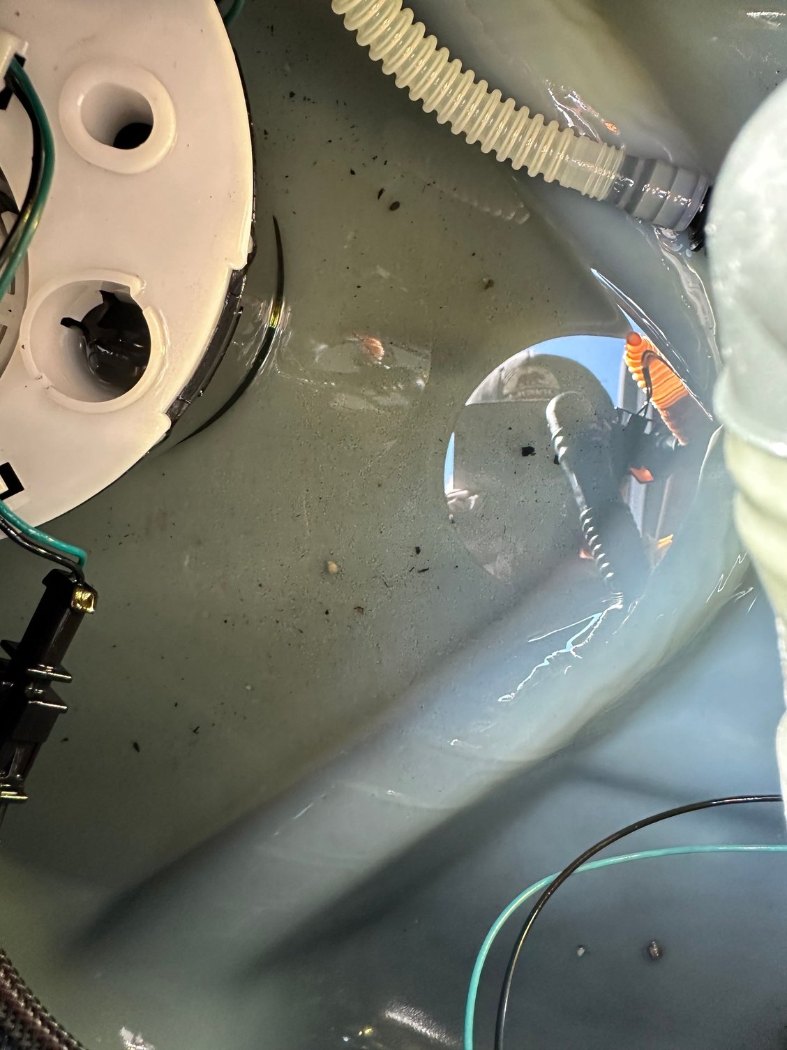

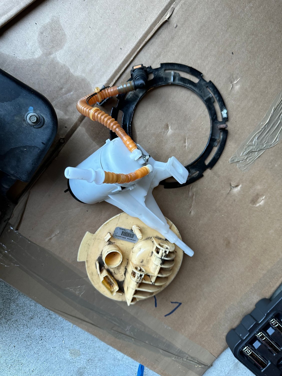

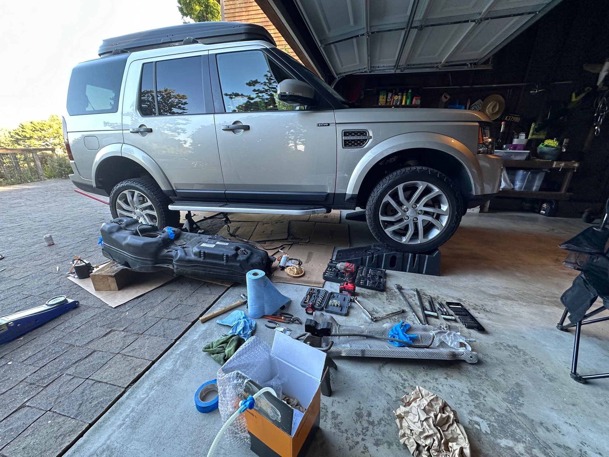

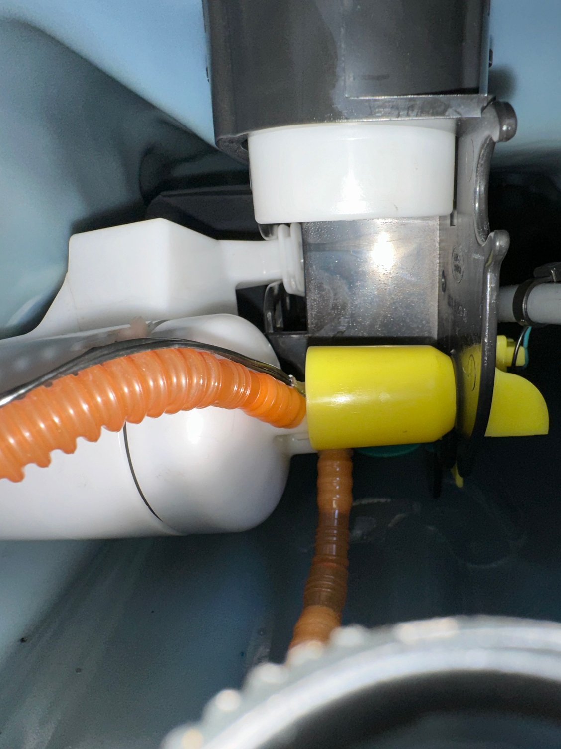

Dropped the tank and replaced the pump. Problem solved. Took 5-6hrs but would have taken 1-2hrs with a lift and proper documentation. Most of the time was figuring out how to unclip connectors and how to re-orient the pump and fuel filter in the tank. Zero info on this and its tricky because you are reaching you hand into a dark tank of gas to do it blindly Also my 2016 LR4 fuel filter looks nothing like the workshop manual or pics ive seen. its not located on the fuel flange itself. its its own part attached to the top of the tank. you need to remove it to get the pump out but took me like an hour messing with it to figure out how to get it back in.

I reused the fuel filter. And I dont even know what the fuel filter SKU is. It's not like the ones you see in the pictures thats attached to the fuel flange. that may have been what the recall changed. the fuel flange is now just a plastic cap with ports for the fuel, vent and electrical connections. the filter is a separate canister attached to the inside top of the tank.

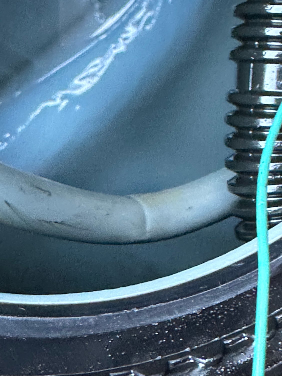

I did see some grit (like small pebbles) in the tank and spent some time cleaning that out. but the mesh pre filter was clean and no residue or goop in the tank. I did however see the hose from the pump to the filter was kinked. I was wondering if that may have been enough to cause a slight under pressure situation. I unkinked it but didnt replace.
