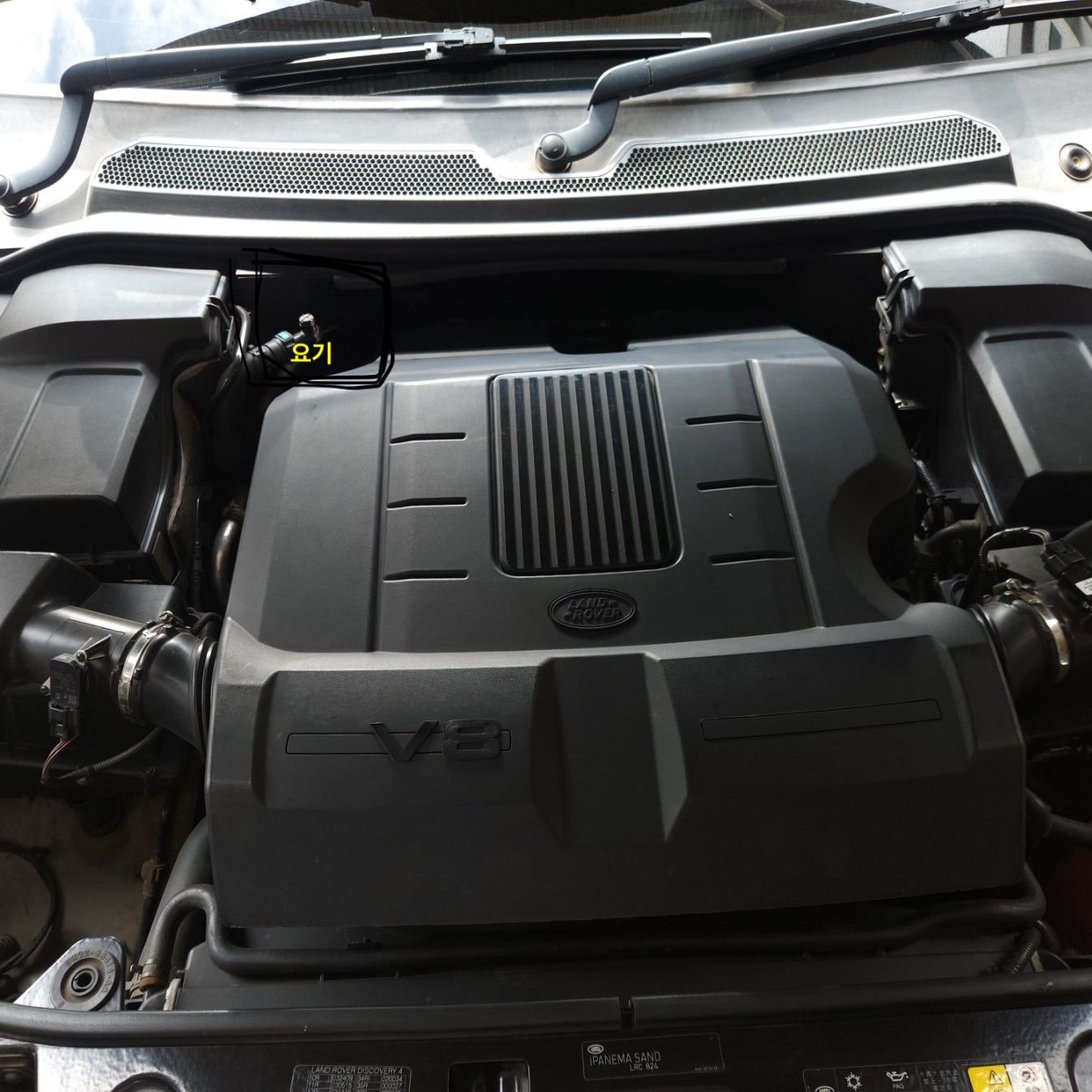

Hello I have 2012 LR4 V8 5.0
Recently I noticed that there is leakage of coolant from place highlighted in yellow. Can I buy them ? If so do anyone know part no please?
Thank you.

Chances are, when you go to remove it, it will break off in the pipe. Then you’ll try to dig it out and mess up the threads on the pipe.
Genuine Land Rover Heater Pipe
P/N: LR031393 Genuine Land Rover

You can order them. Here is the part number that I found. LR031393SP LR031393SP. I couldn't find anyplace local to me that had it.
I had a hard time finding them locally but there is a BMW bleeder screw that is the same size and was able to find it at AutoZone for $4.99.
Dorman Coolant Air Bleeder Screw 902-404
They are super brittle so be gentle removing it.

@bluetembo Get some silicone o-ring grease and grease the o-ring as well. It helps over time.
