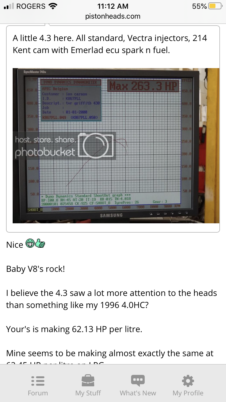

Anyone Dyno there trucks stock or with any mods? These above are at the crank of built rover v8s. I’m getting a motor built at the moment and am getting excited about the new power.
just curious about those who have built these motors and what you’ve found? Good or bad.
