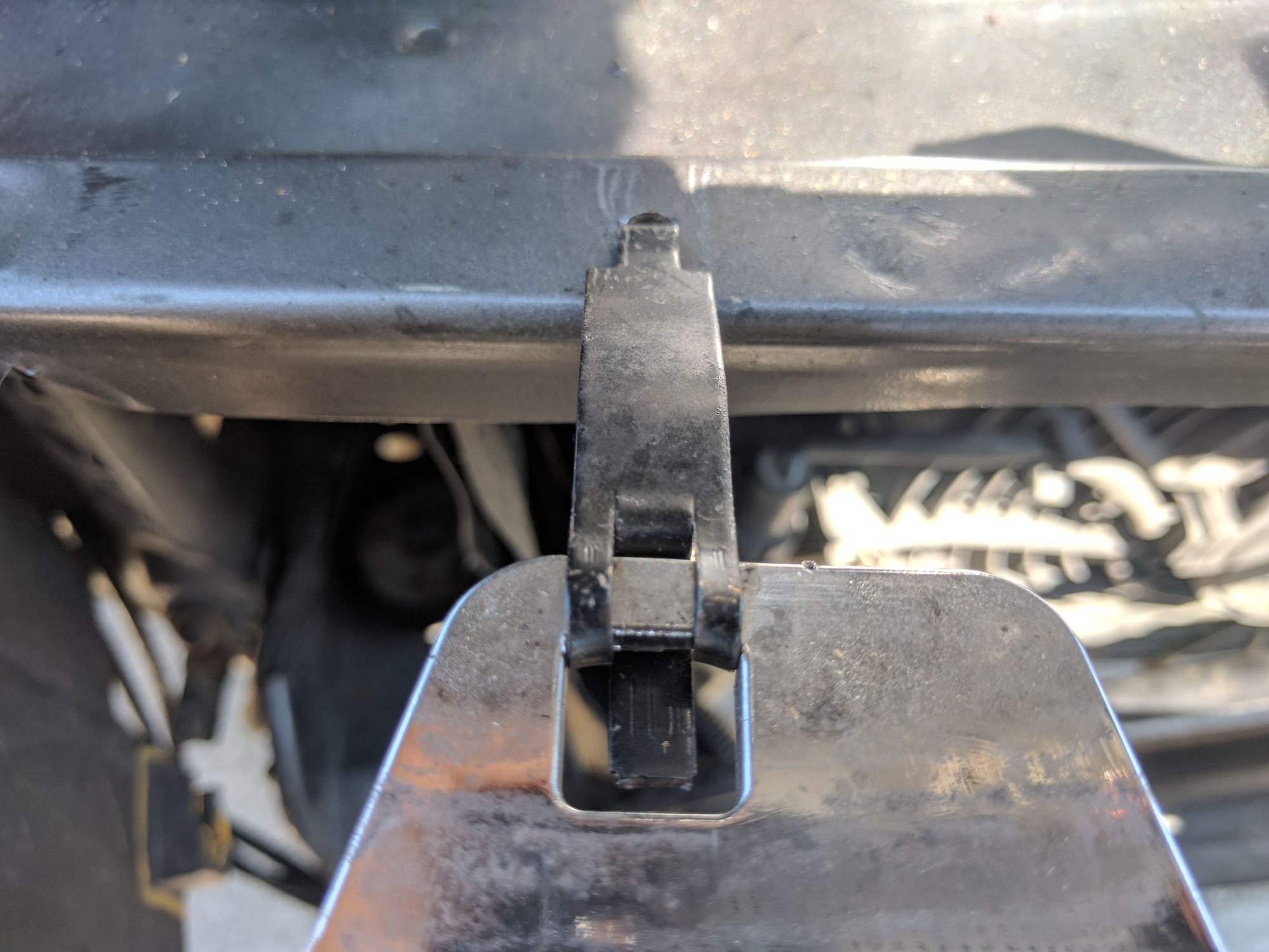

Here's a picture of the top mounting spacer, I used a piece cut out of some metal roofing flashing and then bent the ends over.
