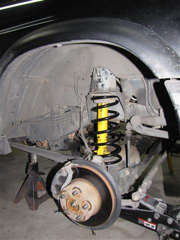

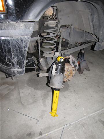

We got to work on removing the shock towers

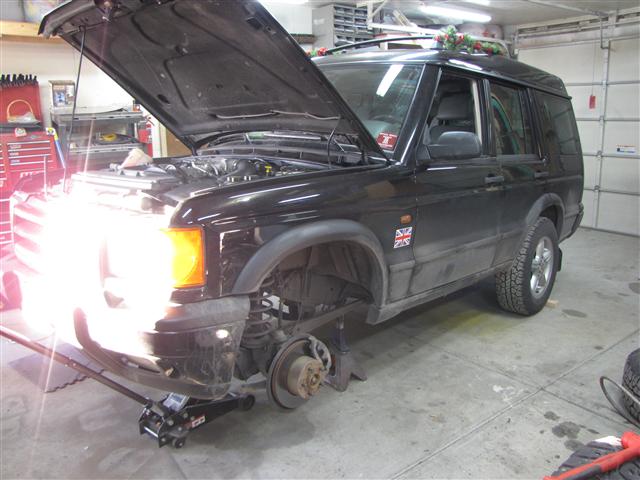

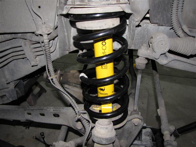

Bolted in the new shocks
Then put it all together. With a little coaxing, everything went right in
Size:  39.4 KBName:  Lifting7Small.jpg

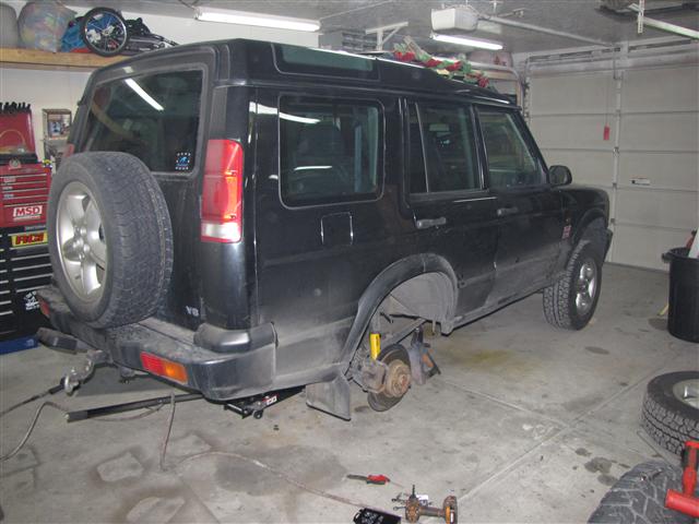

Then it was time to pull apart the back

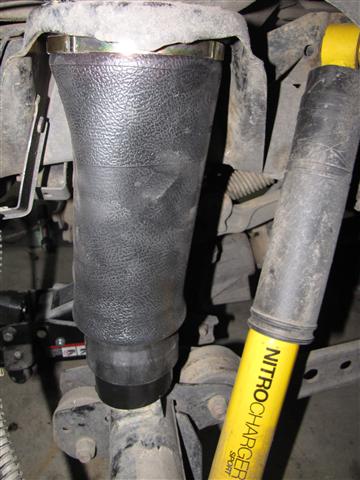

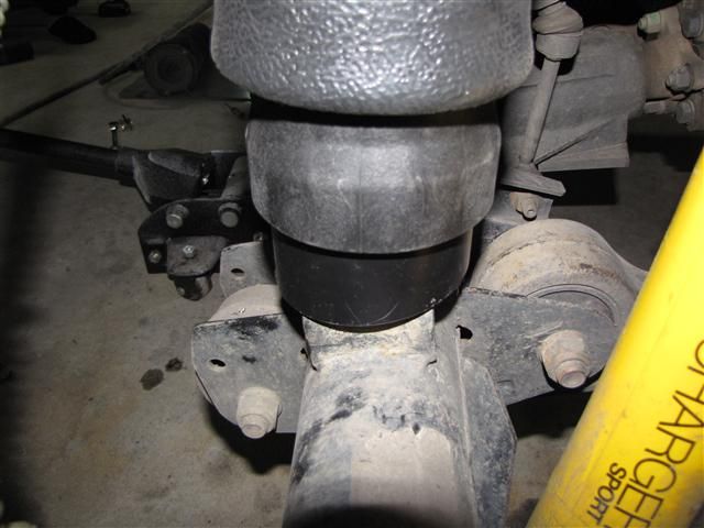

We installed the new Arnott air springs and SLS spacers from RTE
Installed SLS spacer from RTE (these gave me tons of trouble)

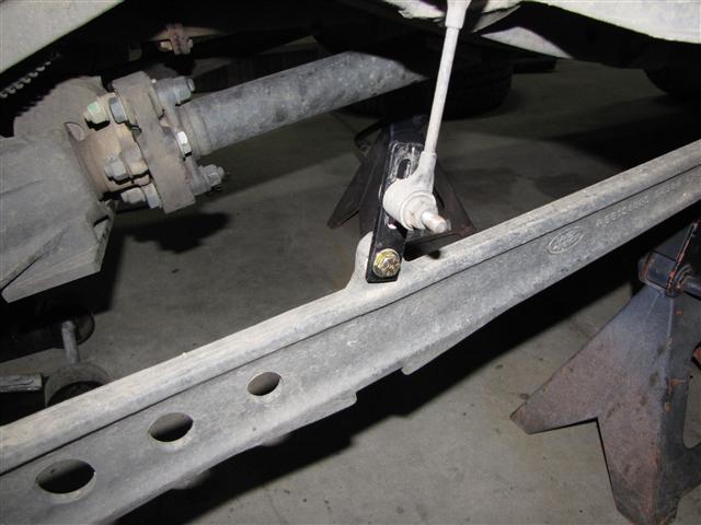

And we installed the height sensor relocation bracket

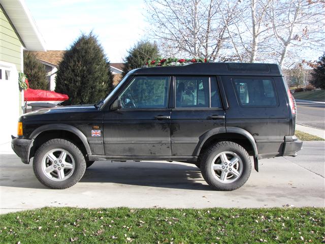

... And then set her down!

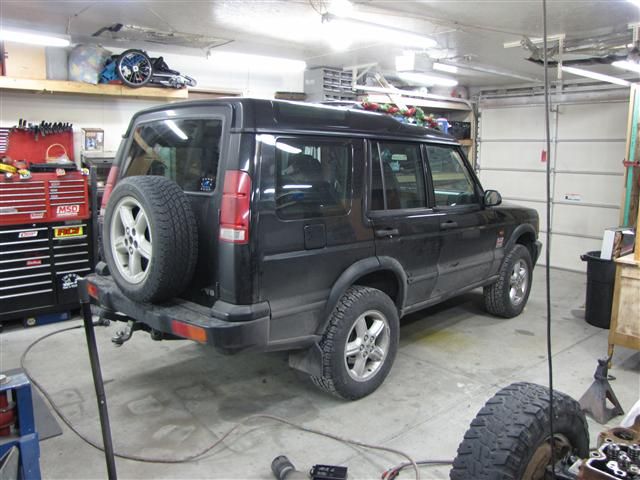

After some adjustment at the back, we managed to make the rear end spot-on level with the front. I started with 18 3/4" from the center of the wheel to the wheel arch at all four corners. After the lift, I've got 21" exactly. So, overall, I netted 2 1/4" of lift. The OME 779 springs and NitroCharger shocks also gave me a MUCH better ride, and slightly flatter cornering, which, to be fair, was already really good with the ACE system. Since the OME shocks are standard length, I haven't had to extend the brake lines or do some adjusting with the front crossmember... Yet. That will come with the extended shock mounts and bump stops soon enough. I think it looks really nice and I do like the way it looks with the 265/60/18s on it, but I will be stepping up to bigger tires in the future. Let me know what you think!

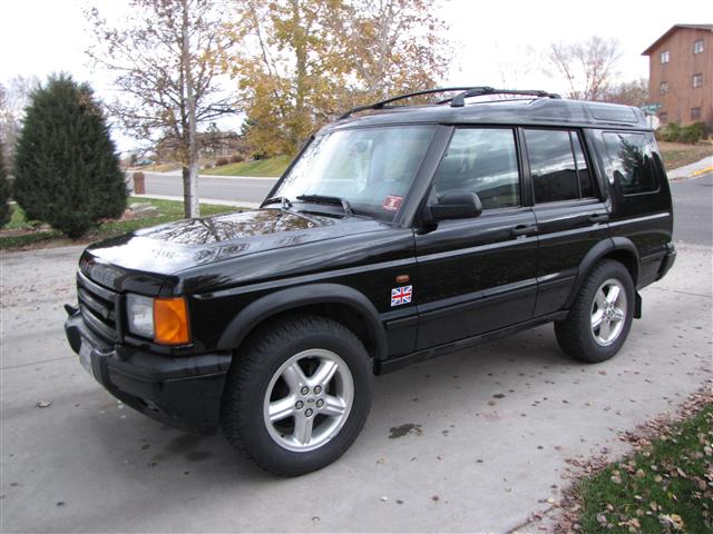

Before/after:
Size:  65.4 KBName:  Lifted13Small.jpg
