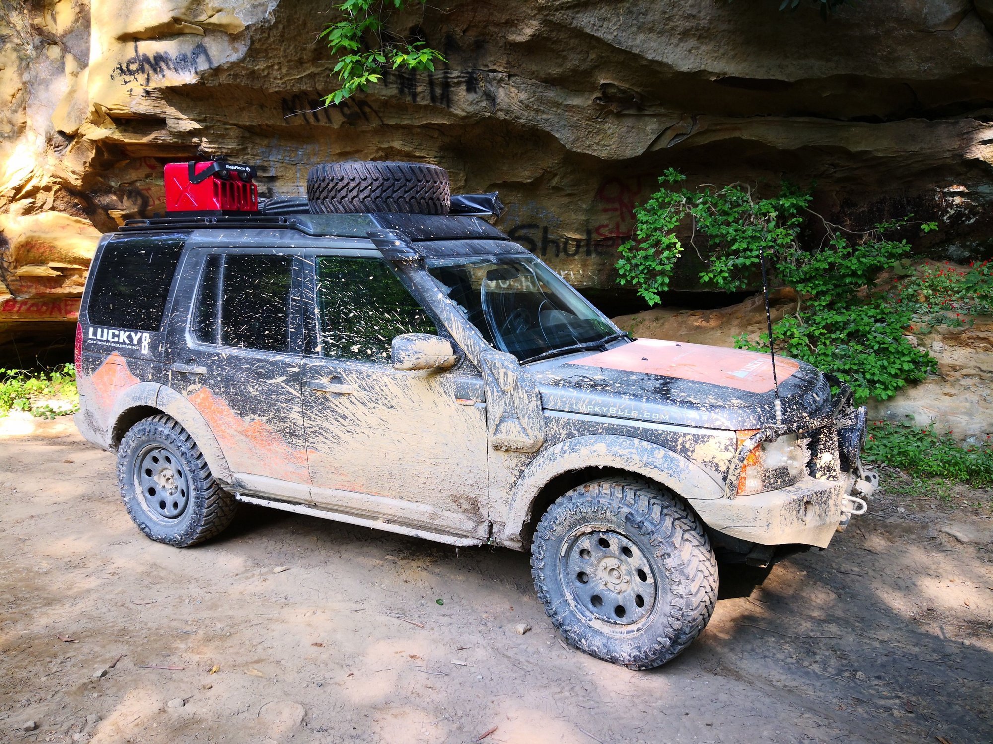

I’m running 18’s on my 06 and my 07 no issues. One is on factory 18’s the other aftermarket TerraFirma steel wheels.

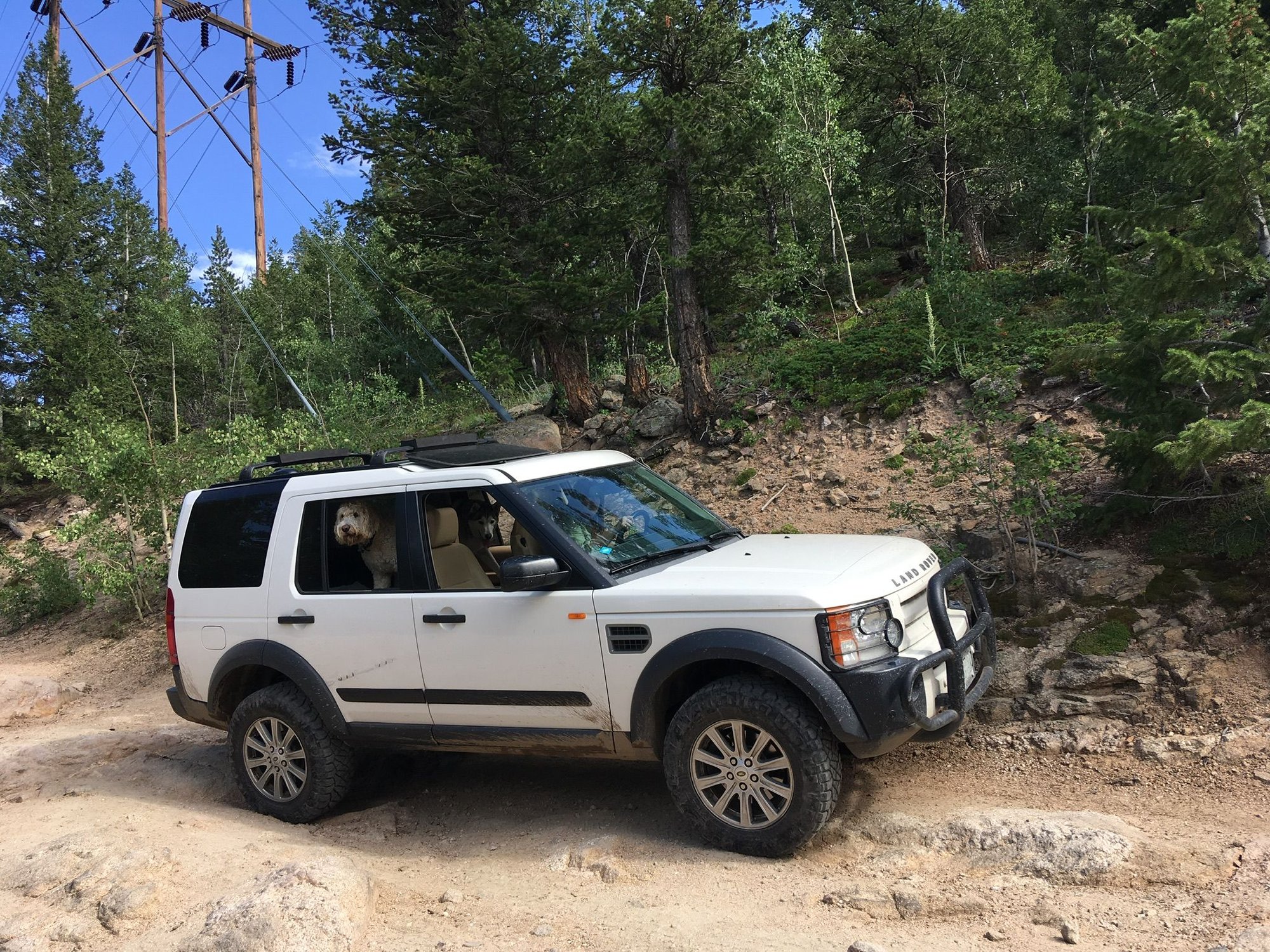

I run 17s and love them. You do have to swap brakes and calipers, and you will lose some breaking power but in off-road situations I find the smaller brakes actually modulate a little better for my tastes.
