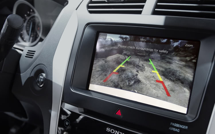

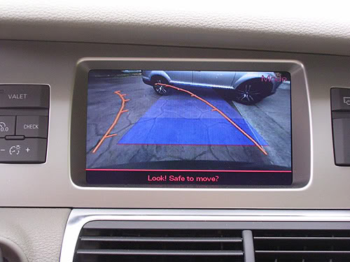

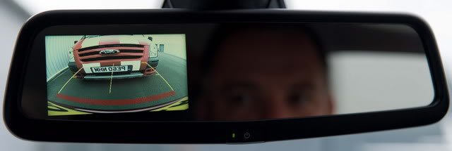

2.) Rearview mirror camera ideal for parking maneuvers: As many fellow Discovery owners may know, parking these rigs can be a royal PIA, especially if you parallel park! Grant these rigs are not very long but the visibility in the rear is limited. Most new vehicles come with some sort of rear camera setup to assist in several parking maneuvers, its time my Discovery got one to! I'm not looking to spend a grand on a fancy setup, just looking for something within a reasonable budget that wont kill my battery.
A fine example of a rearview camera
But this would be nice to

2: there was a post yesterday that linked to a mod that someone put a big ole screen in their dash just where those are mounted in their D2. personally i would go with the one in the mirror for less headaches.
