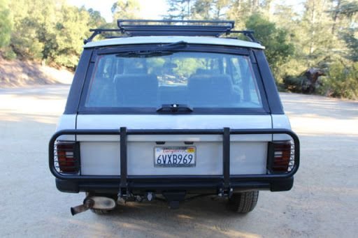

A few days ago i went out to buy a bumper for my Range Rover classic and this bumper was thrown in. I have never seen this bumper for the classics and I cannot find anything about them. If anyone could help thanks. I attached a picture.
It’s a rear bumper that folds up and down for the cargo doors.. hell, it was still in its box from 1987. That’s all I know about it. It was for a 1987 RRC.
this picture is not my picture. This is the only picture I have found of this bumper.

I can see why nobody bought or used it, it is on the ugly side of the spectrum. Now, if it folds out "flat" from the bumper, I bet you could make a table that sits on atop it for camping or other uses.

Tailpipe looks worse than the bumper.
