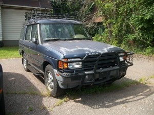

I am looking at a used roof rack from a '94 Disco. I am wondering if it will fit on my '02 Disco? It's one that attaches to the gutter. So I guess it would depend on if the size or shape has changed between those years.
Extra credit: Will the brush guard, step sides and tail light guards fit as well??
Thanks! -jay

D1 roof rack will fit just be short, tail lite guards no, steps I doubt it cause d2 is longer, brush guard might if you drill 3 rd hole each side
