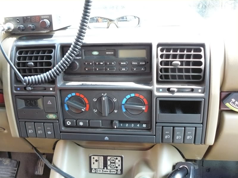

I'm not sure what you're asking, it sounds like you're describing the same part.
Get something like this to replace your ashtray.
Land Rover 94 Discovery Cruise Control Switch 1994 | eBay
There are also binnacles that have three switches instead of two. Getting the wires run cleanly to the back is a little tricky but can be done.
Here's mine.

That's exactly what i want my set-up to look like. Sorry, my post sounded perfect in my head, and then i re-read it, and it is confusing as hell.
I only have the one binnacle on the left, and it is only two switches, in the middle, with "fake blanks" on the outside. I wasn't sure if the binnacles with the three switches were interchangeable with the ones with two, AND if they could be swapped from the left and right sides of the dash. (meaning either can take the place of the ashtray as well) But it looks like you confirmed that they can.
Thanks again.

I just sold off my two extra binnacles too.
Try some of the used parts guys for the switches. Try to get them with the plug/pigtail attached, it makes splicing in wires much easier. There's a drawing on Dweb somewhere of what each pin does.
Basically one pin is ground, one is switched power from your parking lights so the switch illuminates when lights are on, one is power in, one is power out. I would use a relay for sure because these switches aren't designed for a big load.
