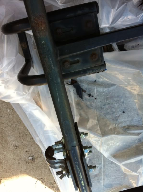

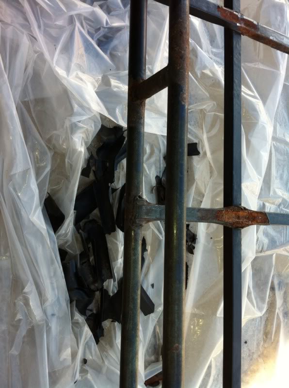

ColoDisco's Avatar
Joined: Aug 2009
Posts: 851
From: Golden, CO
Originally Posted by Banzai Jimmy
Tried a heat gun yet?
I tried a method offered up on EXPO. Heat gun. I scored the plastic and heated it up to pliable and it just peels off.

Old Apr 4, 2012 | 09:12 PM
Banzai Jimmy's Avatar
Posts: 467
Likes: 36
From: Aurora, CO
Thought it may work. Good deal.
