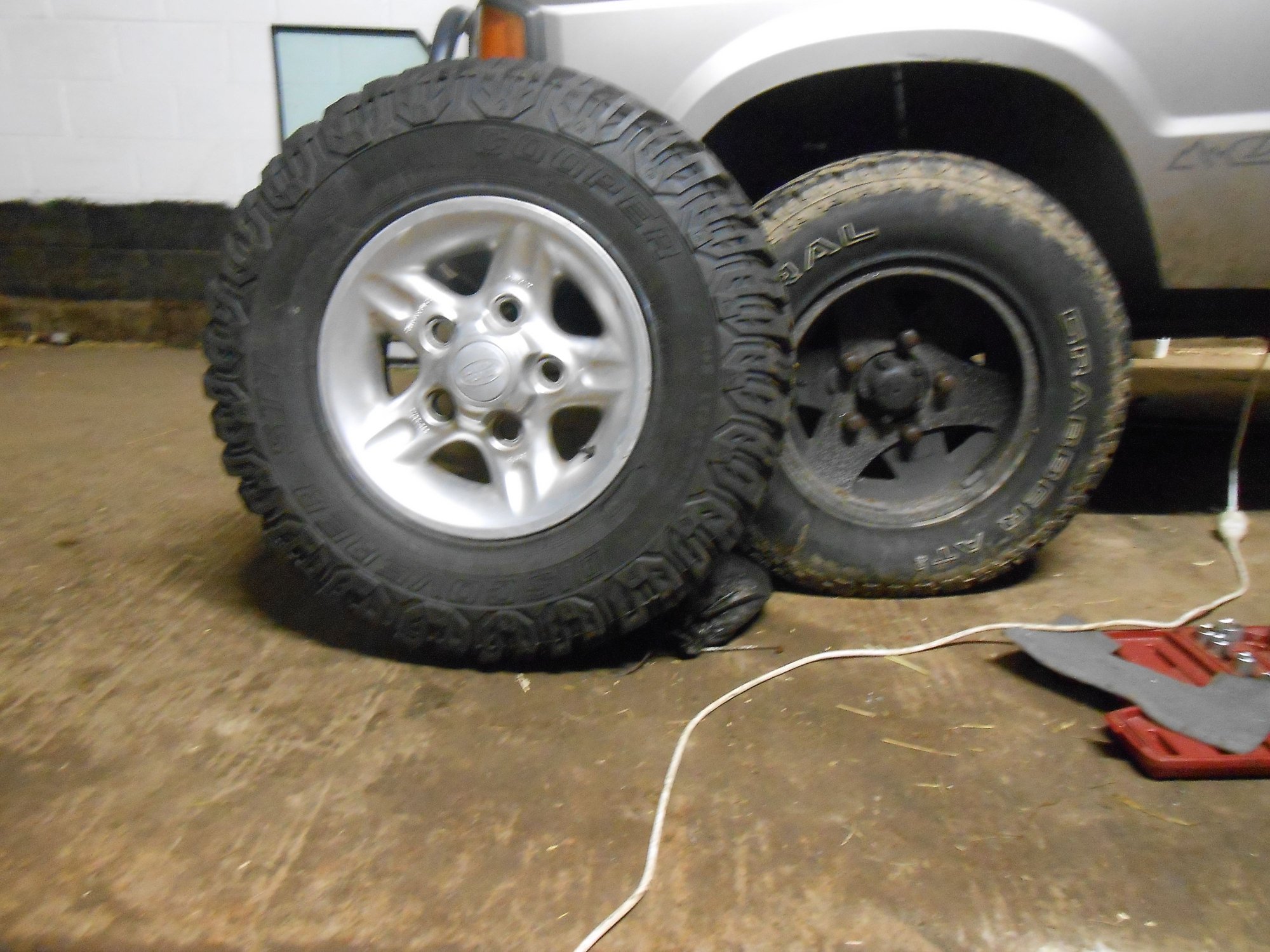

I went a little bigger than stock.
Bigger than stock size.
Cooper STT 235/85 r16 a 32" tyre just under 9.5" wide on LR deep dish alloys, great tyres, ran them for 6yrs on standard suspension no probs only slight rub under extreme articulation. Been running a 2" lift for a couple years now and nothing changed but will be swapping out for custom rims soon with new 33" tyres so we'll see how that works out.
