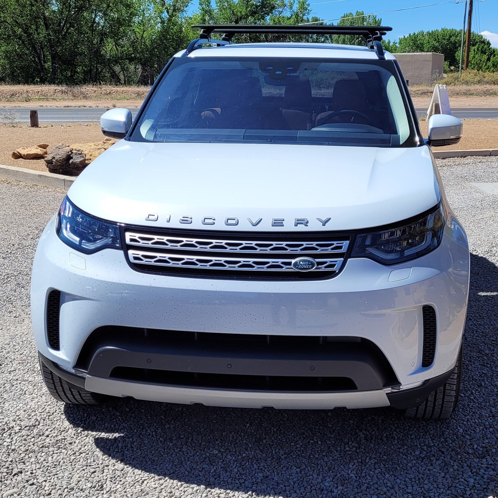

I bought these from Rhino Rack and use them - they're great, I have a cargo box, max trax holder, awning and a shovel holder mounted to them.

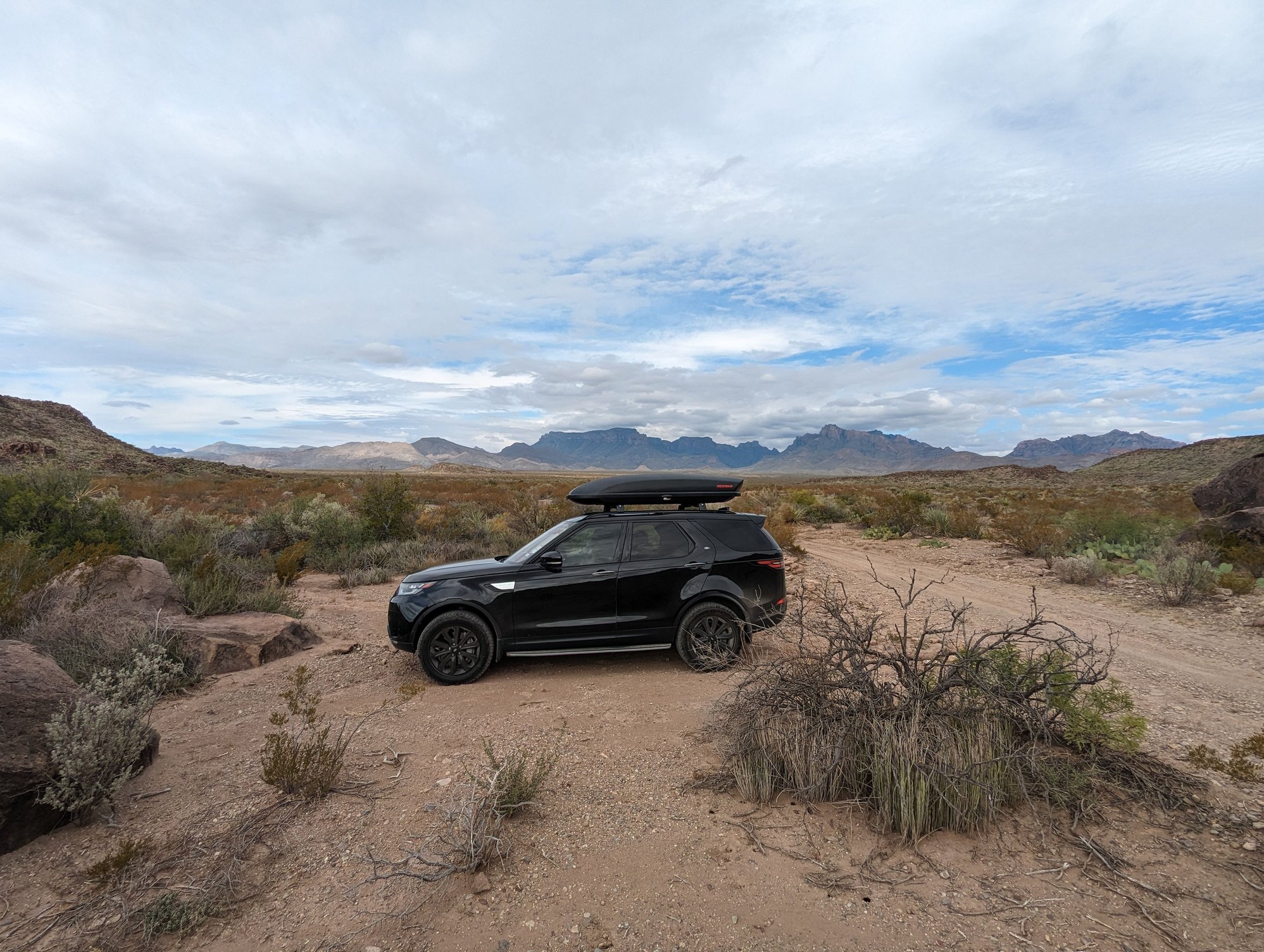

I'm happy with my Thule wing bar evo.
I tried the Rhino Rack bars and I could not fit them properly and I returned them.
