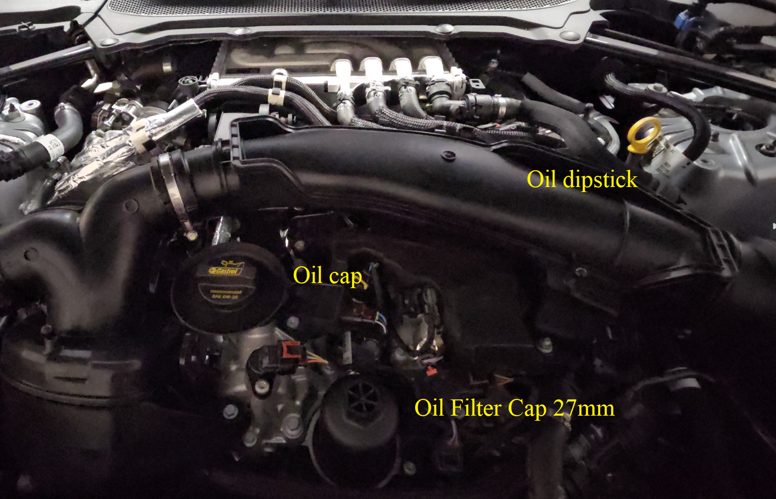

  2. Remove engine cover by pulling gently on each corner. There are 4 mounting points to pop off.
  3. Remove oil filter cap (27 mm). There's a small amount of oil (< 1/8 quart) in the filter housing which you can siphon out.
  4. Remove dip stick.

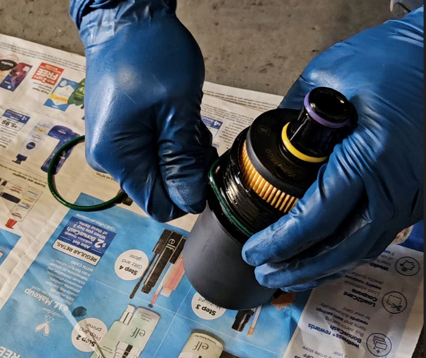

  9. Replace o-ring on oil filter cap and lube.
  10. Lube the o-rings on new filter and push the new filter into the filter cap.
  11. Install filter cap and torque to 25 Nm

  13. Install dip stick and check oil level. it should be between the two holes.
