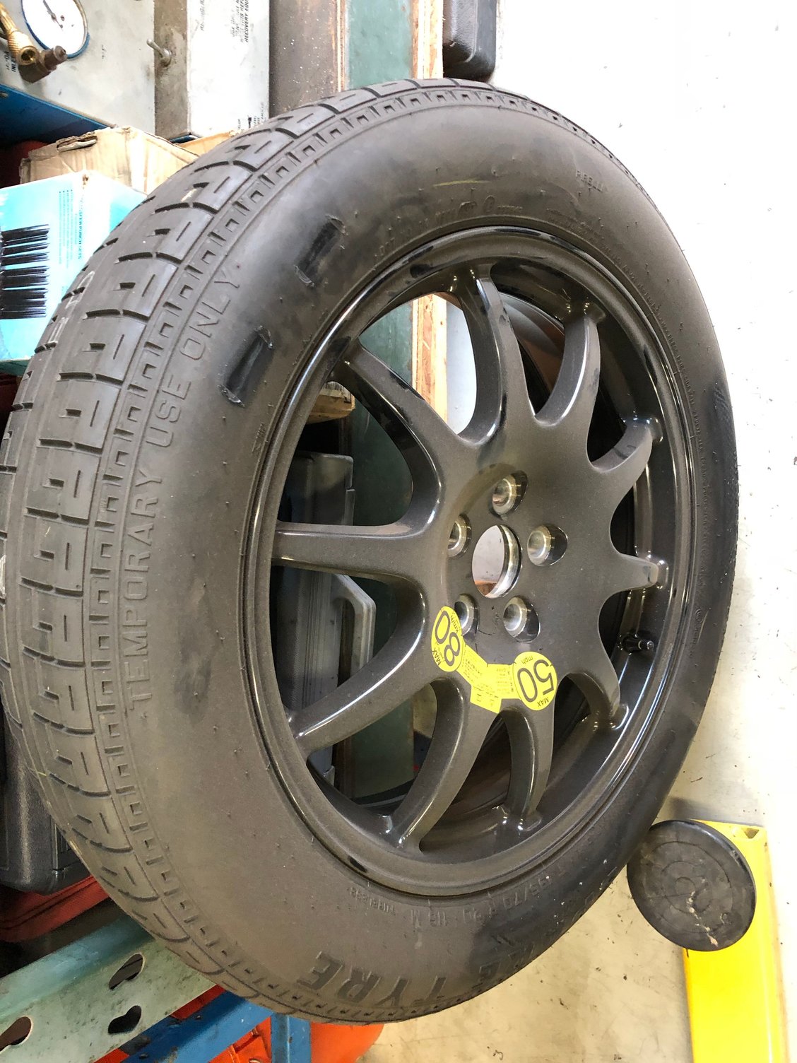

Fit the spare today.

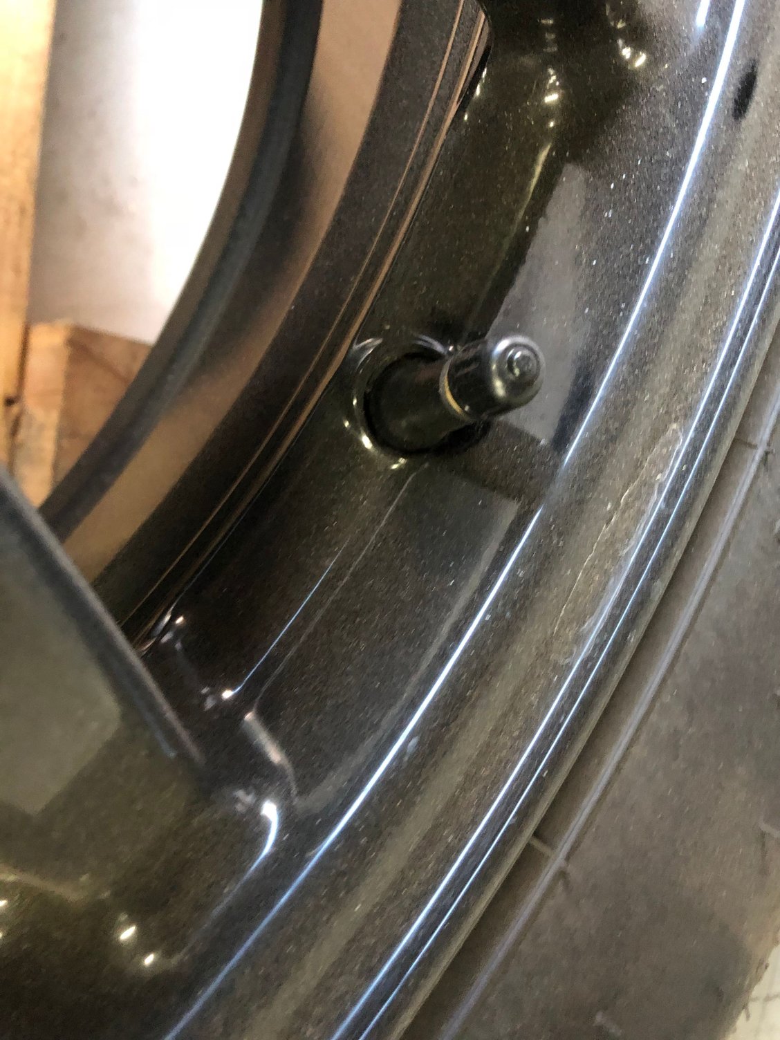

I was worried the stock had TPMS, so I fit one on the spare.
pulled the stock donut down and no TPMS.
size fit with room to spare.

Good info, looks like it will also fit with to hitch.
That size seems like a good size to go for offroading, 275/55/20 is not exactly the best sidewall size, but at least 1/2" more sidewall than stock :-)
