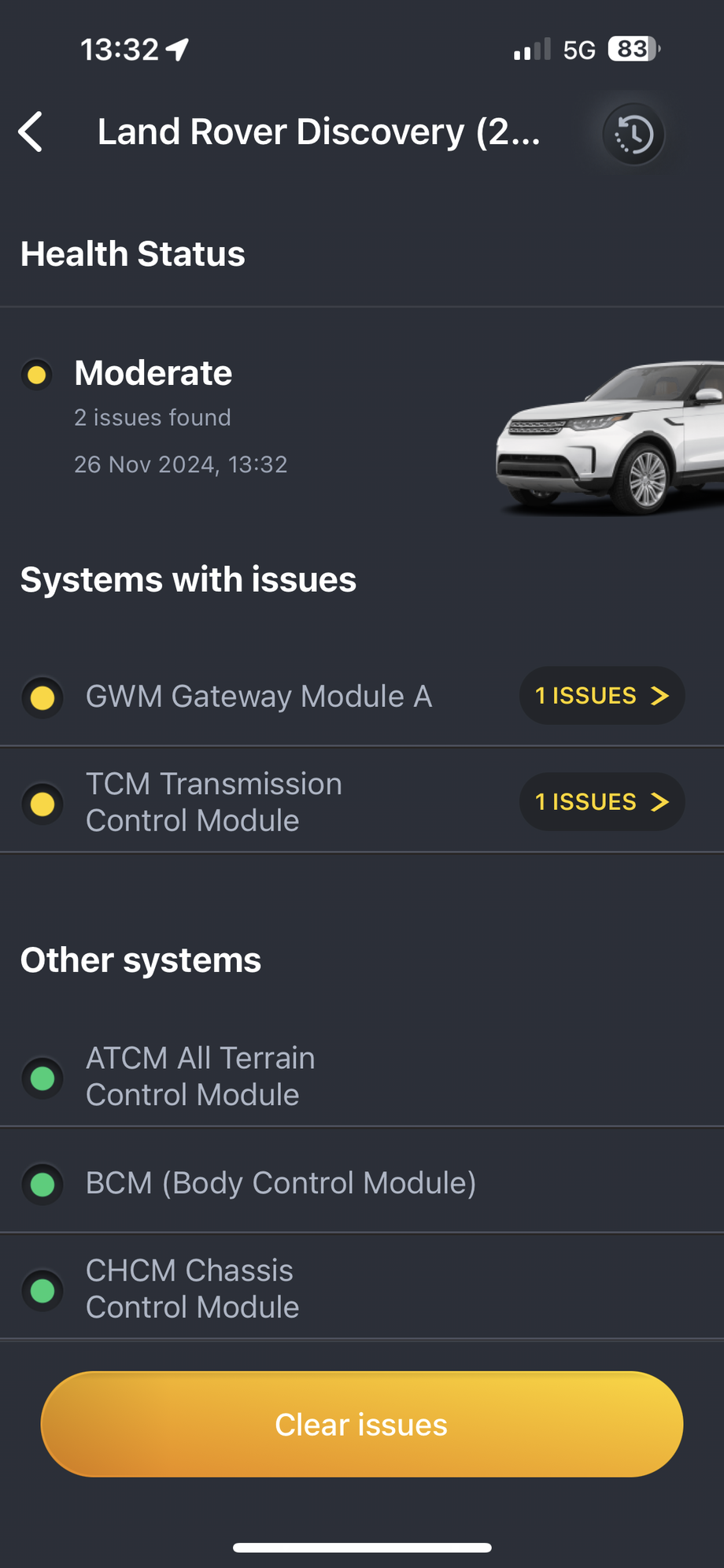

I have a Carly scanner and I scanned it now and I have two errors

[img alt="I dont know, I scanned it with a new scanner now
"]https://cimg3.ibsrv.net/gimg/landroverforums.com-vbulletin/920x2000/19d6f575_ad8f_4451_b78d_cd6622136569_0848dd2093f72 4c4c8b6efd6a7c9b26518bcb92e.jpeg[/img]
I don't know, I scanned it with a new scanner now
