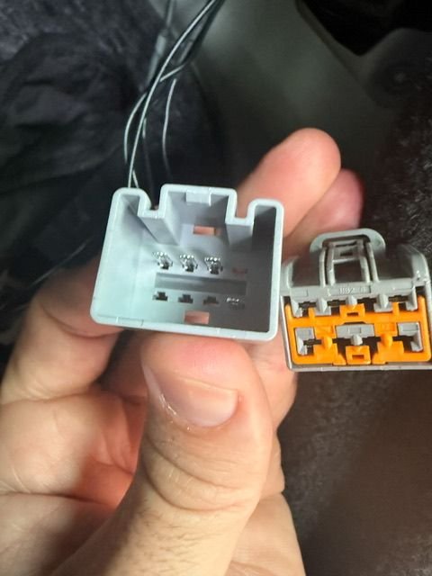

I just did the butt-lift conversion I installed the 2025 tail lights on my 2017. Car is US version. Check the plug in the back and see how many wires you have US has only 4. 1 for break light/turn signal, 1 running light, 1 di feedback and 1 ground. It’s missing the dedicated DI wire.

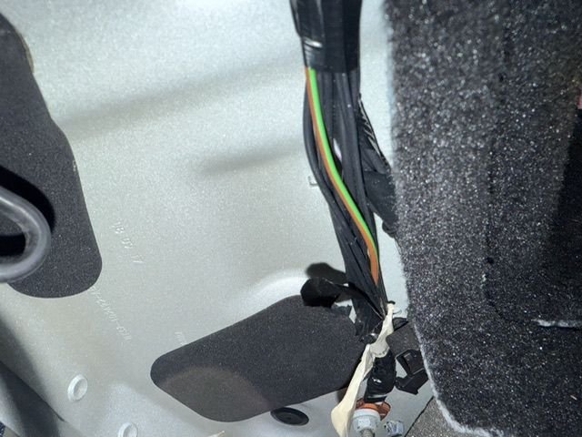

If someone could chime in I believe unused wires are just being grounded and I think I found it. See picture attached you would just take that DI wire and add it to spot 2 in your harness.
There are also several ccf settings for EU market, sweeping di etc accessible via GAP IID tool.

That grounded wire looks to be Green/Brown vs Green/Orange for the DI line. The GN/OG wire would trace back to the body control module rather than going to ground.

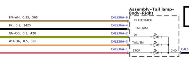

I wonder if the unused lin/dcm wires are just grounded from the bcm. In the tail light diagram all three are grounded in the taillight. I am just guessing here.
I did bridge the brake and turn signal ( pins 1 and 2) and both the red and amber turn signal worked but at the same time. So another option would be to install one of those turn and break signal splitters.

The right way to do it is to trace to where the GN/OG wire lands on the BCM and install a new "overlay" wire in the BCM harness connector back to the taillight DI pin. After that's done you'd need to change the appropriate settings in the GAP tool to separate the DI wire from the Brake wire. It may also need to be done for the tailgate lamp since the DI light wraps across both lamps.
