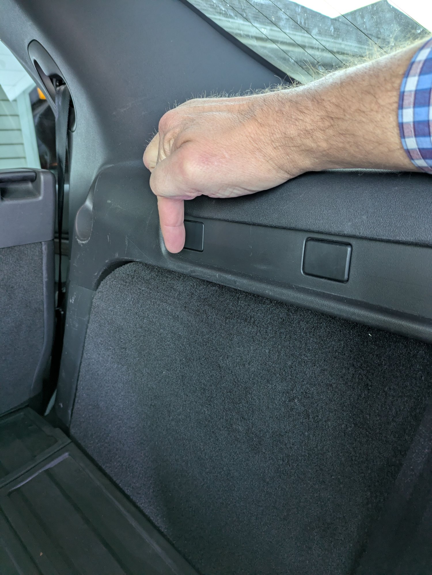

I have attached a short length of flexible wire with a loop end that allows me to slide the sliding latch rearward. And I just reach behind and push it to slide it forward. Yes it’s a poor design but not broken and still usable if you examine it with panel removed and see where the sliding latch is supposed to engage with the panel. You have to remove the smaller rearmost panel first but that’s no problem.

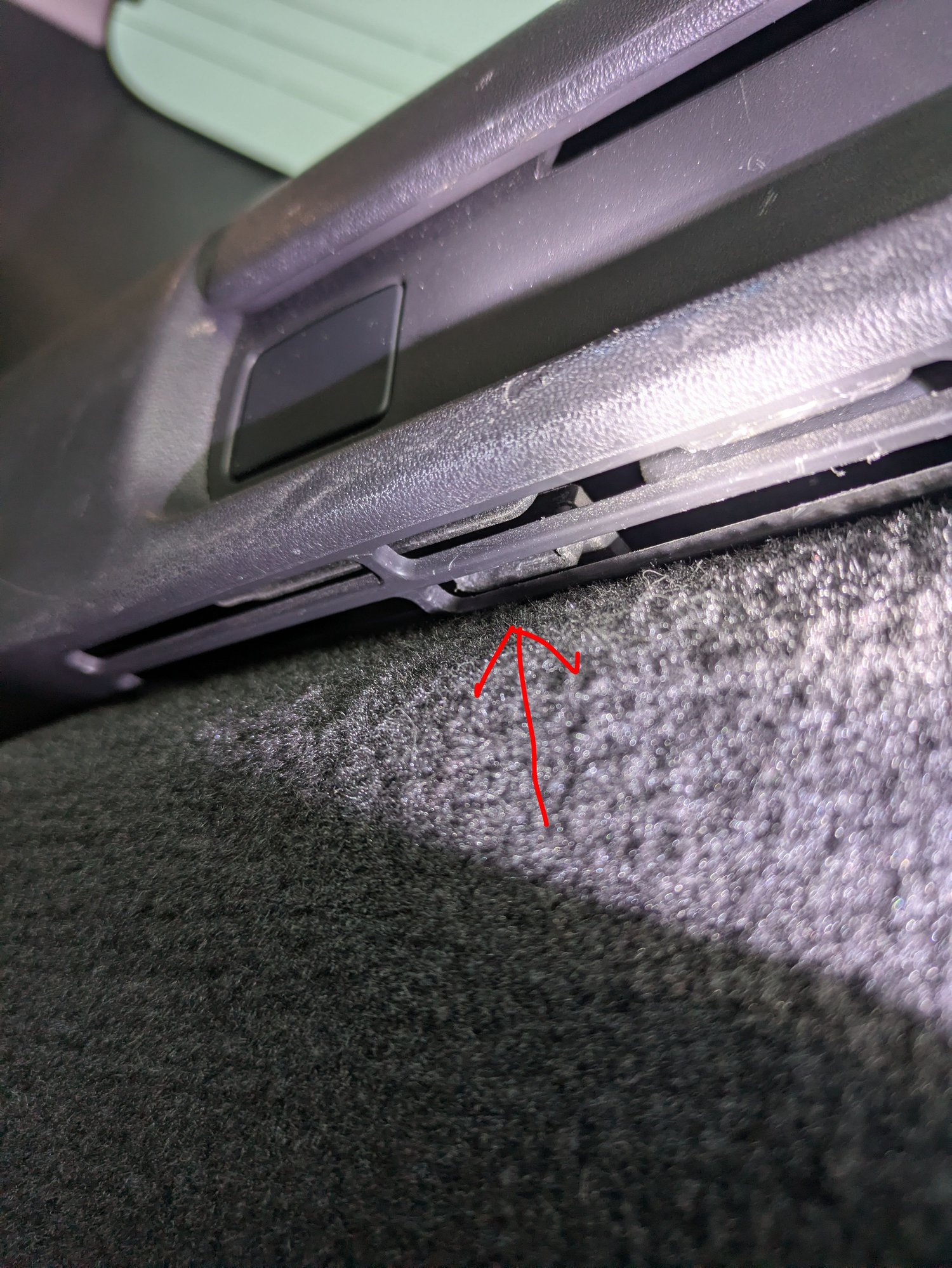

There's a rectangular notch in the underside of the slider that can be used to slide it back and forth to engage/disengage... Use a flathead screwdriver. Have to look under to see it.
