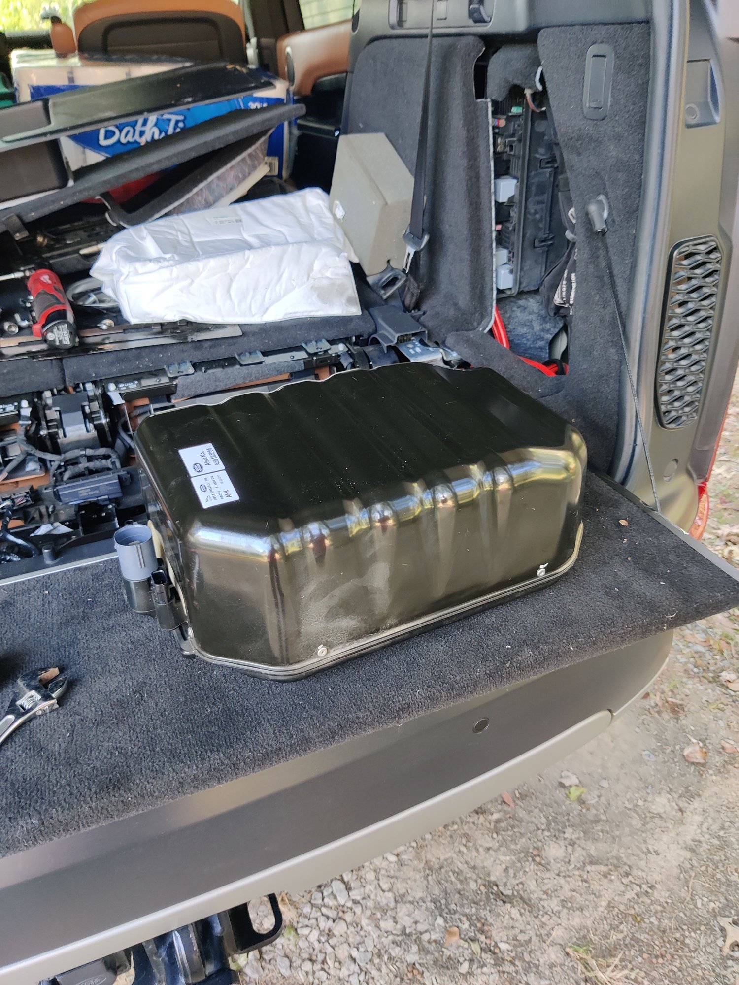

It wouldn't let me raise or lower suspension , also no cruise control or forward alert.
first opened up compressor tested for air leaks, no air leak.
replaced the expansion chamber, fixed it. #LR140035
actual code
pulled the unit
compressor in housing
drilled all rivets out
compressor with both housings removed
part
rivet tool
part came with rivets to reassemble

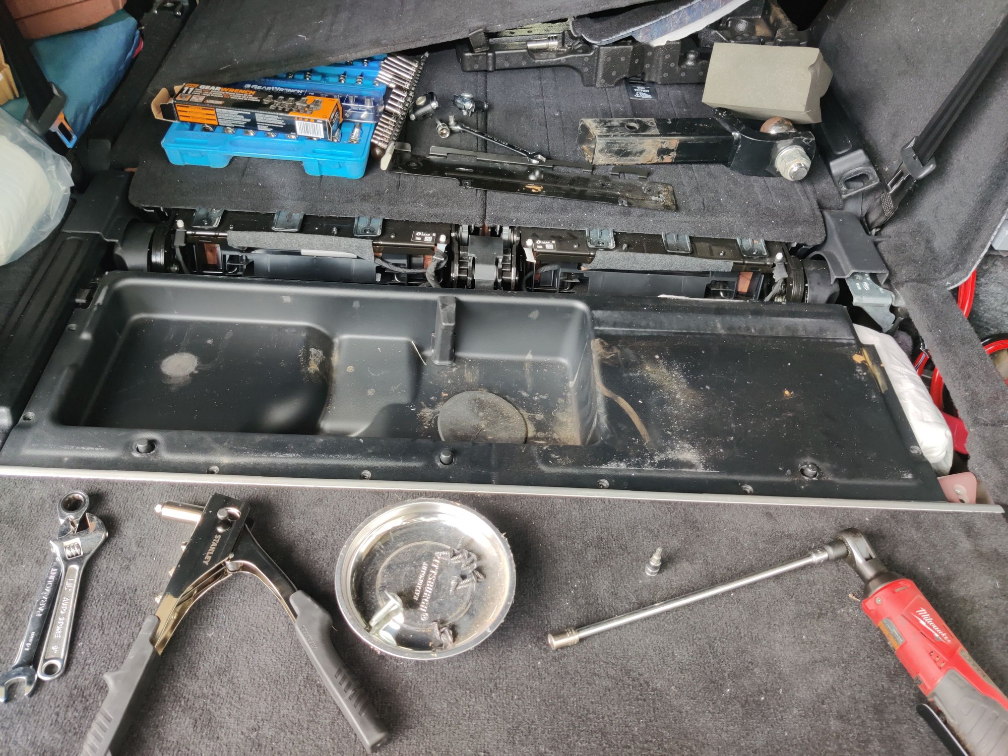

the filter is also riveted in
inner housing assebled
everything reassemble and bolted in
cover installed
tray and side pieces bolted in
foam back in place.
Hope this helps someone!
took about 5 hours, including air leak testing with soapy water.

Wow! Way to go. Really buried down in there. I've never riveted a thing in my life 😂
Old Oct 7, 2024 | 04:37 AM
gmfain's Avatar
Joined: Feb 2015
Posts: 934
Likes: 545
From: Calhoun, GA. USA
Talking
Its easy, drill old rivet out with a 4mm drill or a 5/32 drill........ the old rivet becomes two pieces, and falls away...... when reassembling, open rivet gun handle wide open, insert rivet into gun...... position into the hole, hold a little pressure inward, close/pump handle, ( usually two pumps) then the stem on the rivet will pop off! ( pop rivet)
No worries.
Good luck!
