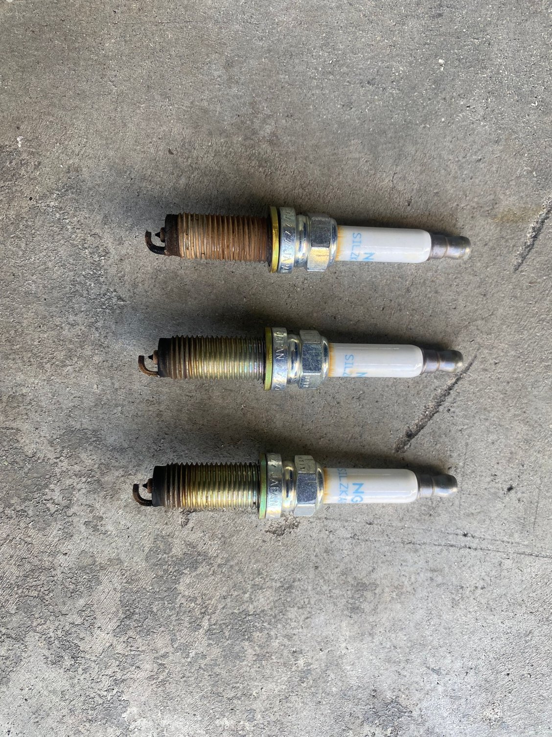

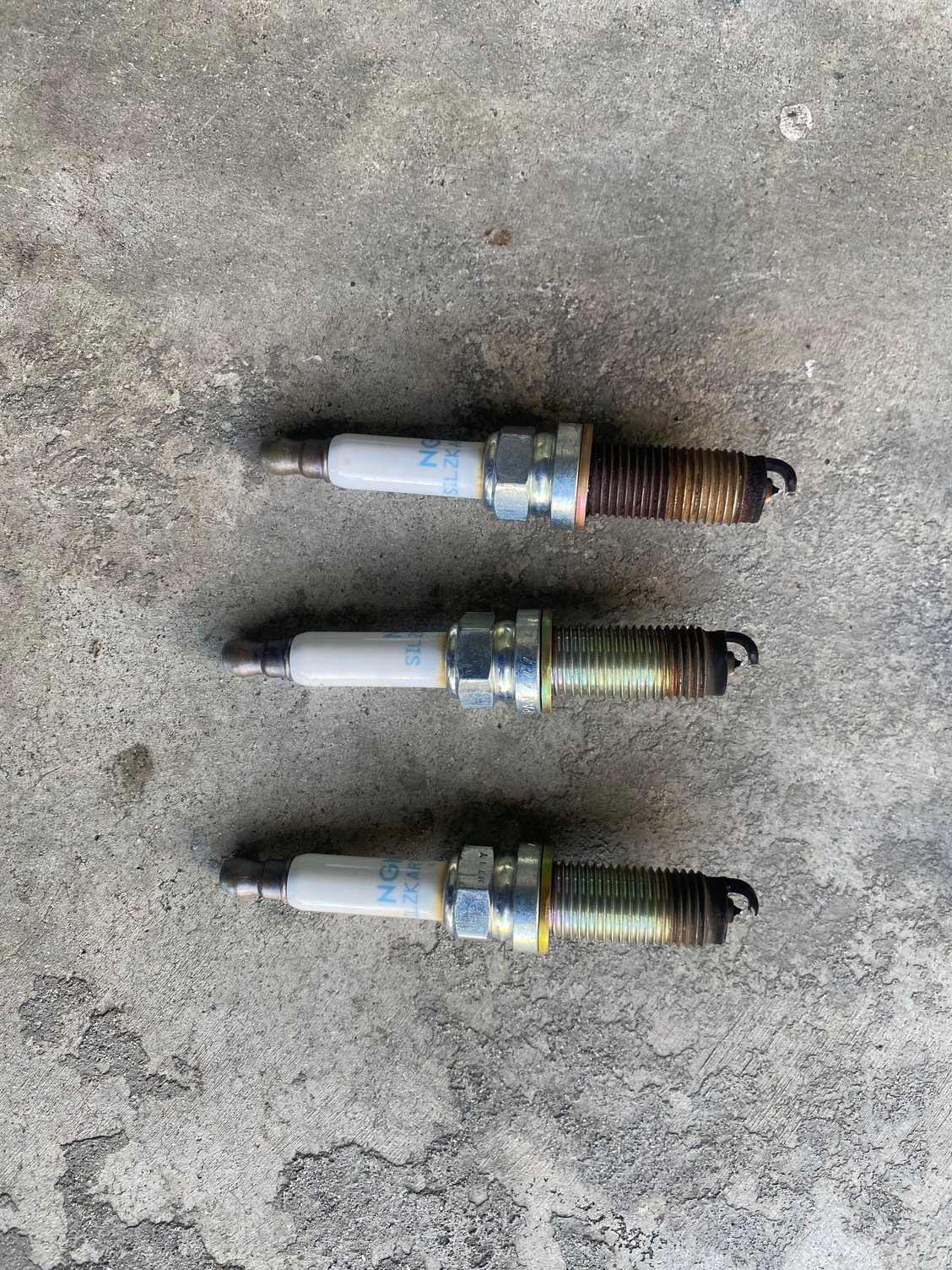

Today is annual service day for the Disco. Car has 74,500 miles and got new oil and filter, cabin filter, transfer case and diff fluids and spark plugs. As always this forum has proven extremely useful in tackling those items (I have the workshop manual but sometimes it overcomplicates things, e.g. removing the coolant pipes/hoses that are the topic of this thread). The spark plugs that came out looked reasonably normal (caveat that I am no expert), however the ones from the back (cylinders 3 and 6) had rusted threads which suggest to me water/coolant ingress in some way or form. While taking out those two did require some more strength than the rest, the new ones threaded very easily.
Would love to here thoughts from people with more expertise than mine, as to potential causes. Engine has been working perfectly fine and I have never experienced any low coolant warnings.
