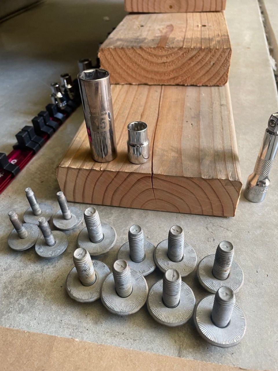

I counted 12 when I did my transmission.

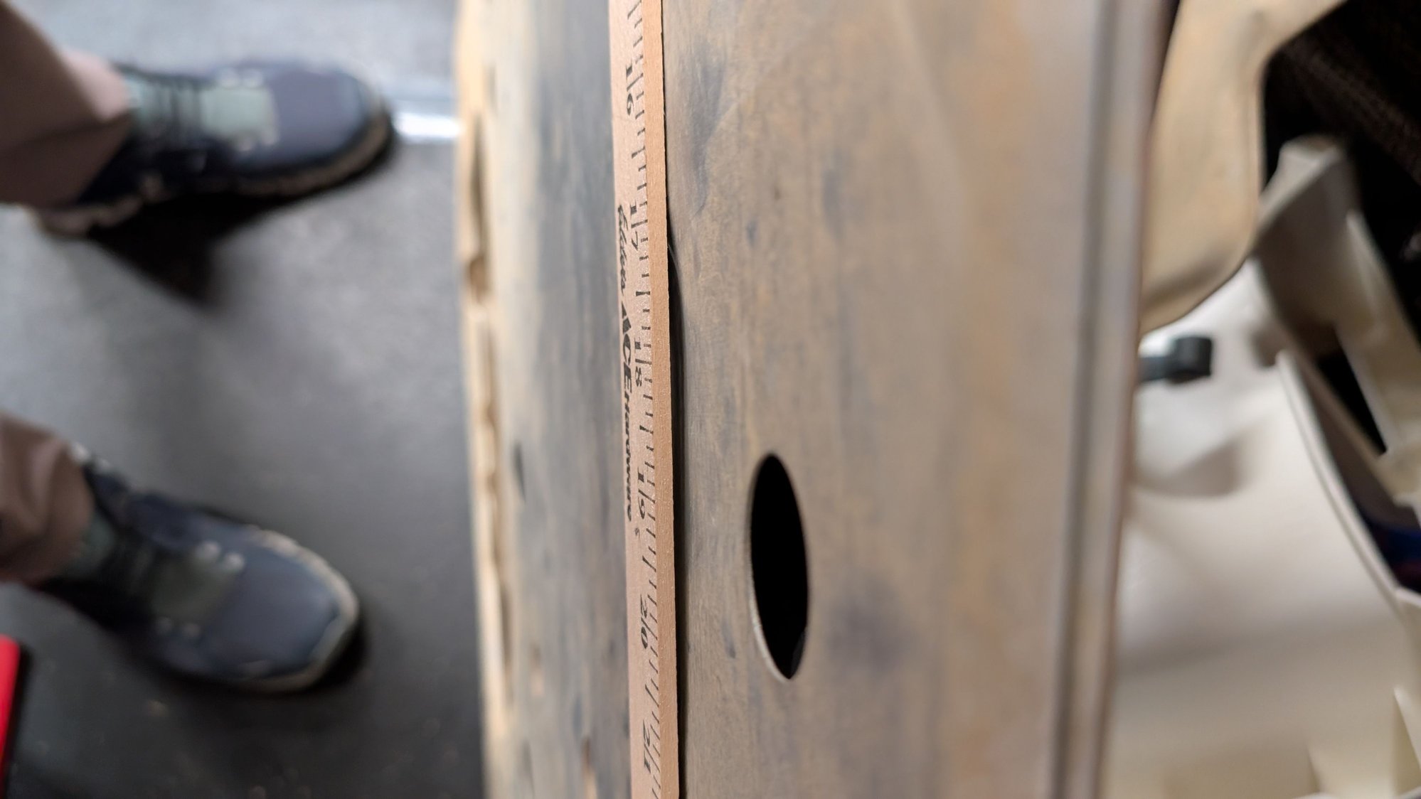

Can you take the rear shield off without removing the front shield?
I removed the shields and the noise remains exactly the same. No way the tech drove it after removing them and then guessing wind in your broken shield was the problem. Ticked they wanted me to pay $850 to replace a perfectly good part and didn't even bother to do a proper diagnosis. Back to Rover I guess 🙄
https://photos.app.goo.gl/QgVGp7p86gKEKqHUA
The dent that
The dent that "destroyed" my transmission shield is a couple mm thick 😂

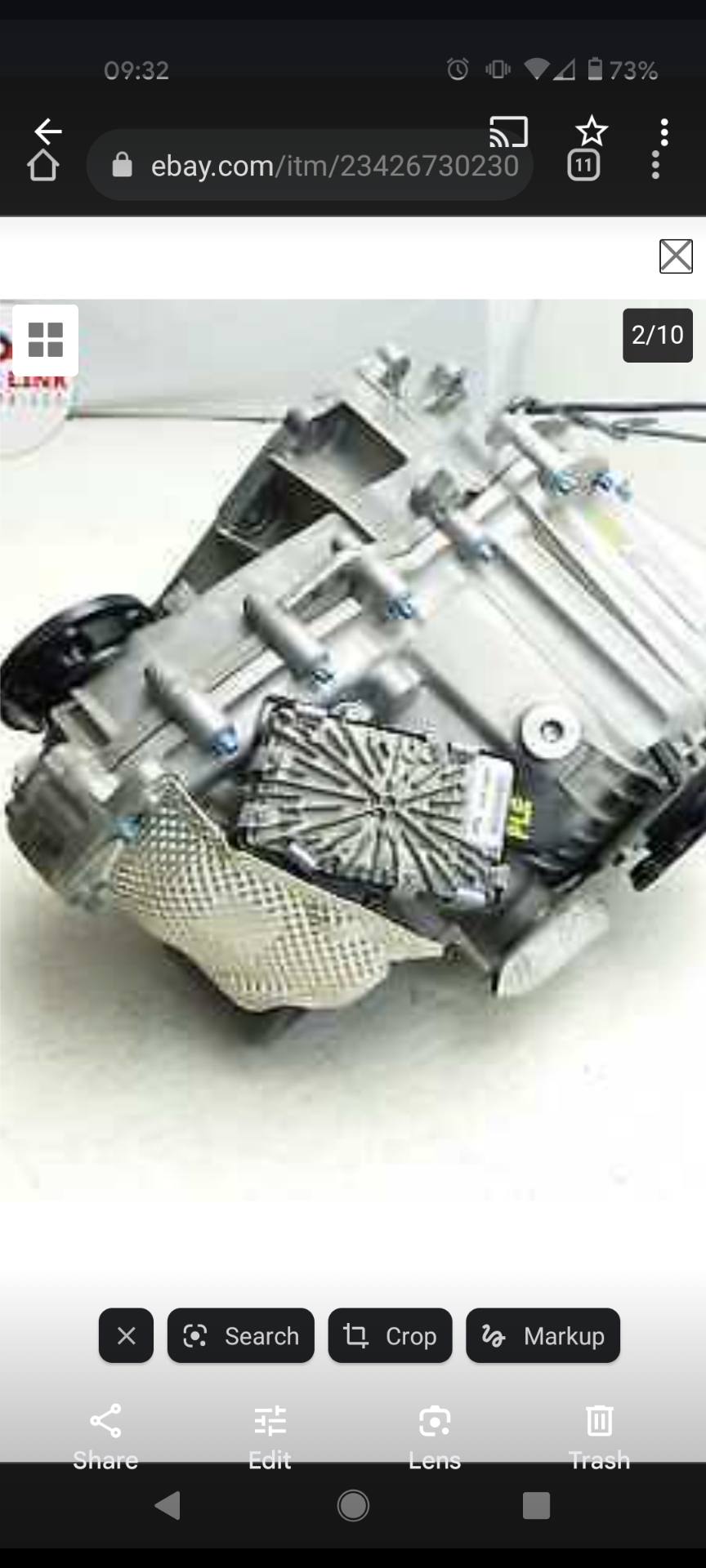

We keep calling the front and rear skid plates heat shields. Nevertheless, I had a rattling heat shield on the transfer case because one of the holes for the through bolt was broken. Probably a long shot but here's the part number. LR082660
https://landrover.scuderiacarparts.c...99/5348/107266

Question
Just curious, Is your a diesel? ( two different shields)

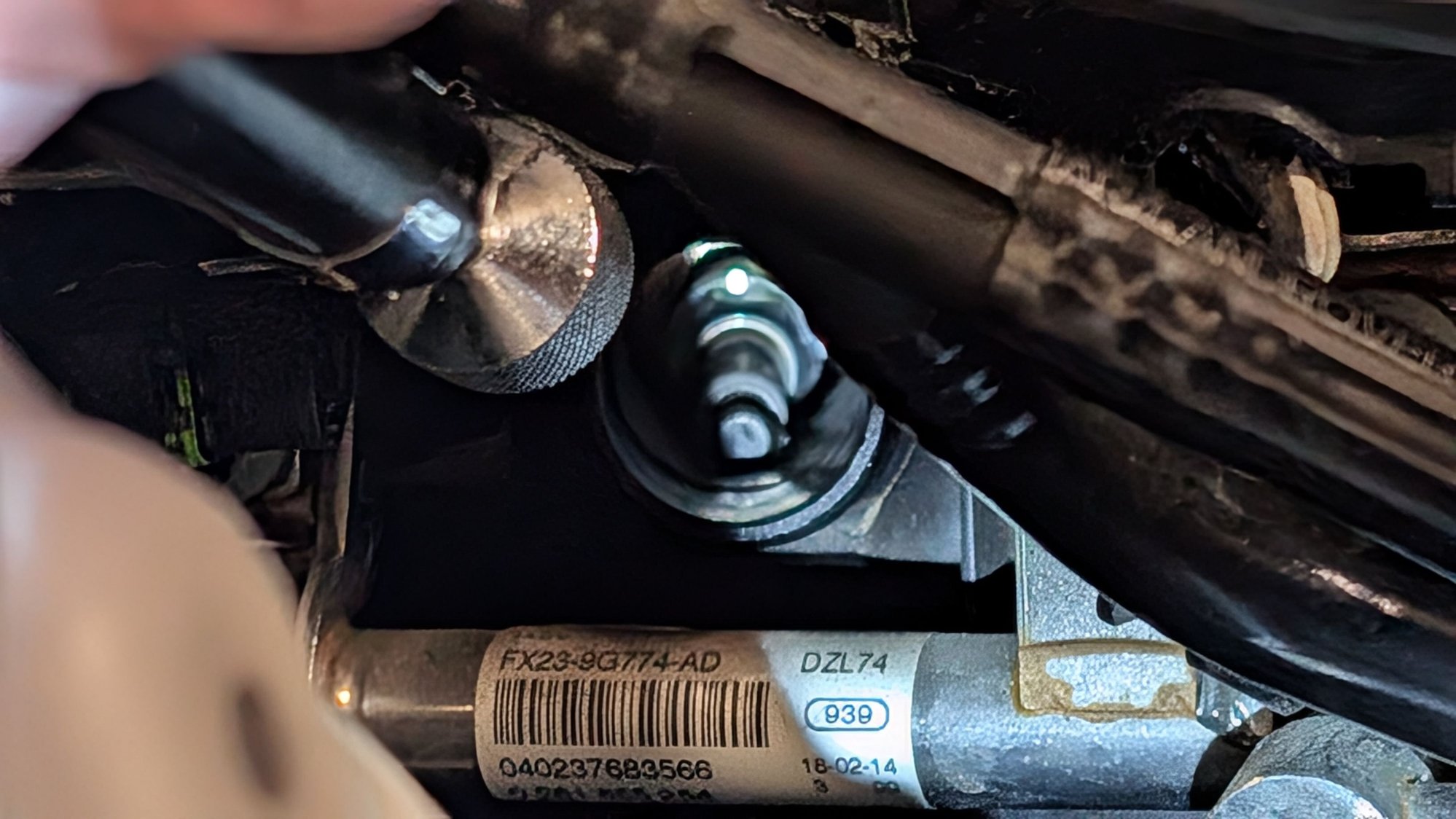

Just replaced my spark plugs at 55k miles. Not sure if they were that bad. There's certainly buildup in some of the cylinders. Does that look like normal buildup?
Tools needed
  • Socket - wrench extension tool (about 5 inches long)
  • 15mm deep socket or 15mm spark plug socket
  • Magnet on an extender if you don't have the spark plug socket
  • T30 bit driver. Helps to have it in socket format for the tight angles
  • Some anti-locking paste
  • A wrench that can bend into multiple angles. It's tight in there and a straight wrench would not work
  • Breaker bar (even if it's a kids toy &#128517
  • Endoscope is a plus!
The left side is much harder to access. Good luck!
