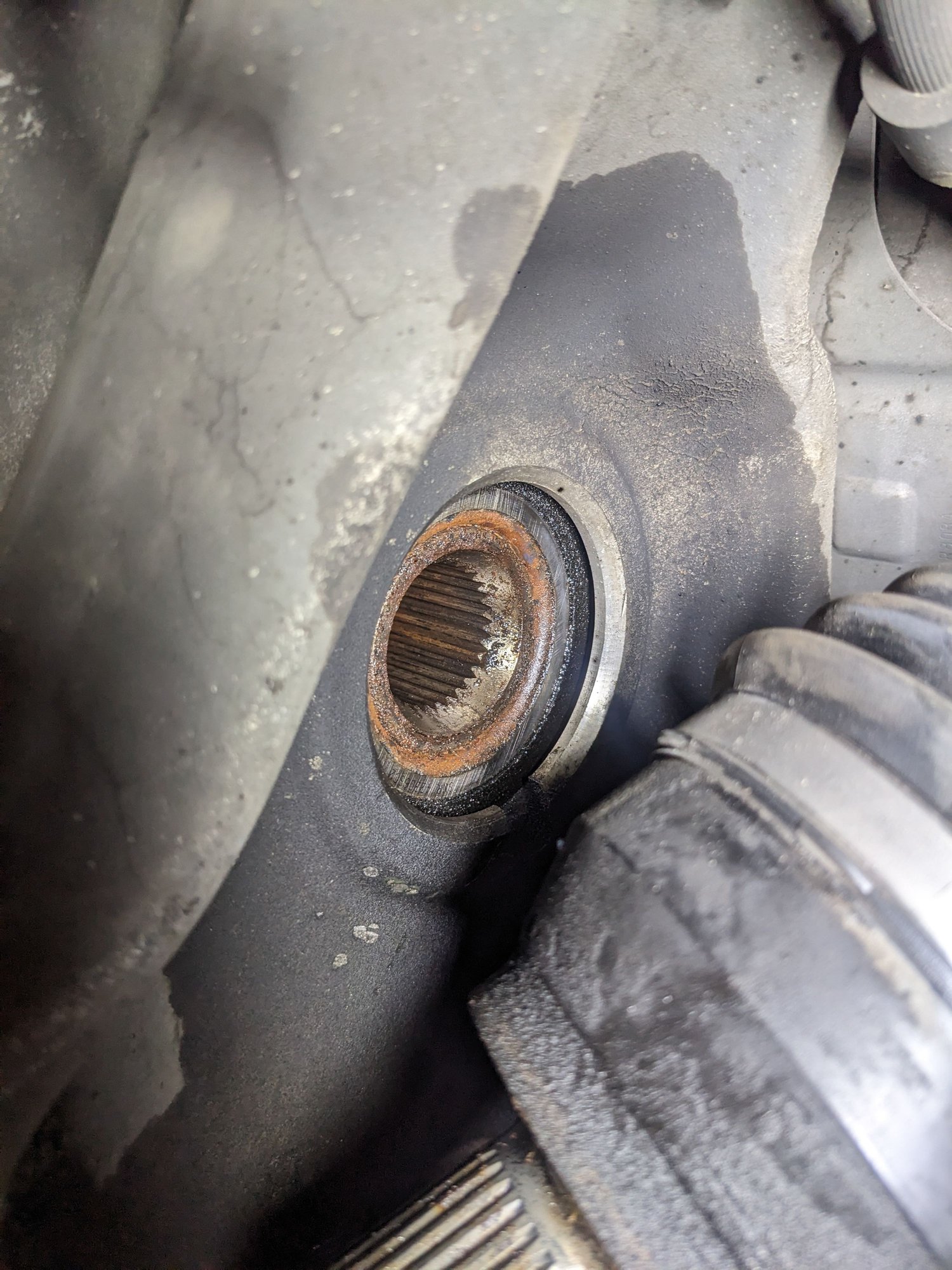

Started doing the front and rear lower control arms this weekend. Turned into a bigger job. Recommend using caution when removing the front lower, the baskside of the balljoint end is sharp. So sharp that it sliced the CV axle boot about a 1/16" causing grease to run out as I was removing the joint from the knuckle. I was not even being forceful. LR wanted to rinse me for $1200 after a core return for a new axle. I settled for the NAPA unit for $200. The knuckle side of the shaft was seized no amount of hammering would get it out; appears the face of the axle was rusted to the backside of the bearing. Other than that the control arm R&R is a fairly easy job.

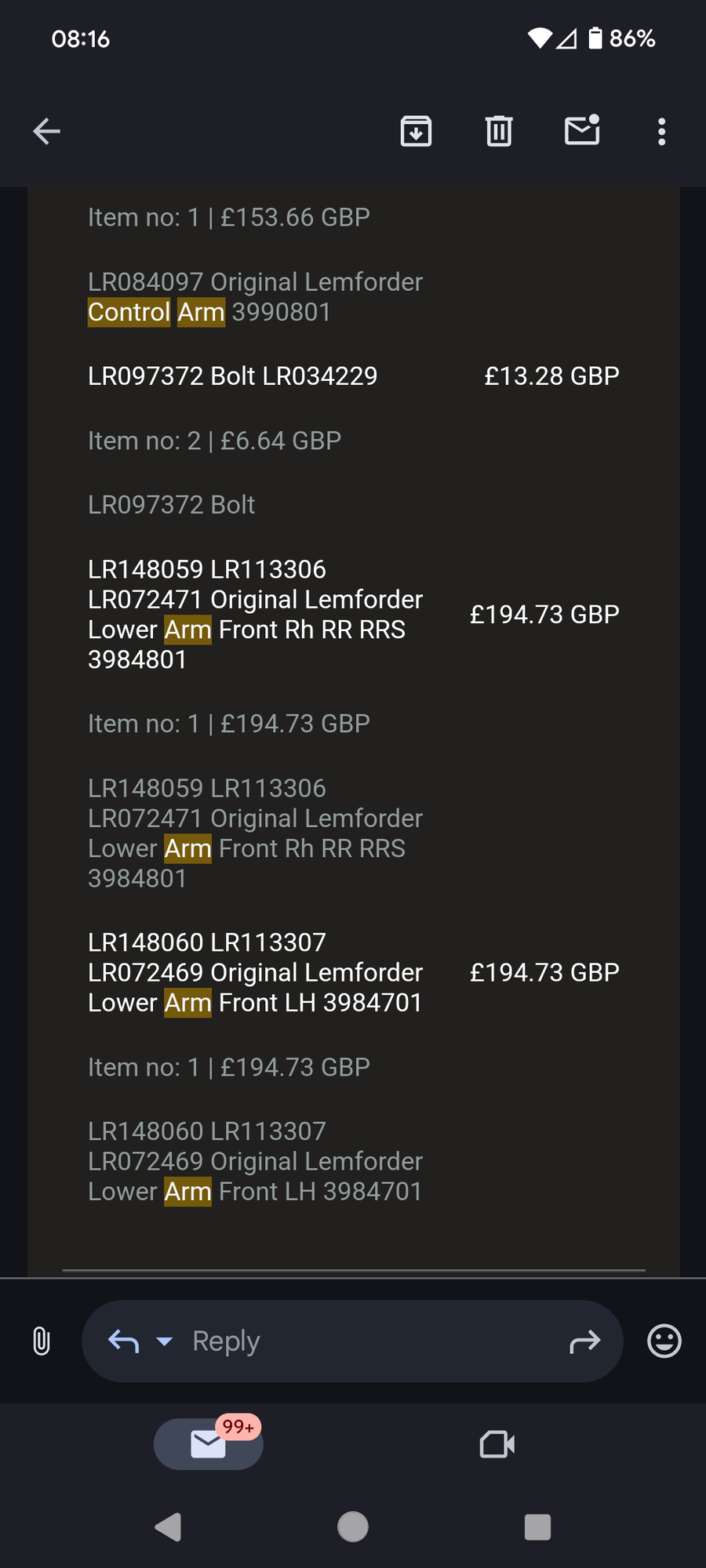

Received front forward and rear Lemforder control arms from Advanced Factors out of the UK. Fast shipping and slightly less cost than ordering domestic. I recommend. I'll be installing this weekend.
What are the part numbers for the Lemforder control arms?

Likes: 143

You shouldn't need a puller for this job. I tore a cv boot on accident and had to replace it. Nevertheless, I bought it from my local NAPA part number SER 2251

I bought an air chisel before I bought the puller lol. The chisel did not work.
