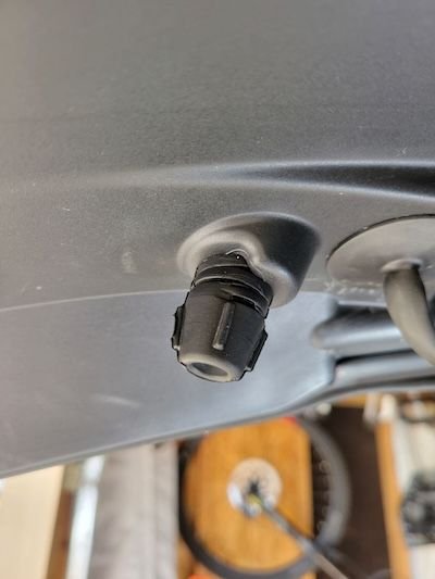

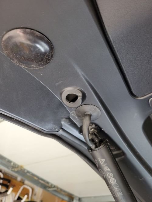

My bumpers are a single piece of rubber: half bumper, half thread. I turned the whole thing. If you start from a fully screwed-in position, it can be hard to get it going, I had to use gloves on mine.
I unscrewed it and took a few pictures so hopefully you can see if yours look similar. There's the bumper itself, and the hole in which it goes. When I screw it in, I can easily tell the offset by counting the number of threads/steps outside the hole. In my case, the bumper on one side was fully screwed in (no threads visible outside the hole) and the other was two steps out.
Bumper alone.
Bumper screwed less than half way into the hole.
The hole.

That's great, thank you. That picture really helps. I was expecting a machine screw thread not that giant corkscrew which is what you did call it.
I was unable to turn mine before but I will try again. I was afraid I'd break the rubber piece off.
