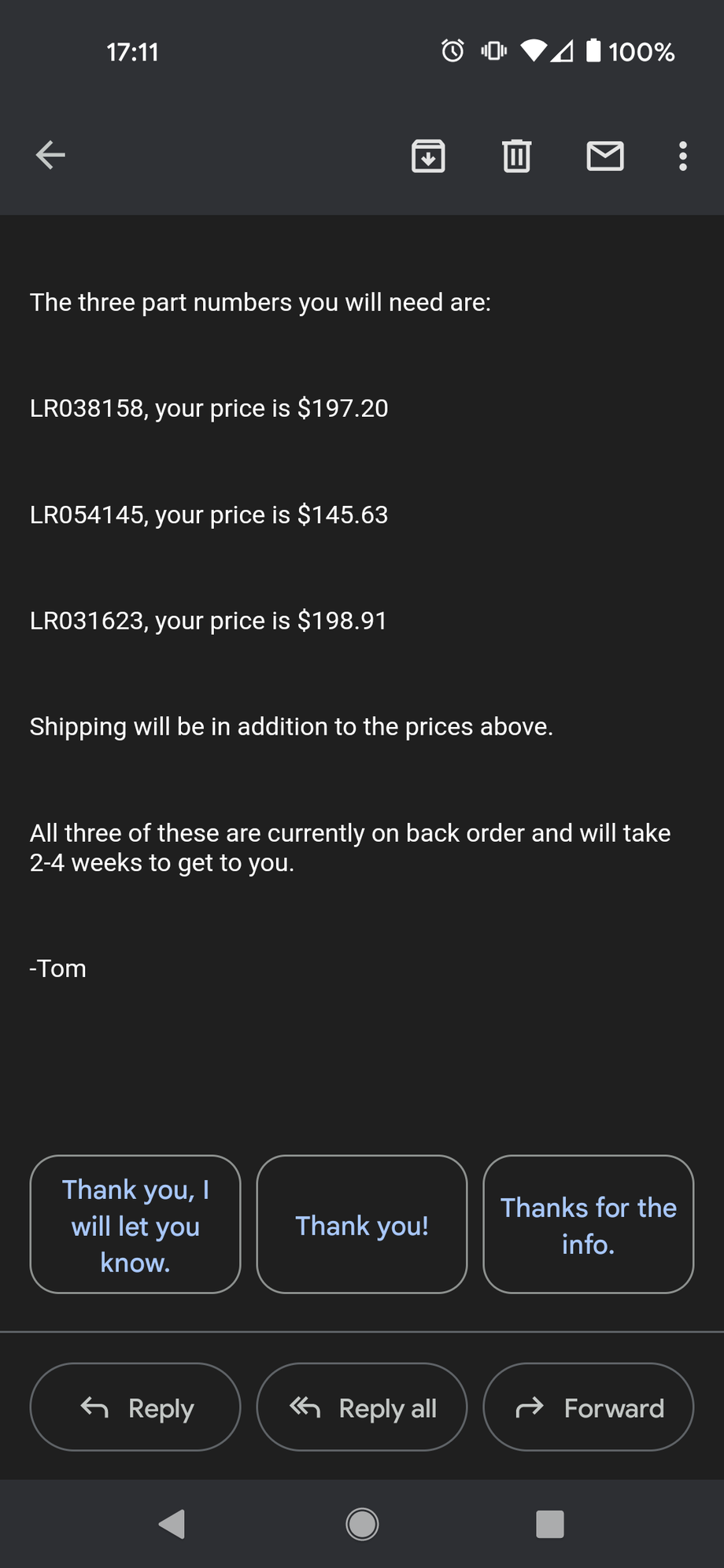

jaacina do you have pictures of the installation under the hood?
I asked landrovermerriam parts what numbers are required for the install on my 2017 and 2 of the 3 part numbers jaacina provided are the same and not including the hoses, so now I'm really confused.
Any other info on your install would be helpful.
