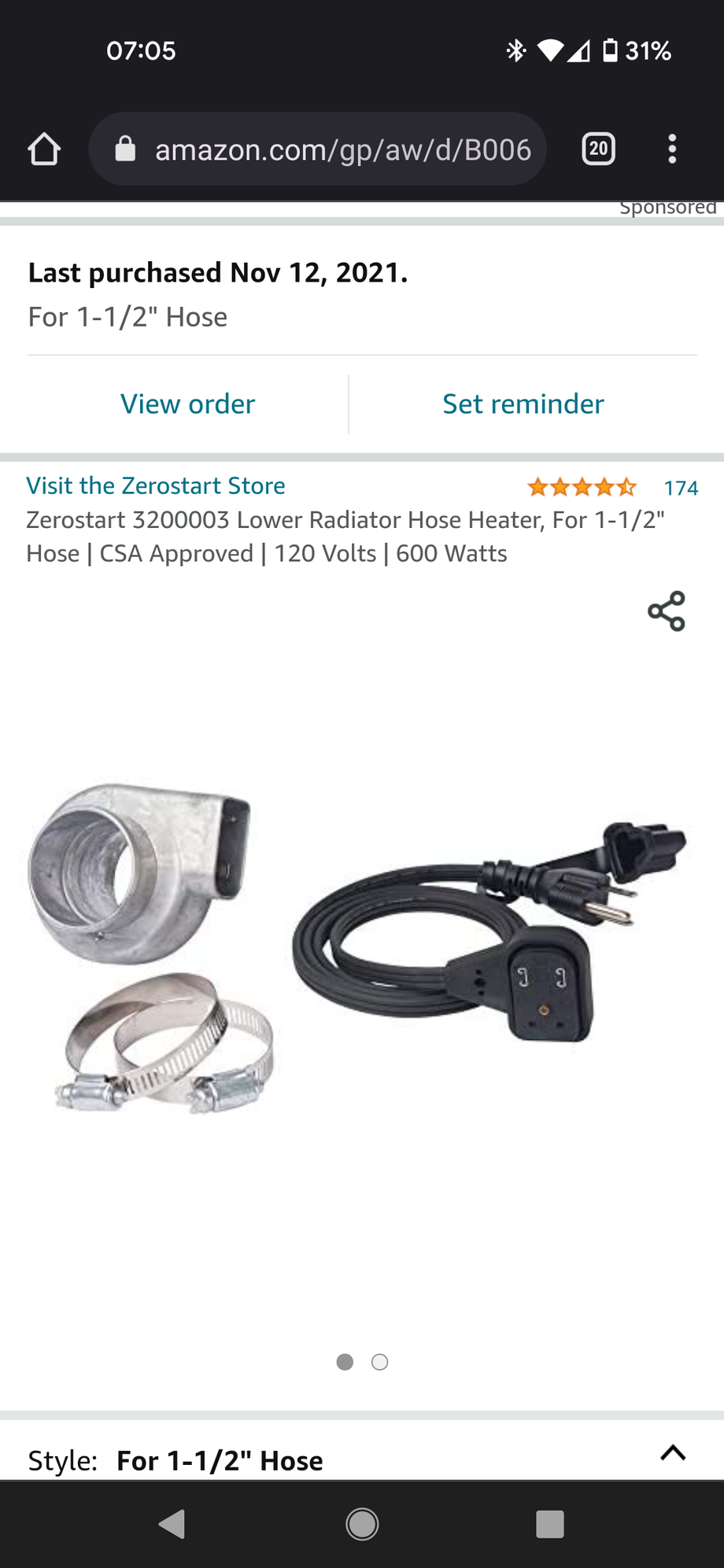

This is the original hose. I replaced it with the two hoses listed above with the heater in the middle. The hose is about 40MM diameter. If I knew what I know now I would be tempted to try something like a Zerostart 3200003 Lower Radiator Hose Heater. Cut that hose and stick in the middle.

I ended up going the cheap route with the Zerostart. Has overall good reviews. I do like LR's integration better though.
Thank you for the suggestion and all the info. I'll let the forum know how this works out. If it sucks I won't be too upset about the $40 investment.

Got the Zerostart installed this morning. Plan to use it on trip up to the mountains this week. The installation was pretty easy, but it was extremely tight fitting. Hose definitely had to stretch a bit to get it on. We'll see how it works this week.

Worked pretty good I think. Ambient temps were about 20F. Torque App coolant temp read 105 plugged in overnight. Didn't get any glow plug indication. Started easy.

I agree I've had the Zerostart on for 2 years with no issues. Performs well. I do like the integrated look with the LR parts though. And yeah I didn't lose much coolant.
