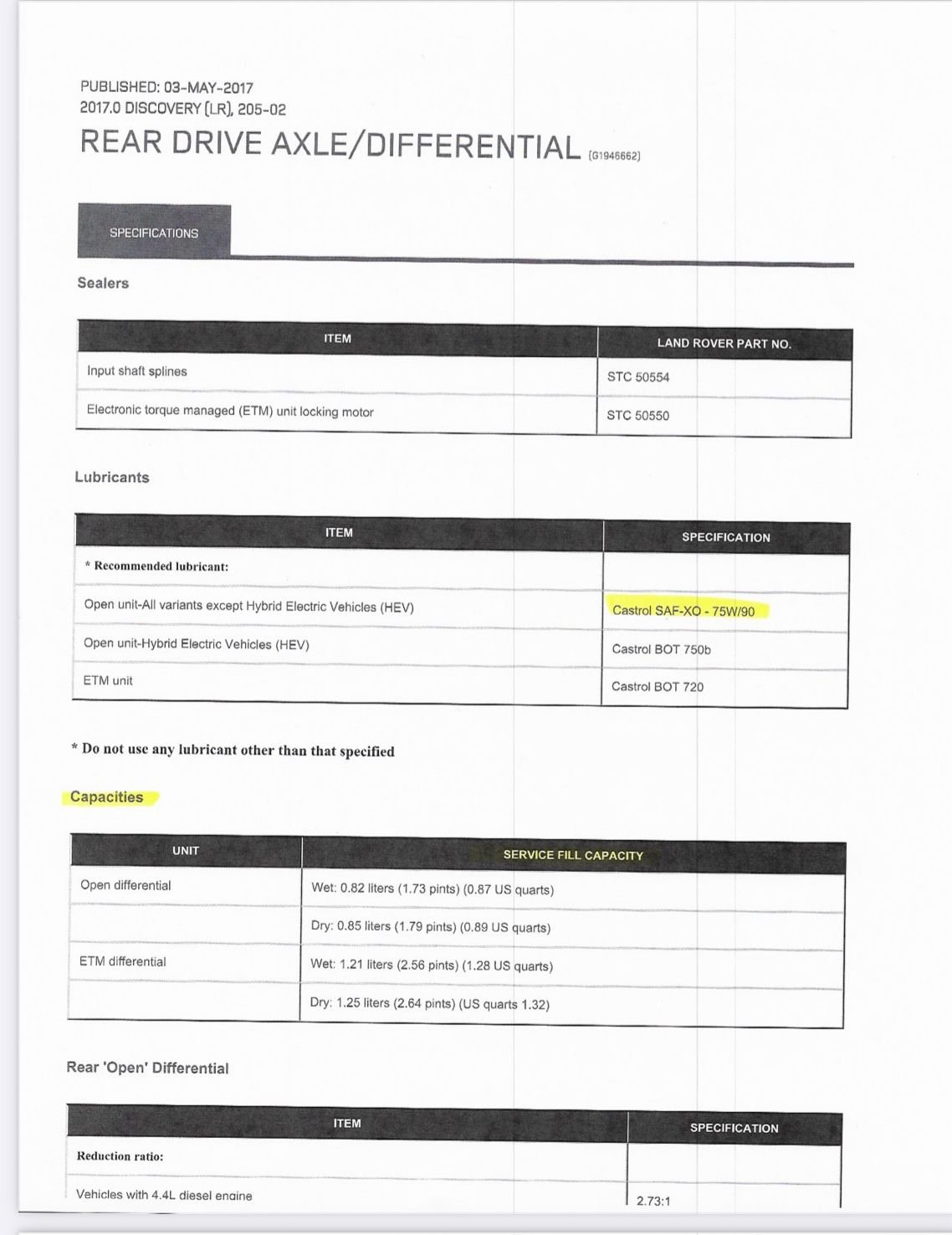

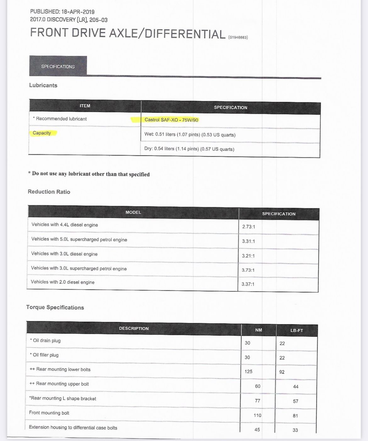

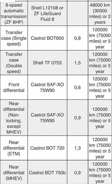

Fluid specs:
John Garcia
15
Mar 20, 2019 07:19 AM
kunz209
Sep 6, 2014 05:55 PM
flwoodsman78
Aug 2, 2014 06:49 PM
MeanSaleen
25
Aug 26, 2013 10:16 AM
safarisam
Jun 9, 2010 05:52 PM
