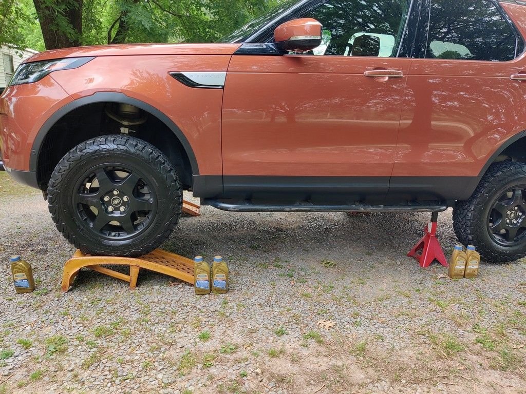

My rig hit 80K. So time to change diff and transfer case fluids.

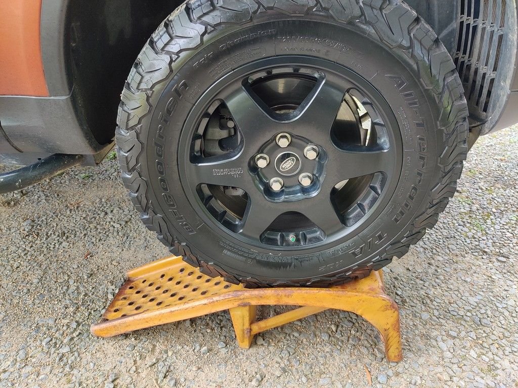

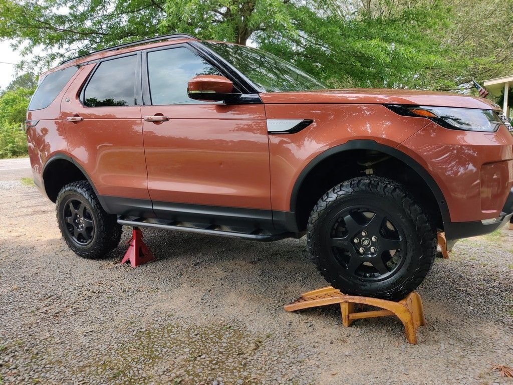

Leveled the old girl up. laid out the respected fluids in location.

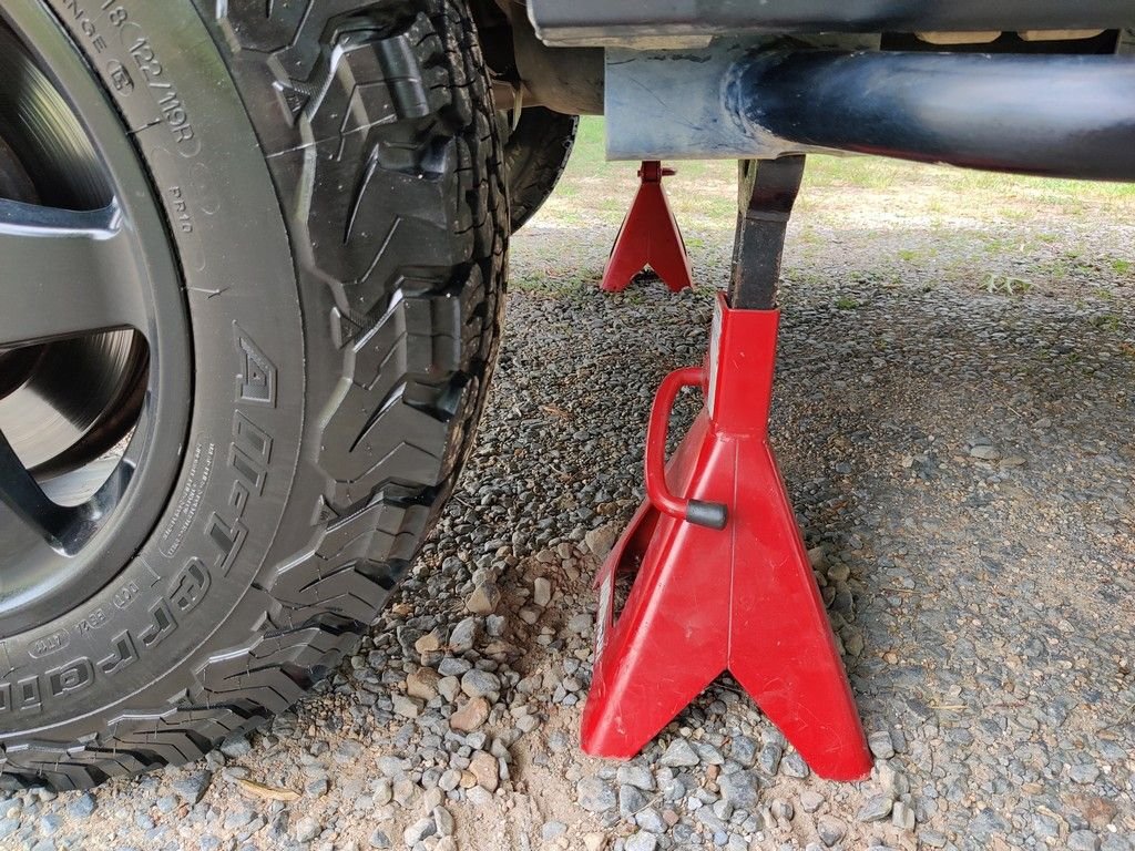

6 ton jack stands, not harbor freight. LOL

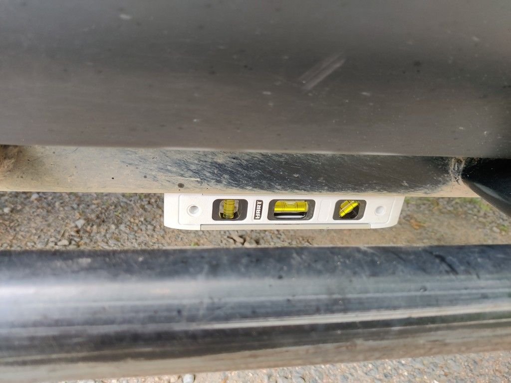

Level check

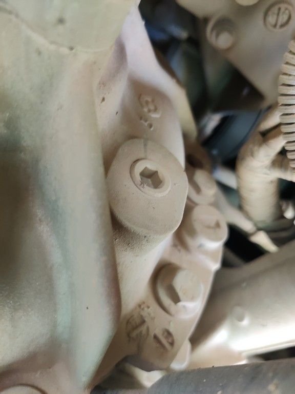

rear fill plug, 8mm allen

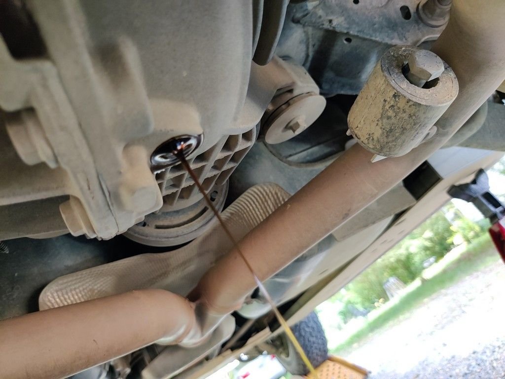

rear

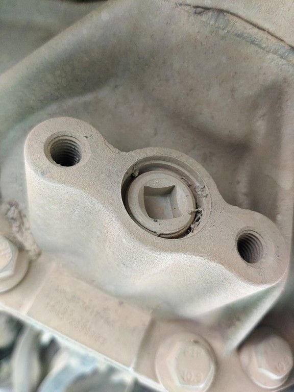

rear 3/8 square drive

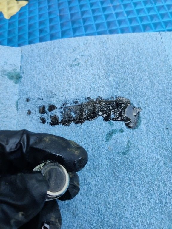

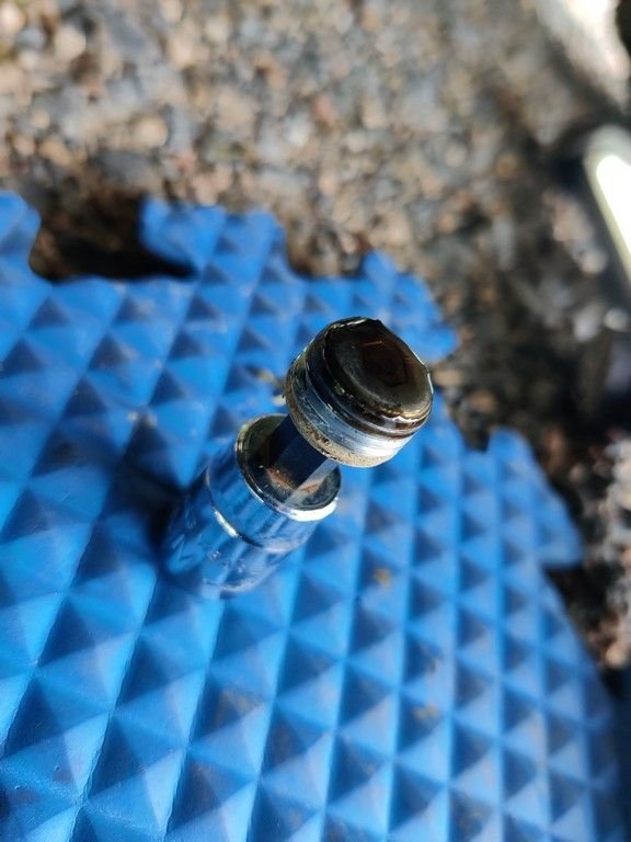

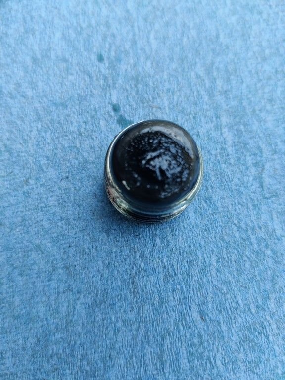

rear plug, little metal on magnet, pretty normal.
rear

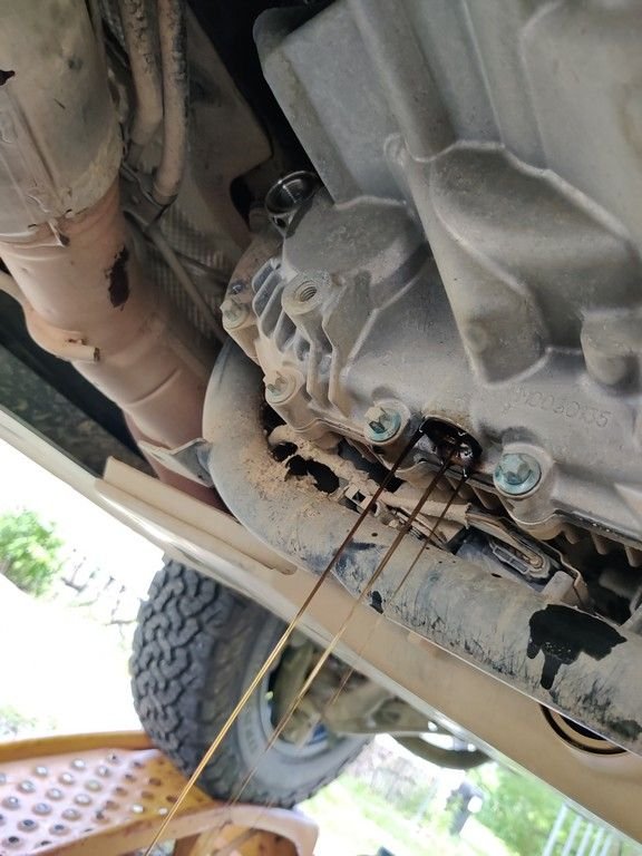

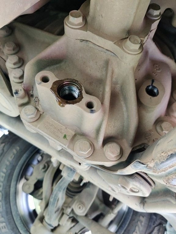

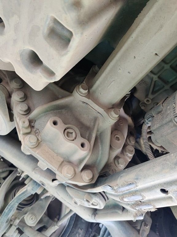

front diff

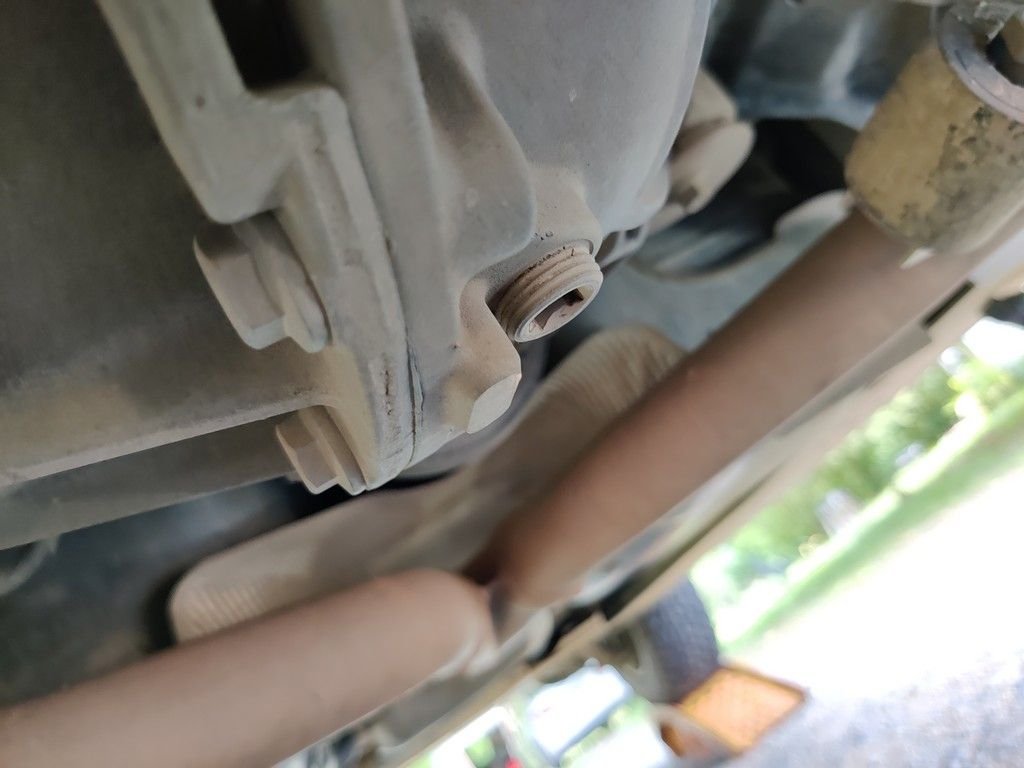

front 8mm hex plug also
front 3/8 square drive

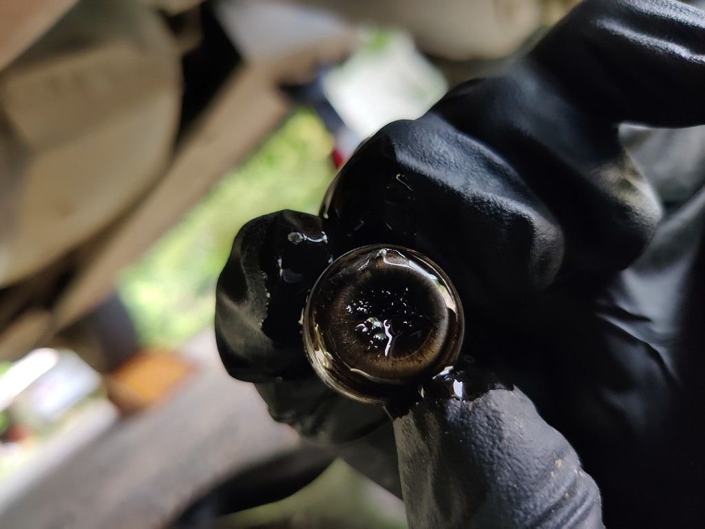

front plug
front plug, again normal amount of metal
front draining

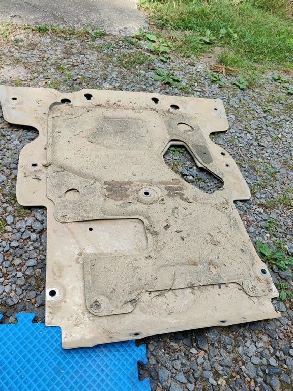

muddy shield shows no leaks

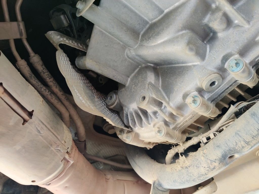

transfer case, you can see the small heat shield you need to remove.

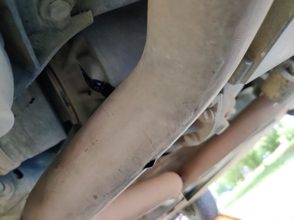

transfer case draining.

How difficult was it to get the underbody shield off?

Originally Posted by 1979rover
Great info and detail, thanks!
Not difficult at all. I remove it every oil change too. Personally, I like to inspect everything under there.

Note that you can check if vehicle is level using dashboard offroad display.
I realized that after the fact...lol....sometimes I'm just old school.
