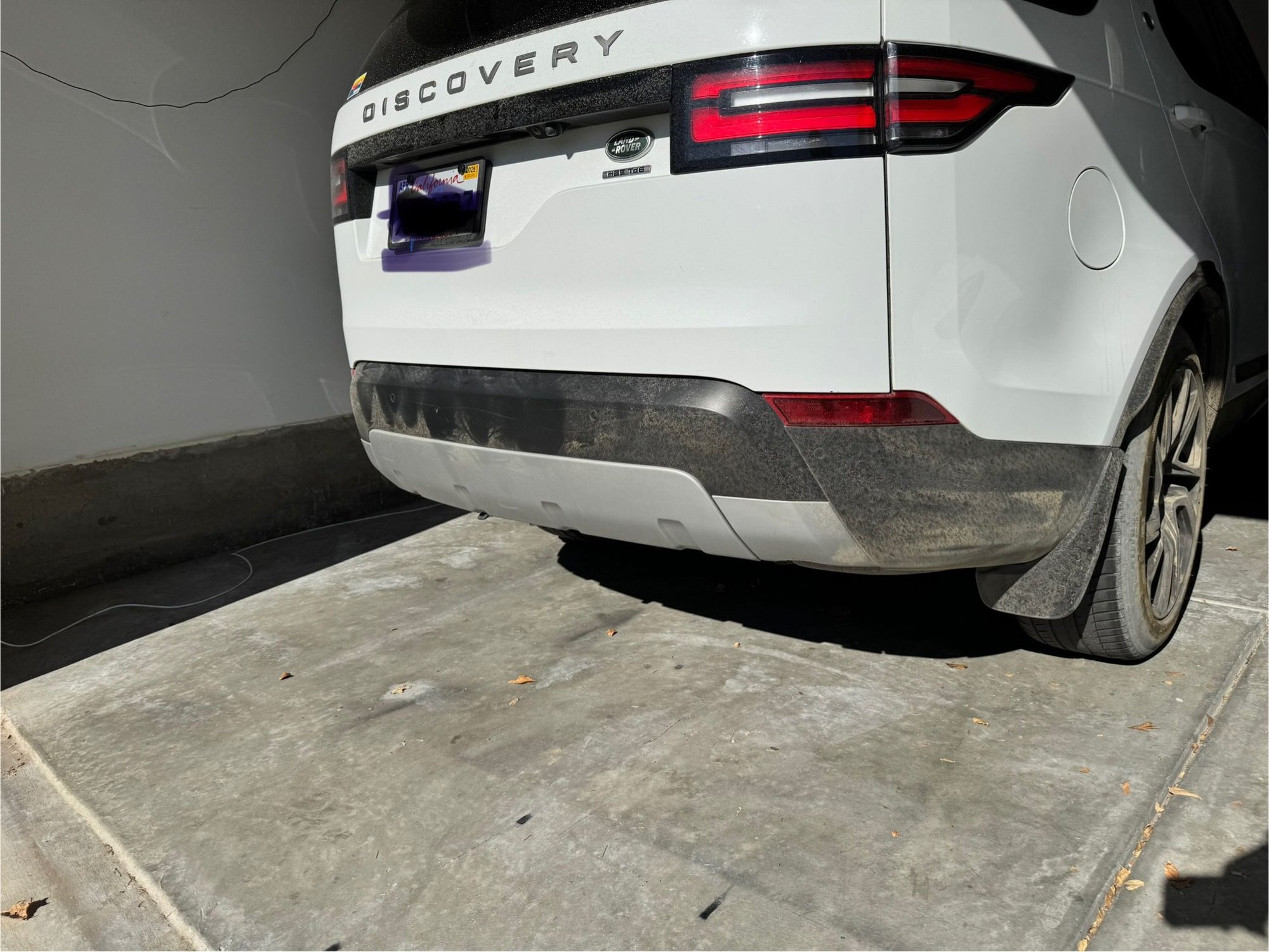

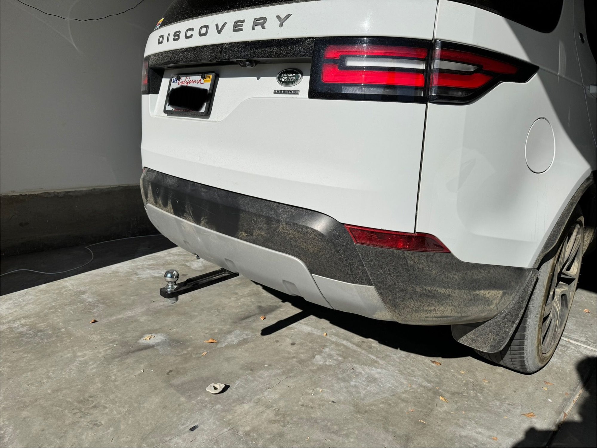

I have installed the stealth hitch on mine, only used it a couple of times so far for lite things but I’m happy with it.
Was able to Install it myself, takes a little trimming on bottom of the bumper and it replaces a large metal bar that’s inside the plastic bumper.
stealthhitches.com/products/land-rover-hitch-shr40001

@Jess- Thinking of going that route. Do you have any photos of it hidden and in use? Thanks!

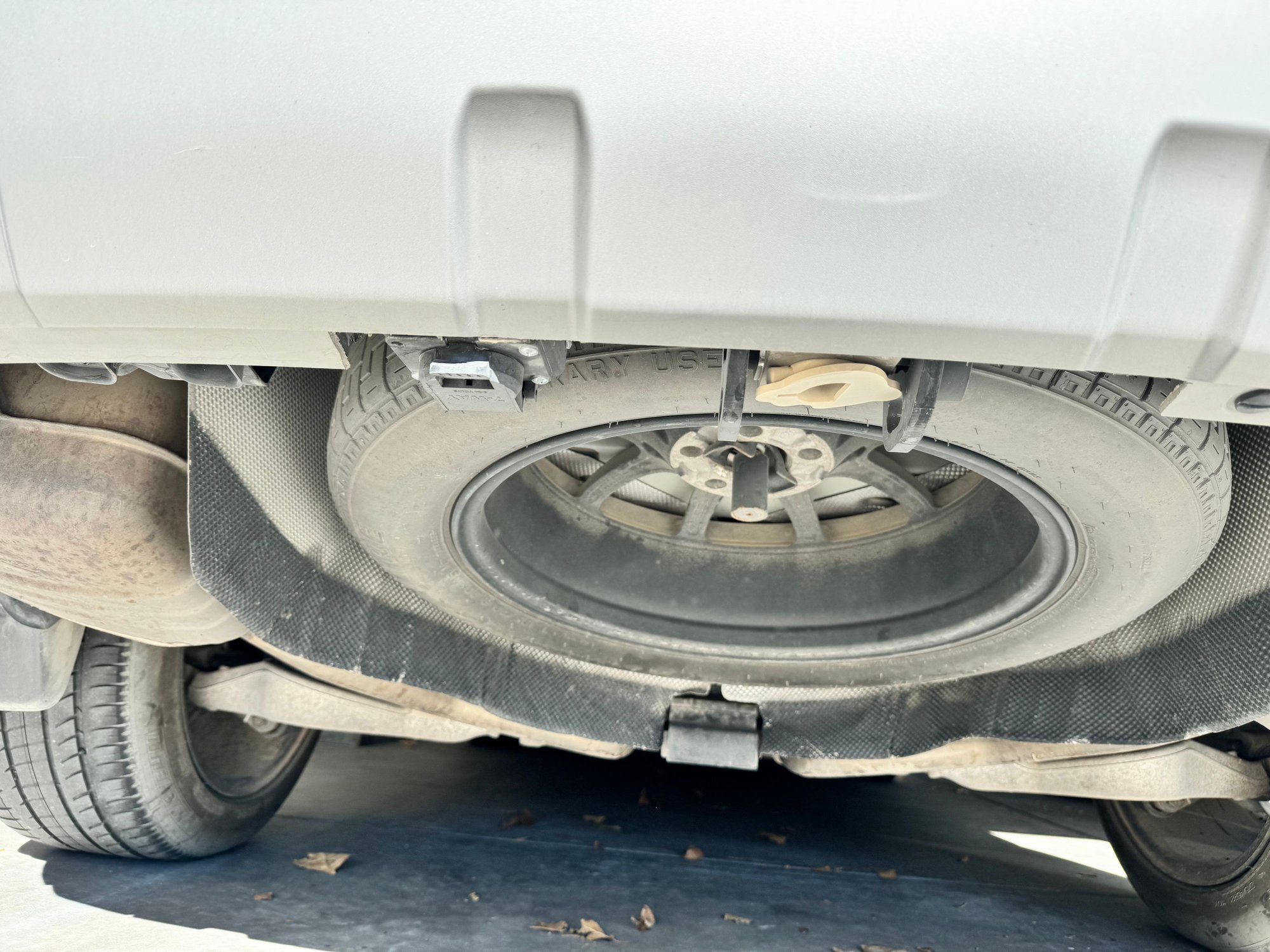

@mtaylo32
You can see the trimming on the underside of the bumper, it also makes a full size spare probably a tighter fit.
