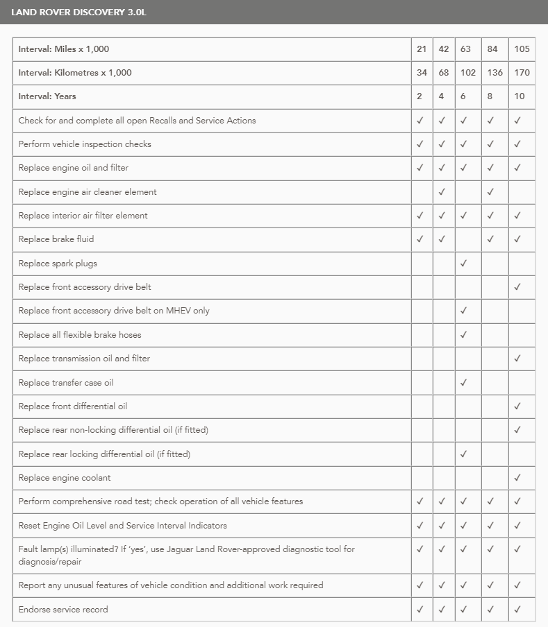

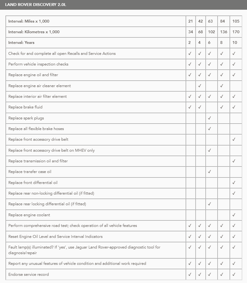

First off, you absolutely NEED to change the oil. JLR recommends every two years or 21k miles, but anyone who owns a car should be smart enough not to do it, even though synthetic oil technology has improved drastically even in the past five years. Waiting until 42k miles to change the oil is one of the worst things you can do. I would never go more than 10k miles between oil changes. Ideally you should do it every 5000-7500 miles. Historically, people who follow JLR's oil change intervals have serious issues, especially with timing chains on the old 5.0 V8 and supercharged V6 engines. The Ingenium engines (which is what is in your 2022 D5) have proven to be quite reliable, but they are still new enough that we don't fully know how well they will hold up in the long-run. Frequent oil changes are cheap and it will probably ensure you won't have serious issues down the road if you plan on keeping the car a long time. Also, check your passport to service, which can be found in the owner's manual. Not sure if you have the I4 or the I6, but I have attached the passport to service for both the P300 I4 and P360 I6 below.
