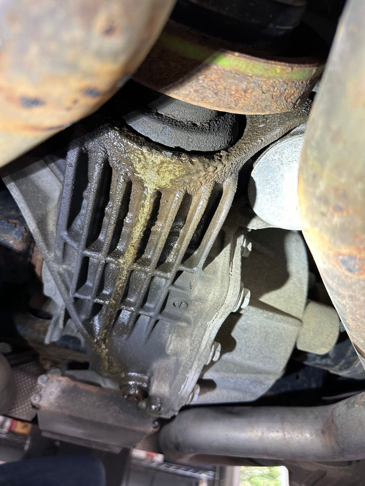

i have a 2019 Discovery5 with a leaking rear (locking) differential. it is leaking from the seal on the front of the unit where the prop shaft (drive shaft) connects to the differential. local dealer telling me there is no seal available for this unit so the entire unit must be replaced at cost of $3800 plus $1900 for labour. anyone have this problem or know of a better solution?

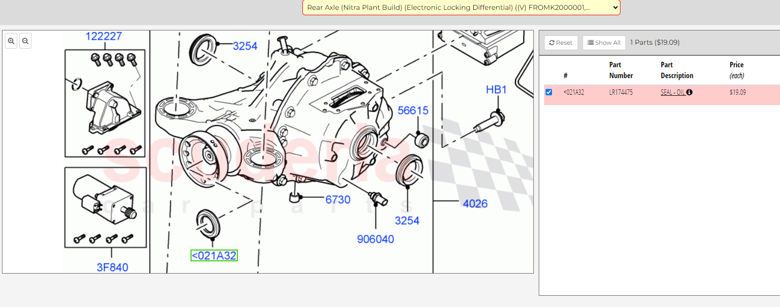

There is also a standalone seal for the locking diff.

thanks gmfain and Chucktastic with your help I convinced dealer that I did not need a new differential but only the seal LR174475.
Old Oct 12, 2024 | 08:36 AM
Chucktastic's Avatar
Joined: Jan 2023
Posts: 215
Likes: 156
From: Alpharetta, GA
Now you just have to hope they do the job right and set the pinion bearing pre-load correctly. You'll still have a decent labor bill since the rear exhaust and driveshaft have to come out, but a $20 part is definitely cheaper than a $3800 part.
